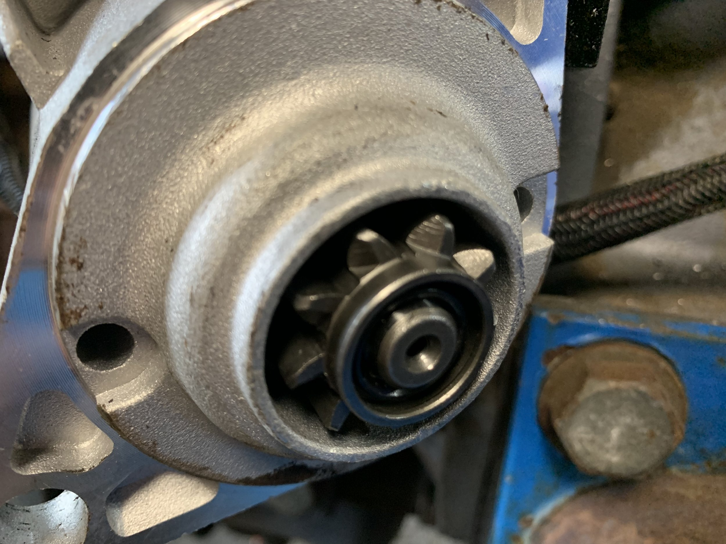

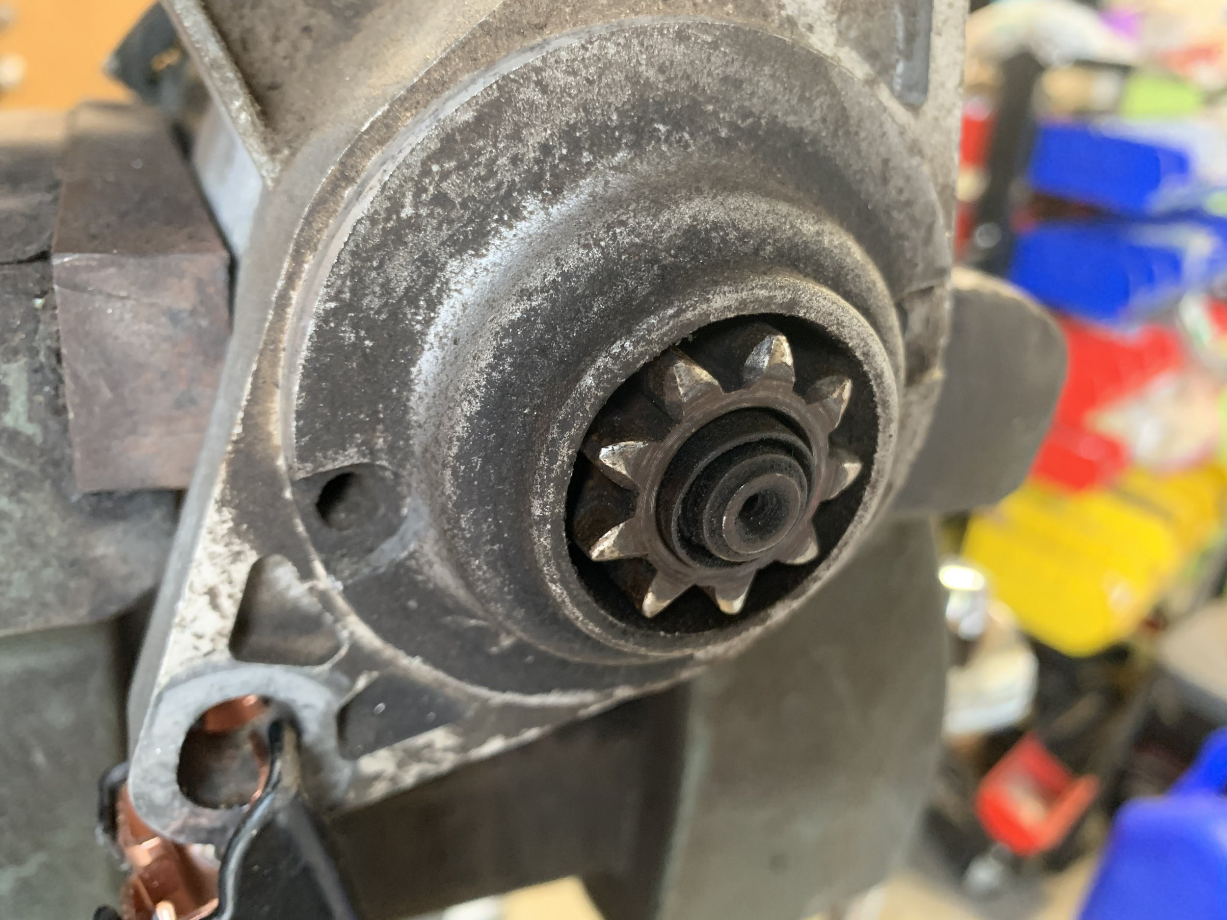

Tooth profile on the new one looks quite a bit different than the old one. Have you tried bolting back in the old starter and seeing if that works?
Those cuts in the teeth on new one were in the the old starter teeth too, they’ve just worn down quite a bit

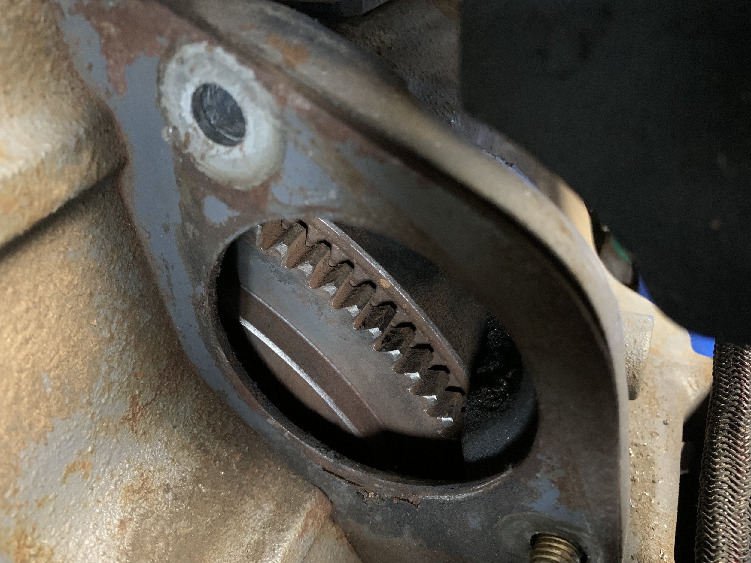

The wear pattern on the flywheel also shows that the bendix only engages about half the tooth.

"I even hooked up the battery directly to the starter and jumped it nothing works it’s as if somehow being mounted on the tractor is robbing power from the tractor."
Most times that is a problem with grounding or power cable. Take a jumper cable and go from the negative battery post to a good ground on the engine and positive to the post on the starter solenoid, does it improve the action of the starter?
Both cables were replaced last year. I used a jumper cable to connect bat - to the stater mounting bolt, which was up against the mounting body. I used a new bat cable from + to the solenoid mount and jumped the solenoid contact both from the solenoid battery cable mount and directly from the battery.
I have confirmed the bendix is NOT extending when montes on the tractor. I put a piece of tape on the ring gear and the bendix never touches it.
Somehow the starter is losing power only when physically connected to the tractor. I just had them both checked by a shop and they’re both good.
