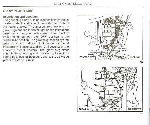

Again, this refers to Class III Boomers, but it may be helpful.
Attached, location of Glow Plug Timer.

I couldn't tell from the diagram if the relays were on the right or left but on the 03 33D they're behind the right kick panel (or knee banger as PineRidge put it).
ohmboy has a good suggestion to listen for the click, I sometime glance at the light but listen for the click more often than watch the light. If it's cutting out to quick, I would probably replace that before the ignition switch.

I had the same glow plug problem. I replaced the glow plug timer relay first, which did not solve the problem. Replacing the ignition switch did fix it.
