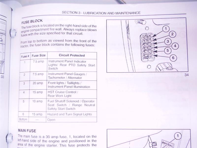

/ TC33D Will Not Start #3
Just looked at the schematics for mine and the hazard and turn signals use a 15 amp fuse. The safety switches use a 10 amp, it's fuse 5 in my book. If it was truly a 10 amp fuse blown then I'd suspect it is the safety switches fuse.
I got my manual and I'm still a little confused (see attached page 1, 2, 3). If you look at page 1 this is the one I was looking at, fuse #5 is the one which blew that I replaced. Looking at page 3 it indicates #5 to be a 7.5amp fuse, it was a 10amp that I replaced. Page 2 is titled the Safety Starting System and seeing the 7.5amp fuse confused me. Maybe its because the sheets are all cut onto separate pages. I think I'll photo copy and tape all together trying to connect all the lines. Something still doesn't match up with the number 5 fuse on page 1 and 3. Tom thanks for your offer to fax me your paperwork, if I have more problems I'll be in touch, I think I'm fine for now. Tim

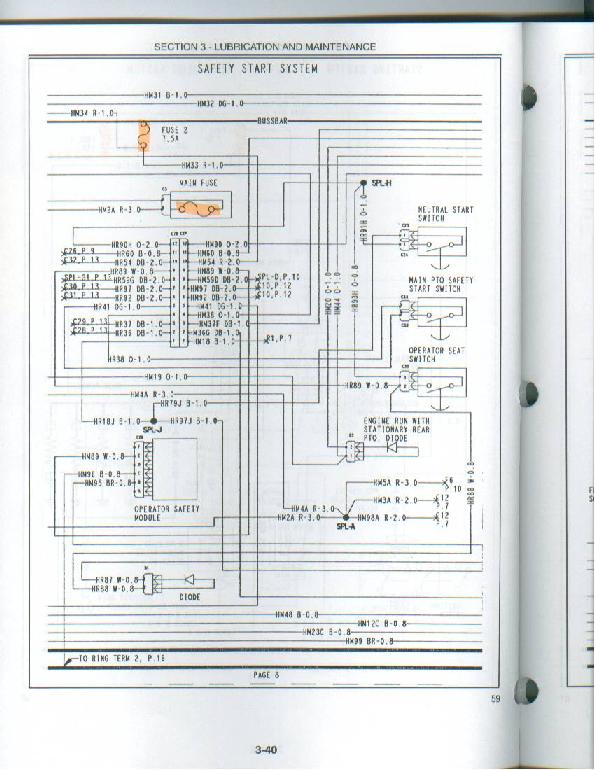

/ TC33D Will Not Start #10
Looks like you got a wrong manual. Following is the same pages in my manual.

/ TC33D Will Not Start #11
Here's page 3-40.

/ TC33D Will Not Start #12
Here's page 3-42.
My manual is version 10/02. You might want to get your dealer to give you the correct manual for your machine.

/ TC33D Will Not Start #13
Originally, when the dark gray bodied tractors were introduced, fuse 5 was a 7.5 amp fuse. This was changed to a 10 amp fuse because of the problem you are having. In some circumstances this was not a total fix. The latest is to install a 10 amp circuit breaker, which you can get at NAPA or other parts store. The breaker will fit into the fuse holder like a fuse. The breaker will come with contacts that can broken off at preset lengths so it will fit in the place of the fuse.
As for the wiring diagrams, the early books for the dark gray tractors had several errors. All the diagrams posted are for the dark gray tractors, just different issue dates.
