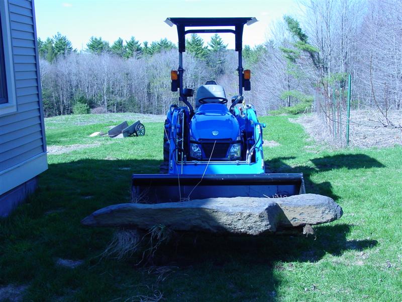

FYI. I am in the process of building some stone retaining walls. I am lucky enough that I am getting LOTS of stone (ledge but what the heck) for free. Just quickly calculated an average piece to be around 3.5'x3.5'x14" large, so my best guess is around 1000lbs (1/2 ton). Do you think a "little" 34DA would have problems moving those and placing them? I have 3/4 yard bucket excavator scheduled to place the stones, but do you think the 34DA could handle it? My guess is no. Do you guys want a pix or 2 to see what I am talking about?

You should not have any problems with those rocks. The rock I am "walking" in the picture is 6.7'X1.5'X.8'. Assuming that this basalt rock is 188 pounds per cubic foot. I was carrying over 1500 pounds of rock with my
"29". Jay

I don't think you will have a problem if you keep it low. The buckets are pretty much sized to the lift capacity of the tractor. Also - keeping the bucket low will increase the lift capacity over what's spec'd at carry and max lift heights and give you more stability. I've been carrying overfilled buckets of stone for the last several weekends without any problem (I keep it as low as practical). Just go slow and make sure that you are wearing your seat belt (i.e. don't take any chances).
