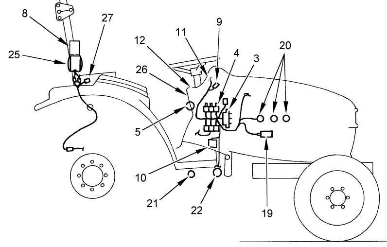

Max, I'm afraid what you've found is not fuses. Have you checked the fuses on the front of the right-side firewall? In the first attachment, the fuses are at location #3. The second attachment shows the fuse cover removed. That first fuse at the top should be checked. You have to pull them out and look from the side to see if they are blown.
I don't mean to oversimplify, but since you were referring to the relays as fuses, I want to make sure you know how to check fuses.

   / TC34DA Won't Start... Any ideas?
#24
Guys,
Thank you again for the help. Bob, I'll look at that page you reccomended and Jinman, thank you for the pictures, they are good ones and I'm going to print them and keep them for referance. That was the first thing that I looked at were the fuses at the fire wall. I'll double check them again, but I'm pretty sure that they are all okay looking. I also checked the 30amp going to the starter and that one looked okay too. It'll be interesting what my dealer says. I'm really out of ideas here..
