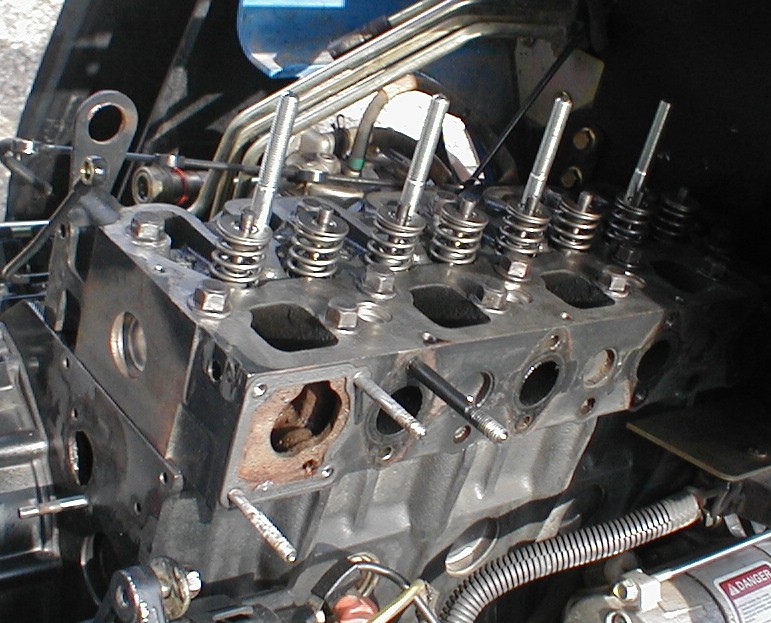

The proper head gasket arrived this morning it is ~3 times thicker than
the first one ordered. Ooopppssie, glad I didn't mess that one up... ;)
Forgot to take picture prior to installing the head. To the picture ******
my apologies. Again no gasket sealant(s) used. But I did use anti-seize
on the head bolts, I use anti-seize on just about every fastener there is.
I spent too much of my time in the Navy dealing with salt water corrosion.
The only thing so far I did not anti-seize were the conn rod bolts, but
they were lubricated with engine oil prior to assy. As was the whole of
the piston prior to installation.
Also spun the crank and everything moved smoothly with no bangs, knock
or whines. Always a good thing I could not spin the crank by hand before
removing the bad rod. Also the engine pulley nut is 36mm.
I have included the service manuals two pages that cover head gasket
selection for the TC35, TC40 and TC45 models, and the head install
procedure.

Great details, some new head gaskets are self-sealing.It was 3 times thicker? I always use assembly lube on the bearings so I can spin it over by hand. This prevents problems later.No antiseaze on the rods, but sometimes I peen the end of the bolt, it depends on the manual. Hope it fires up on first try...Anything special about speed when it first starts up? Jy.

three times thicker than the wrong head gasket. About the same as the original, SWMBO was nice and took my shop garbage out earlier this week and I did not have the old gasket as reference. ;) Read Ref 11 I had a head gasket for the TC45 engine, same outline but much thinner.

But I did use anti-seize on the head bolts,
Was that a wise thing to do? I understand why you did it I use Never seize on most everything too but what do the torque specs say, dry or lubed.
Not pickin', just inquiring :)....Mike
   / TC40DA: Oil change nightmare.
#48
shade tree welder, I have a 2002 TC40S and there is no mention/caution of this in my operator's manual. I do see in your Ref 02 Service Bulletin with the date of "0606" so I beleive this emission control change/fiasco took place much later than my tractor's birth date. There are however references to the TC40-A so all of you "A" series owners-take heed of what stw had to go through. Thank you for the cautionary post and I hope this turns well for you and your tractor.
Nickel, does your tractor have an external valve cover breather?
Does not state dry or lubed, but I have had to dick around with too many
broken bolts in my life not to anti-sieze everything I can and that makes
sense to. Also I know that debate always going on about torque value of lubed
and dry bolts, etc. etc. Torque vs. actual bolt stretch is only a good guess
and can be effected by soooooooo mmmmaaaaannnnnyyyyy other variables
such as type of finish on the bolts (black oxide, chromate, zinc, cadmium,
etc.) surface finish of the bolt, surface finish of the mating part, material of
the mating surface (aluminum, cast iron, steel) corrosion condition of the
mating parts, machined thread fit, you can go on and on. I lube them, I torque
them, on the high end if given a range, and I move on. I have never sheared
a bolt or had an equipment related failure.
