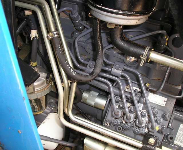

Nice work STW.:thumbsup: I'm sure you are a lot braver than I at doing this job yourself. It appears you've hit a home run. Your advice for clearing the problem is very good. Pull the glowplugs and pull the fuel C/O solenoid and crank until all oil is cleared from the cylinders.
In looking at your picture of the fuel C/O solenoid, I could not help but see your fuel inside the filter. That really got my attention because your fuel looks murky instead of very clear with only a slight yellow tint like the diesel we buy here. I'm including a picture (not too good) of my solenoid and fuel filter. I think you can see the difference. Is your filter bowl cloudy, or is that your fuel?

Jinman, is that your original fuel bowl? My Case came with a milky plastic bowl which is terrible for trouble shooting. Yours looks like glass it's so clear!
   / TC40DA: Oil change nightmare. #64
Yep, it's the original and very clear. I can easily see the yellow tint of the fuel looking into it and even check out the condition of the filter. The bowl is plastic as I remember. BTW: Our diesel here is so good and clean that I think I've only changed that filter twice in 1700 hours.:eek: I once put 125,000 miles on my truck's fuel filter/water separator and it looked new when I changed it out. I think other areas of the country have additives to the diesel and containment problems we don't have. I have never had the least bit of problems with clean diesel or fuel jelling. It must be regional.
