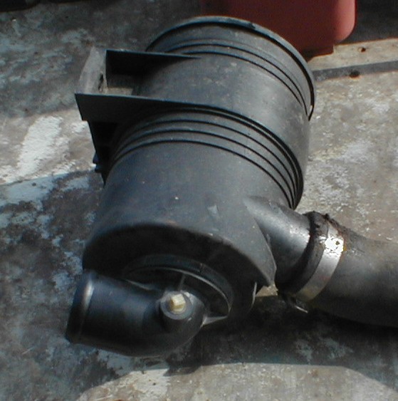

#56
Nothing really I guess, morbid curiosity. ;)
I was reassembling the air cleaner today and noticed a plug in the housing likely
intended for a breather hose connection. I'll post a picture later of it.
Here is the picture. The plug I was speaking of is the white fitting in the
elbow at the bottom of the photo. If you wanted to you could modifiy the
intake manifold valve cover casting to vent to this and not to the intake
manifold side. It would be cheaper than a new timing gear cover which is
$372. But I want to stay with stock parts.

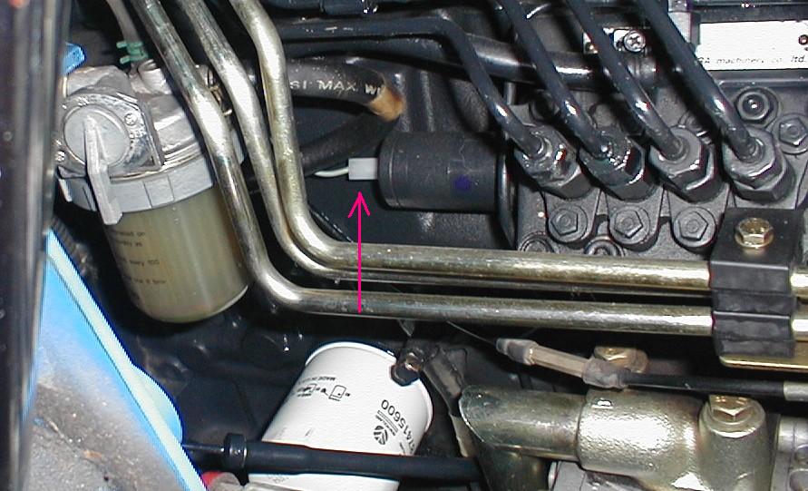

One last thought I would like to share on this topic. Attached is the picture
of the fuel shut off solenoid, the red arrow points to the electrical connection
for the solenoid. I will get to that later.
I believe that my bent rod was caused by not only some of the oil being filled
draining into the intake manifold and the intake valve being open. In
addition, I believe that the piston was near the top of the intake stroke
allowing nearly a full charge of air less the oil that filled into the cylinder. So
that when the valve closed and compressed the air into the pre-combustion
chamber along with some oil, that when the injector fired there was sufficient
compression to fire and with the additional oil and higher than normal
compression this resulted in unexpectedly high pressure. And since the
injectors fire at 20ー BTDC the piston tried to complete cycle and then bent
the rod.
So what can be done to prevent this especially if you believe you might have
overfilled the valve cover and got oil into the intake manifold?
I do not think that the starter alone would have enough power to bend a rod
even if the cylinder was full of oil, it would just stop the rotation of the crank.
I would suggest prior to starting your engine pull the wire off the fuel shut off
solenoid. The red arrow point to the connector grab the connector and pull
straight back toward the rear of the tractor. Disconnecting this wire will
prevent any fuel being injected into the cylinders and if you do have oil in the
cylinders you will just hydraulic lock the engine, likely with no damage to the
engine. Now you only have to get the oil out of the cylinders. If the engine
cranks over normally then reattach the fuel shut off solenoid and fire the
engine.
If you do have oil in the cylinders then remove the glow plugs and crank the
engine, if needed use nonflammable brake parts cleaner to thin the oil and aid
in cleaning out the effected cylinders. Replace the glow plugs, replace the
solenoid wire and restart the engine.
