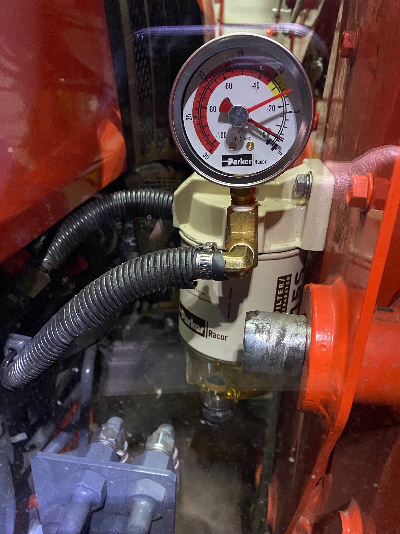

I don’t think it’s currently happening. I purchased the tractor in 2022. I think a water separator like on a Racor type is a good thing since now I am using a 55 gal drum for diesel.
My drum has a Racor filter on it that filters the fuel before it goes into my equipment tanks.
I have always liked having a pre-filter to keep the primary filter cleaner. On my last diesel truck I had a Racor 30 micron pre-filter and it worked great, so I would like to replicate that basic setup.
   / TC45DA Fuel Tank Outlet #18
I replaced the sediment bowl pre filter on my Kubota a few years ago with a Racor 215 series... It's been great.
I run 2 micron filters in it, and they generally need replacing every 100 hours which isn't too bad. I could always use the available 10 or 30u filters that would be more typical for a pre filter, but I got a good deal on the 2u filters in bulk.
