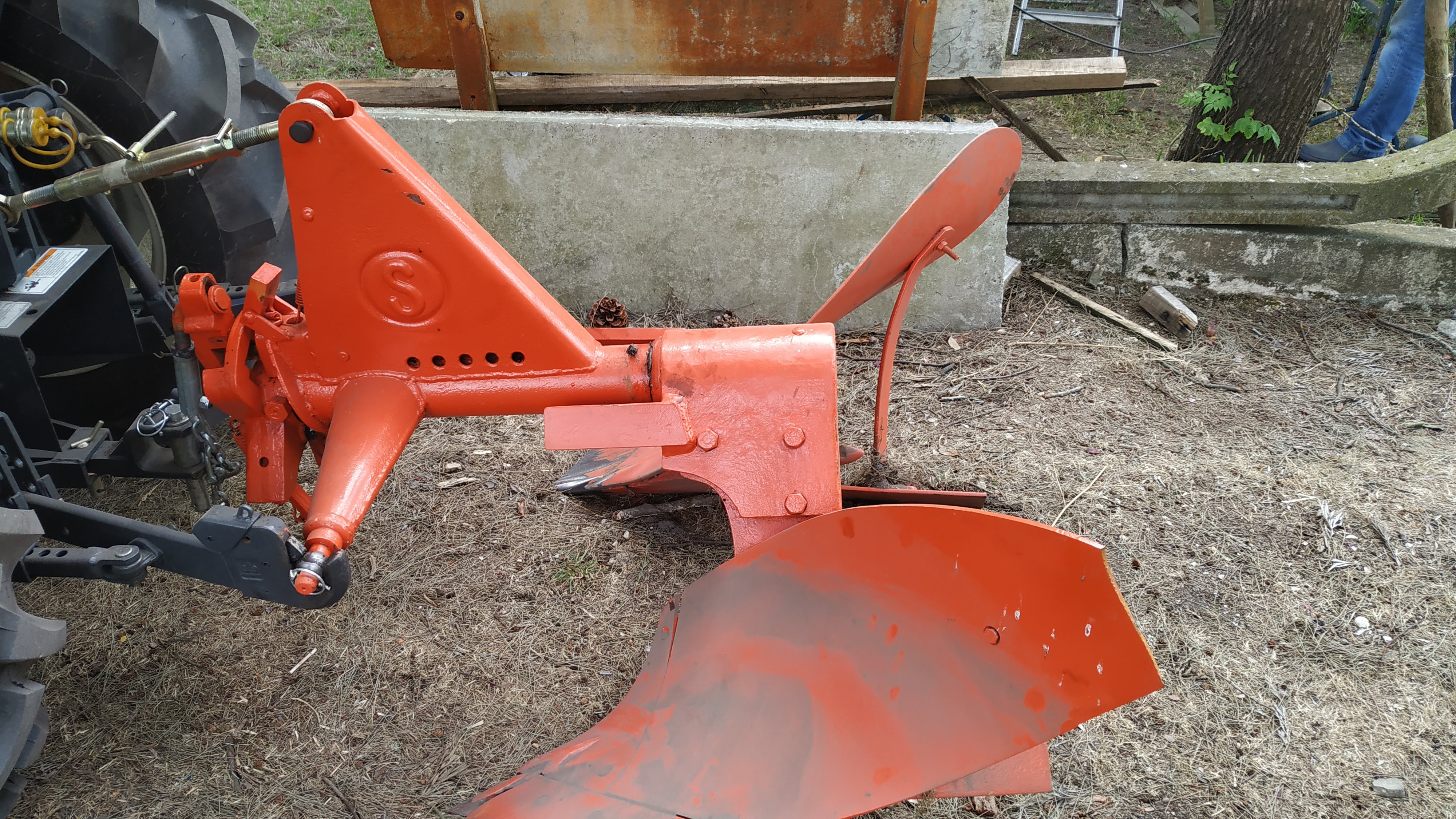

Although I don't have Pat's, I have what most likely Pat's is based on. The standard European Quick hook style:
In my opinion, this style is much stronger than the Pat's one, plus it's already welded on the lift arms, so no extra length there. The ball allows for more freedom of movement to prevent binding on any height position and allows you to offset the implement to one side or the other if it really needs. It will also self latch once the ball gets in.
Now, this style of hook won't need telescoping arms but it will surely benefit from telescopic stabilizers as it prevents the arm from moving around when trying to hook up to an implement.
Why not get the arms that Kioti has and uses everywhere else in the world, xcept N. America, with the claws already in them? I'm sure the dealer can get them for you.
You may be able to sell the current ones and the new ones may not be all that much more than Pat's with all the bells & whistles. I like Pat's, but the added 4 or 6" can be a problem as you may have to also change the PTO shaft.
I believe that Kioti has the Euro styl QH hooks as an option. They simply replace the extendable link slide in part with a slide in hook. :cool:
The balls that the Euro hitch connect on are typically left in place on each implement. ;)
Top link QH also pictured.
This style of hitch is similar but better then the Pat's,
If people could see and use them it would end many of the quick hitch / Pats discussions.
They are quick and easy to hitch up,
I back into my implement and depending on how square I am I may get out and use my external
3 pt lift control or many times I will back in and if not perfectly square I'll raise my lift arms so the hook
part is just below the ball and then back up a bit more to line up the other side raise the lift arm,
get out and latch the balls in raise any implement jack connect the top link and go.
