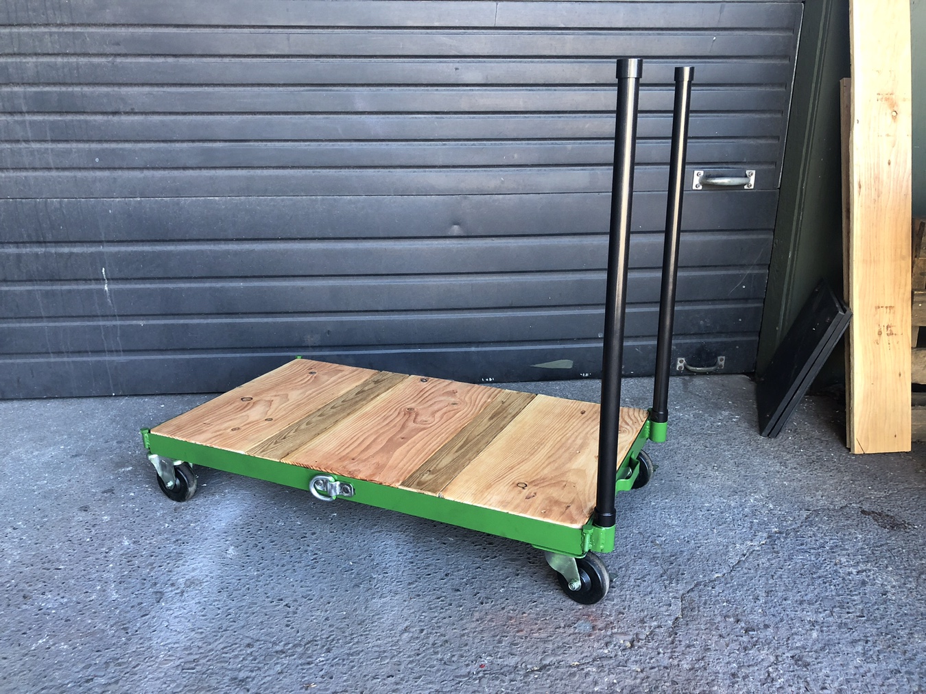

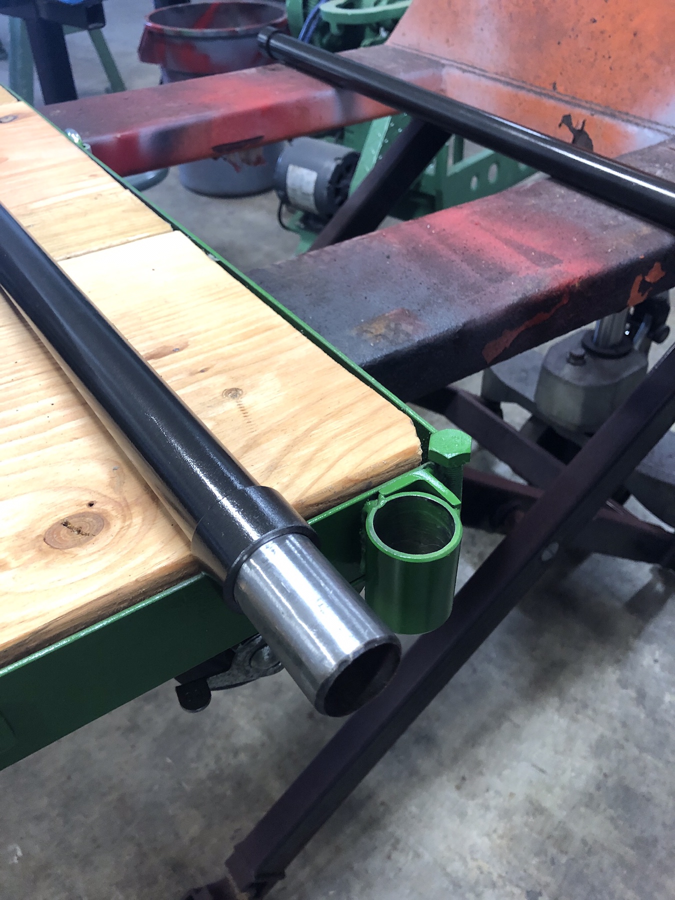

For a good telescoping fit I use DOM (drawn over mandrel) tubing which has the inside flash weld removed. Typically the inside diameter of the larger tube would be .010”larger than the outside diameter of the smaller tube for a nice sliding fit.
Here is an example of DOM tube I used for removable handles on a cart I made.
Edit: 3Ts gave same suggestion while I was typing.
