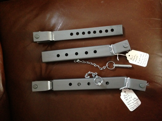

I received my telescoping stabilizers for my BX25 from Mark Hodge today. They are really nice and are going to make 3 point hitch maneuvers a bit easier. The quality is outstanding. Mark is a frequent contributor of his wisdom and experience to this forum. (http://www.stabilworks.com/) Thanks Mark!

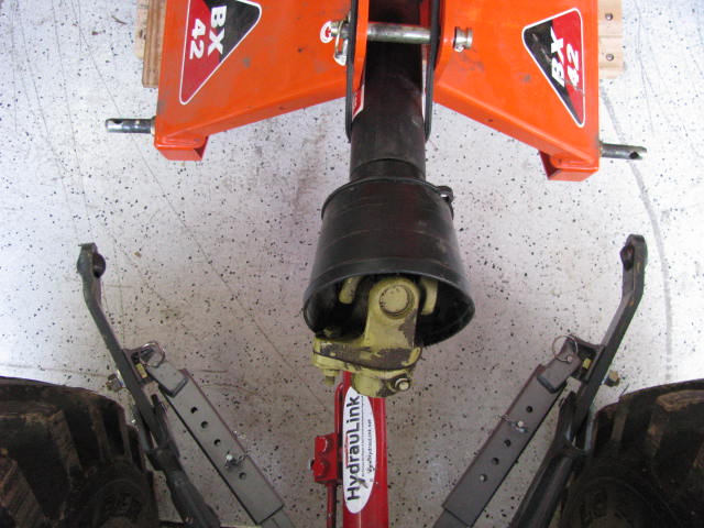

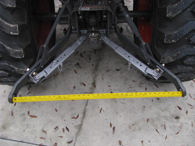

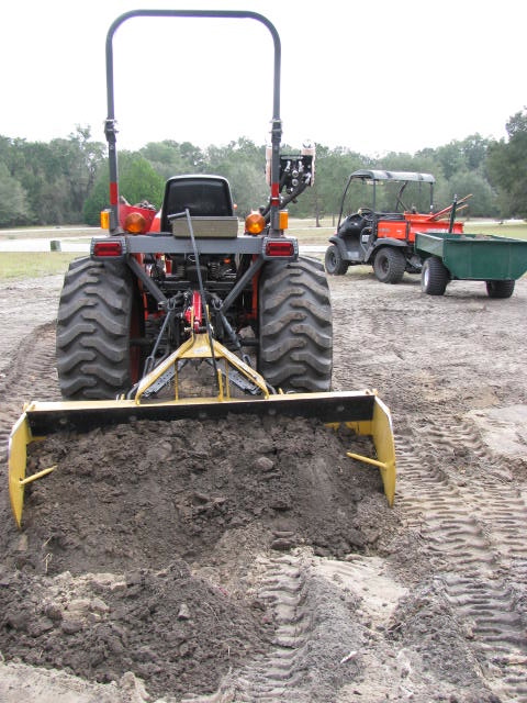

I have Mark Hodge's stabilizers installed on my B3300SU. Not only make loading attachments easier but also reinforce lower links. I was afraid to push with my box blade prior to installing Stabilworks' mechs.

They only took 20 minutes to install and a lot of the time was spent trying to pinch the original cotter pins closed so that I could pull them out of the Kubota stabilizers.

3. Rigid stabilizers reinforce the 3-Pt lift arms when pushing. This is important if you push with a box blade and have a relatively light tractor like my Kubota B3300SU: 33-hp / 1,800 pounds.

The point of the stabilizers isn't to expedite hooking anything up but rather to make it safe to use an attachment like a box blade to push safely in reverse.

People use their equipment in distinct ways. Personally, ease of mounting implements with is 65% of the reason to have telescoping, pinned, rigid stabilizers and strength/reliability 35%.
I bought aftermarket telescoping, pinned, rigid stabilizers from Mark Hodge at Stabilworks for my earlier Kubota B3300SU tractor-loader. (See Post #4, Post #14) I liked the Stabilworks setup so well that when I bought a heavier Kubota L3560 it was partly for the Kubota telescoping, pinned, rigid stabilizers standard equipment on the 'Grand L' series.
I spent yesterday at the 2014 Sunbelt Ag Expo in Moultrie, Georgia. TREMENDOUS EQUIPMENT SHOW! My primary reason for attending was to research heavy Tandem Disc Harrows. However, I spent considerable time at Kioti's large exhibit and LS's large exhibit. Both producers point out their telescoping, pinned, rigid stabilizers as soon as inspection arrives at the Three Point Hitch on their premium lines. Obviously, tractor buyers are interested in this Three Point feature. While I am sure both brands 3-Pts are strong, the Lower Links and stabilizers on my L3560 are more robust than same on Kioti NX series and LS XR4000 series and XU5000 series.
I will never buy another tractor without telescoping, pinned, rigid stabilizers. And, yes, I pull and push a Rollover Box Blade often.
