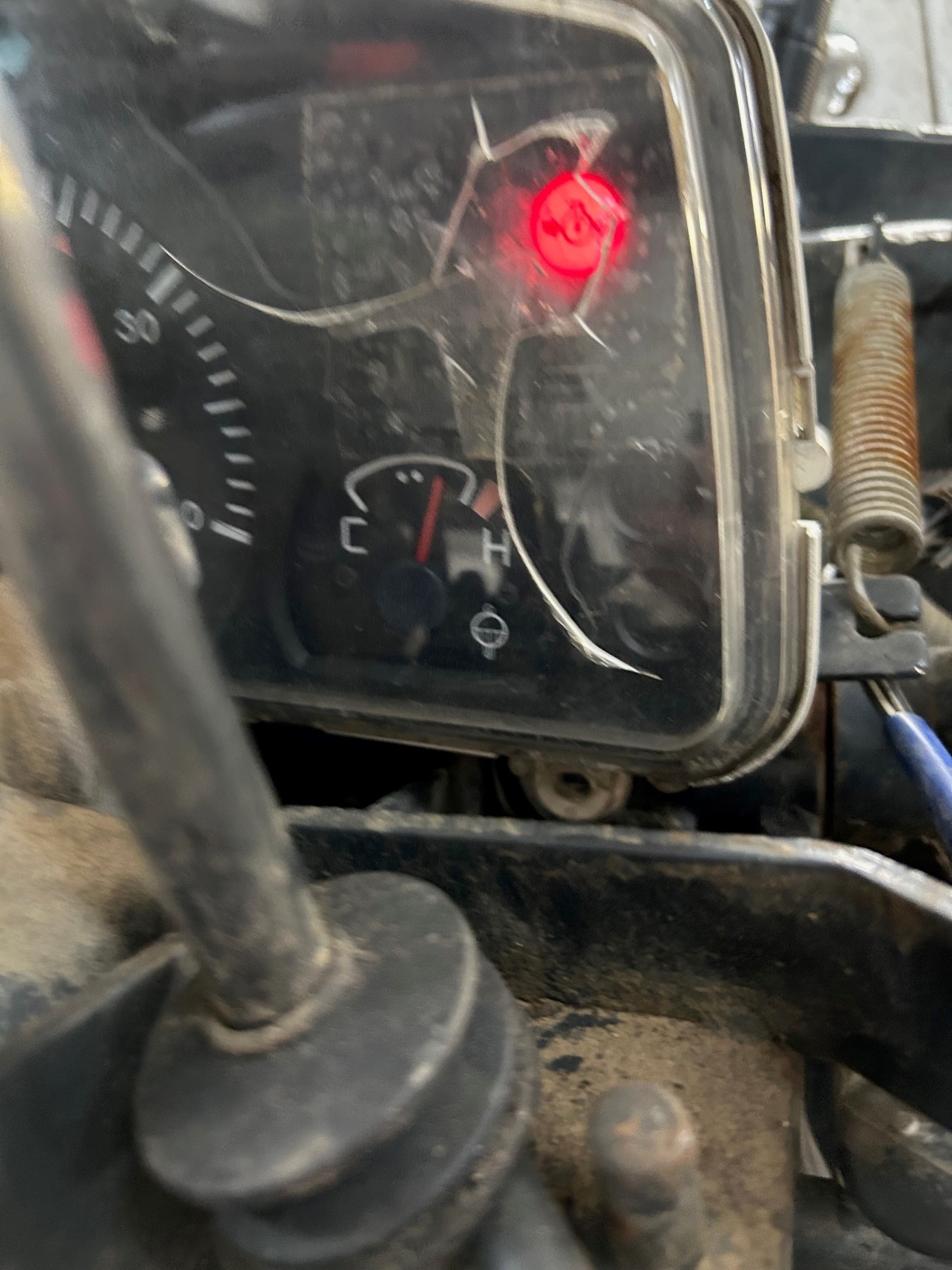

I left the tractor with a family member whom has been suing it for months. Every time the gauge creeped up to the "H" he would either shut it down or idle it till the temps lowered.

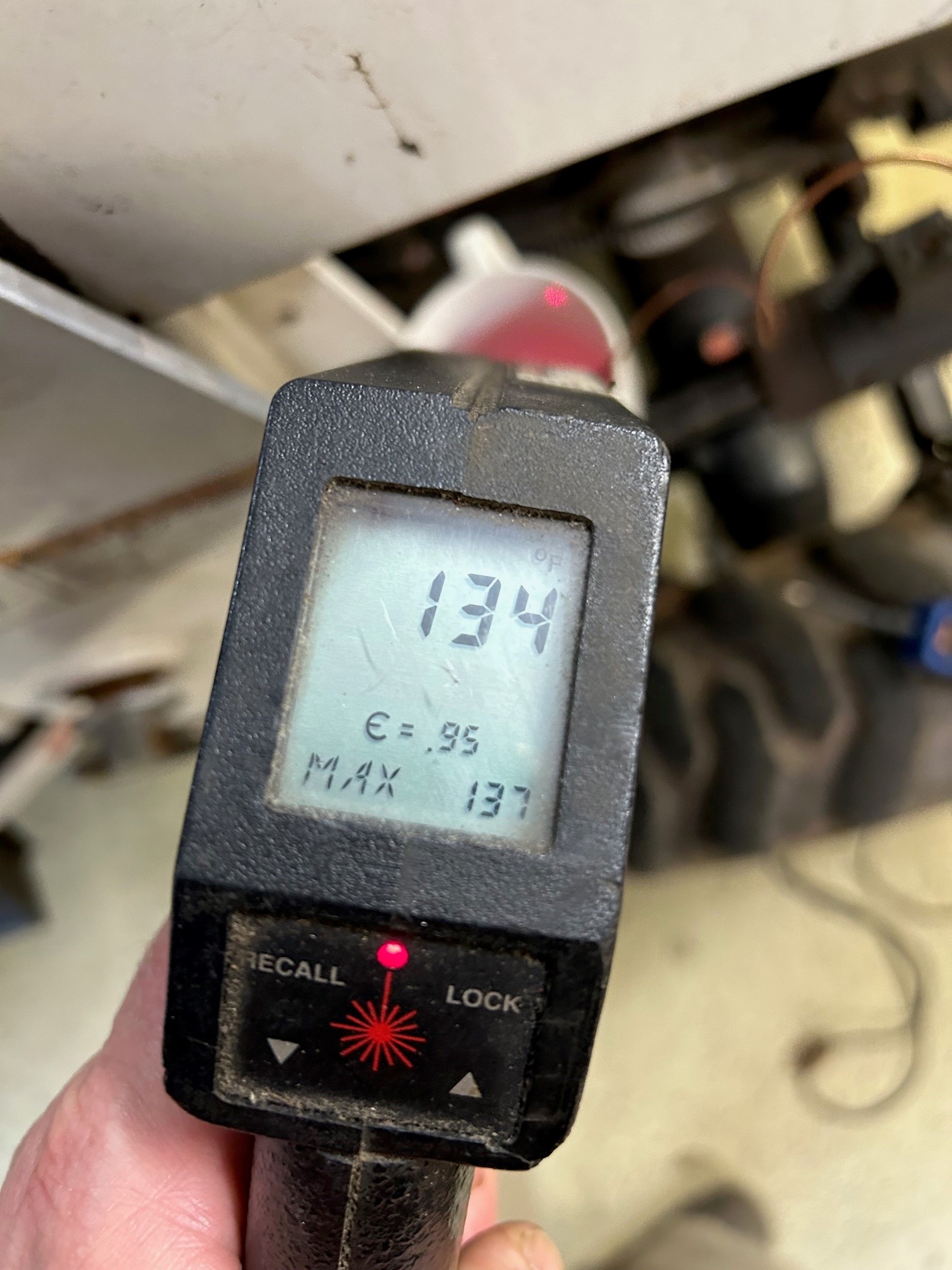

Step one was to make sure the gauge is indicating that the engine is over heating. I was able to replicate that, and as usual, I when I hit the rad, coolant neck, engine block and head, the temps were all under 160
Next I tried running it without the outside air filter. I was hoping that it was just that choked for air. No change without the filter
Next I added a mechanical gauge where the factory gauge goes. It never rose above 150. Being a little hesitant about the accuracy of the cheapest temperature gauge at Auto Zone, I hit the engine and rad with the IR temp gun and a thermal image camera. Same results, normal temperatures.
Gauge or wiring issue? I took the gauge cluster and gauge shroud off the tractor and traced all the grounds to make sure they were clean. Next I took a ohm meter and made sure there wasn't any resistance on any of the wires that are connected to the gauges. All the grounds were clean and I had good continuity on all the circuits that I checked. I was confidant that the wiring was working as it was designed.

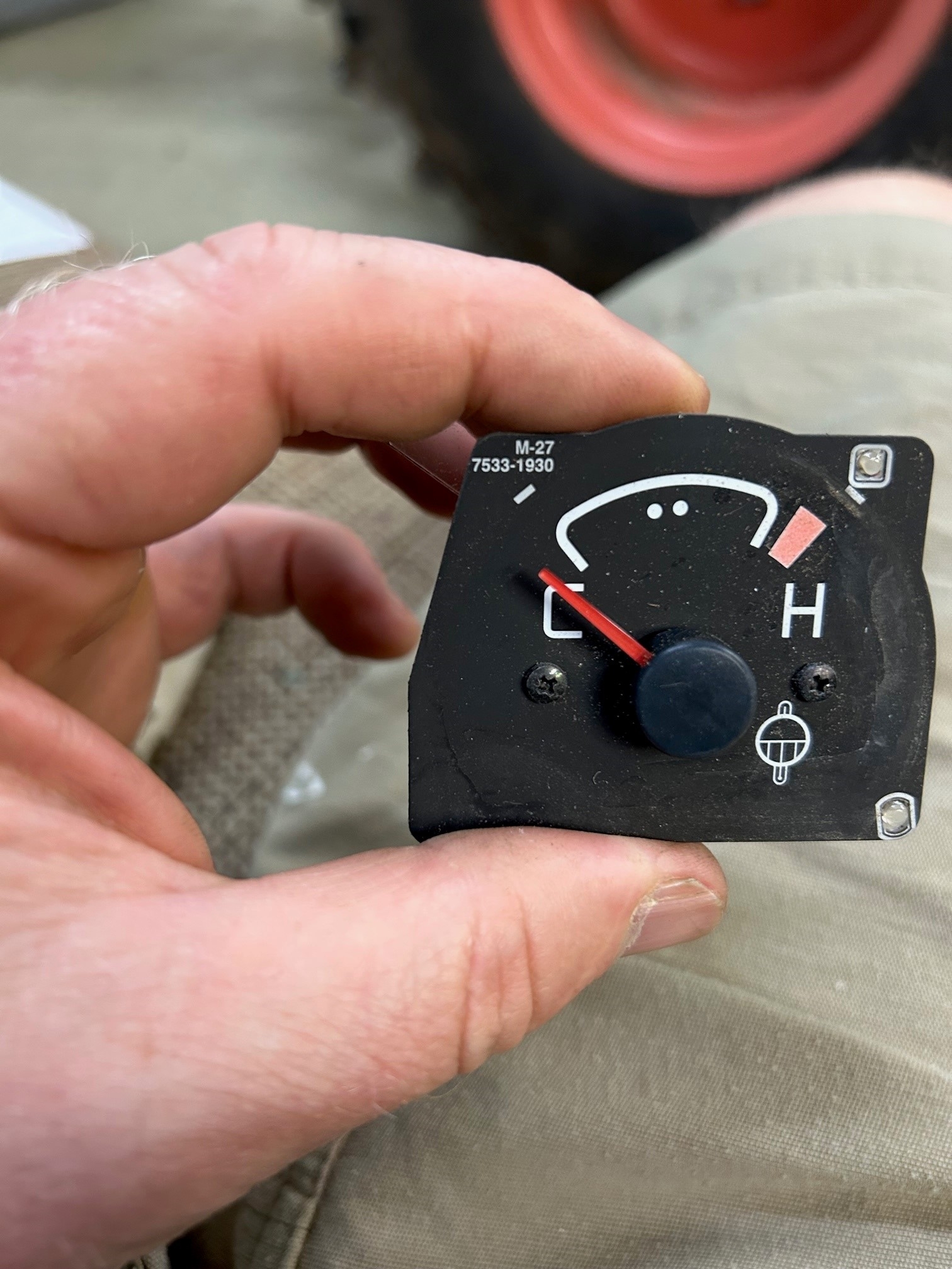

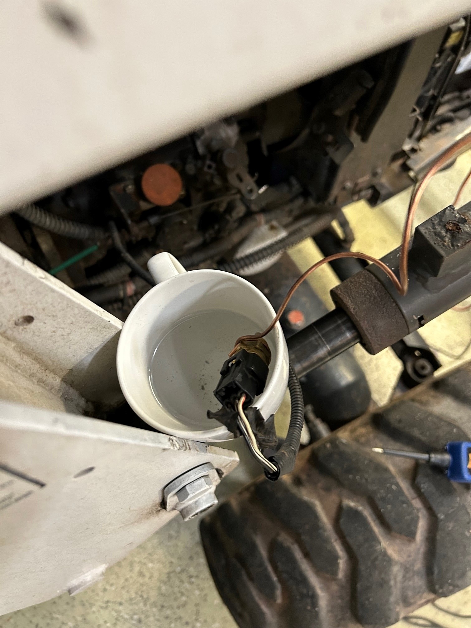

After a few cold snacks, I started looking at the gauge. It was getting 12.6v from the fuse panel, and putting 10.3v out to the sensor. The schematic that Bobcat puts in the manual is okay at best, so I could not figure out if 10.3v is normal. I had another few gold snacks and decided to microwave a mug of water and dip the factory sensor into the hot water. The water cooled to about 150 by the time I remembered that the sensor housing needed grounded to send the signal and rig that up. At 150 ish the gauge was almost at the H. I didn't think to take some pictures till it cooled to 130ish, the gauge was still showing above normal operating temperature.
I tried taking the gauge apart to see if I could calibrate it, I could not. I decided to clean it up and put it back. Whilst cleaning the gauge I managed to break it.
