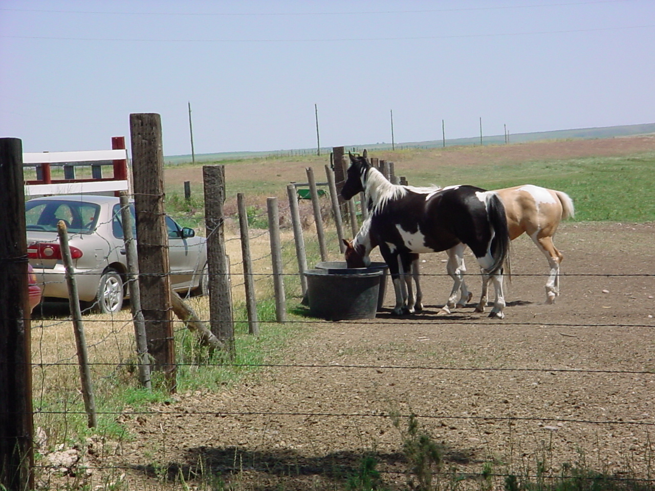

Since we all like pics I thought I would throw in a few. The last one is our Bay Homozygous Paint Stud, one of our two stallions. The two babies in the other pics are his. The Black horse is our Gelding. Enjoy! :D
