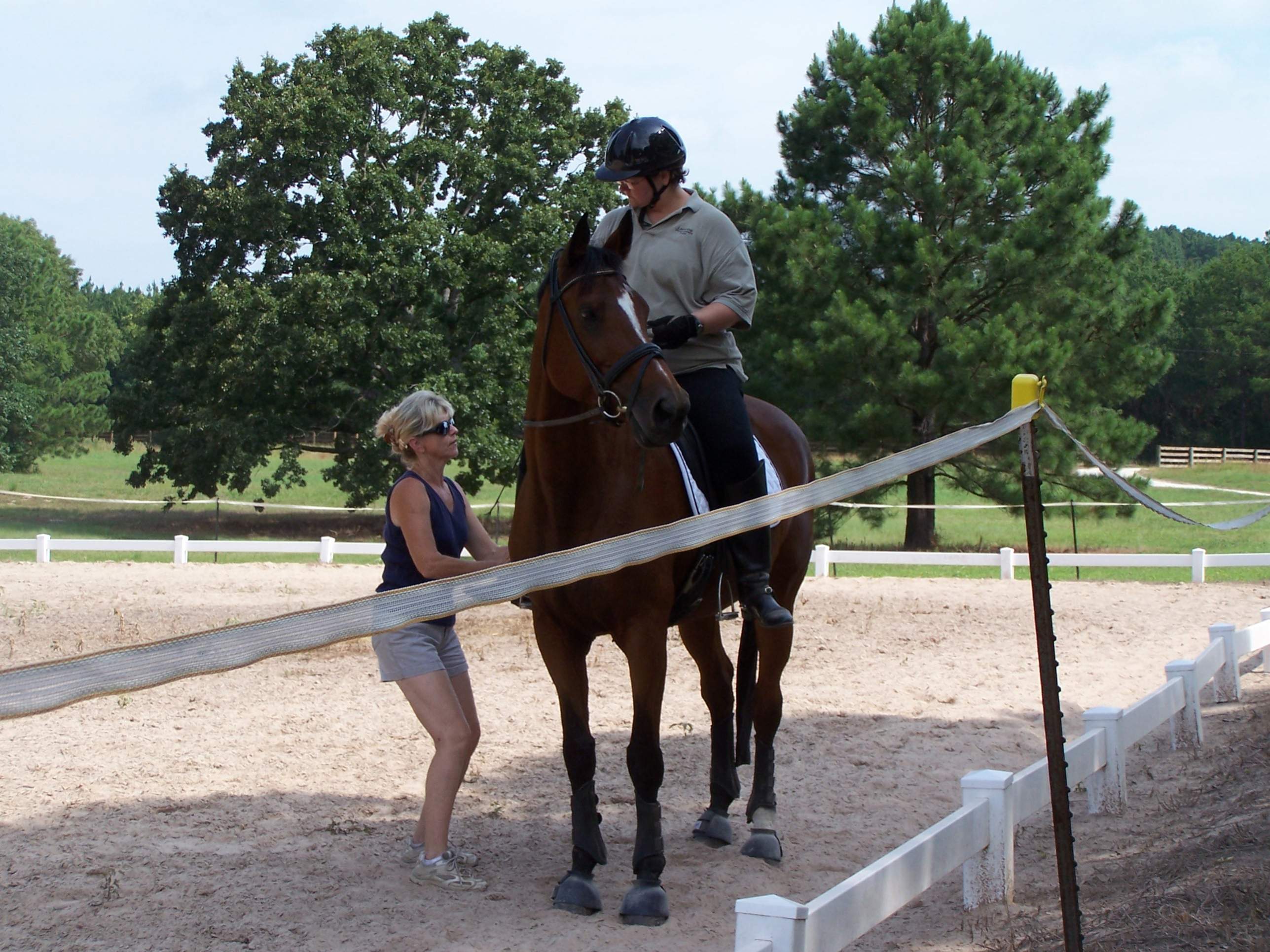

Here is a picture of my stud colt that was put down because of the stupid barbed wire and then a few pics of the type of horse fencing I like to build:
Great looking fences there.....nice job
