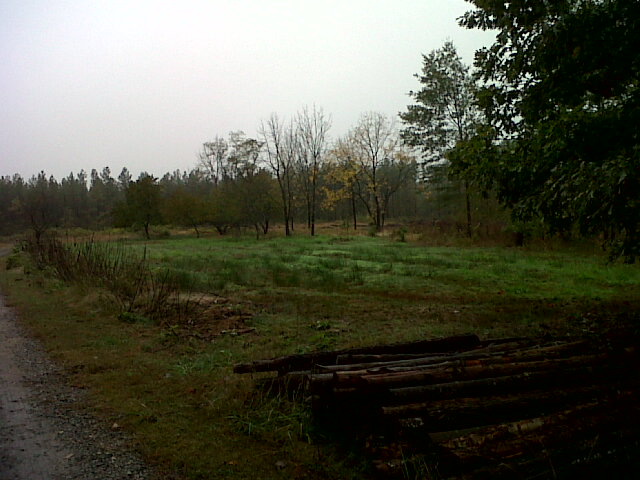

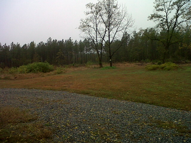

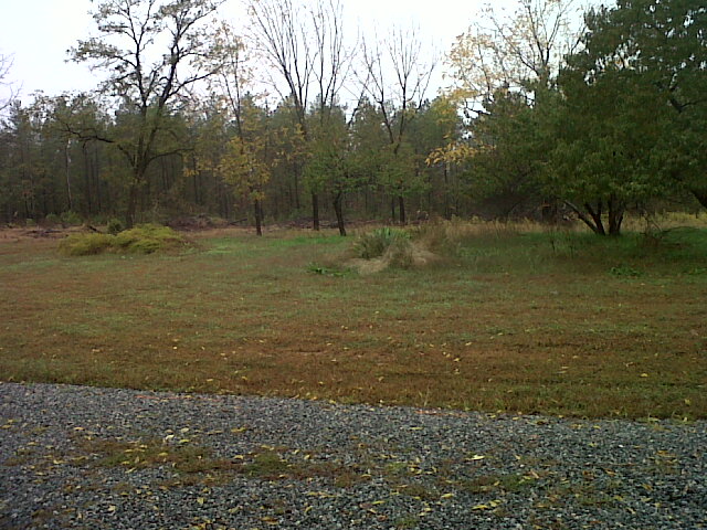

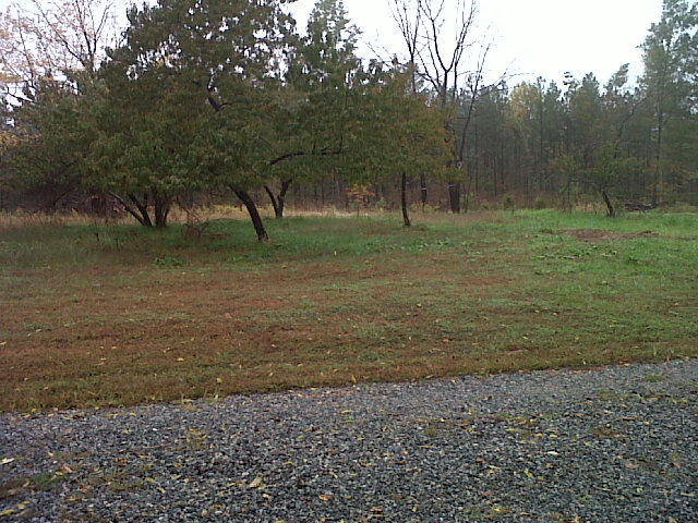

Here are the pics I promised. They start from the newly bush hogged area and go south towards the wider and mowed areas.
There are at least a couple trees as landmarks in each picture, although the direction I am facing changes to show the full extent of the area I have.
The spots I am standing are all on my gravel road driveway, inside my gate, down a long gravel easment through 2 other properties, and eventually the pavement starts somewhere down there, so we are very isolated from the "road".
So far the advice has been awesome.
OH! I also plan to use some of the trees as posts as well.
I will update you all as I get started.
Be well,
David

Good Luck on it, I'm sure you have a good idea of what you want to use now with all the good direction you received from us here on TBN. Setting up a good temp fence is not rocket science and there are a lot of ways to do it but you want to do it with safety for the horse/horses in mind. :thumbsup:
