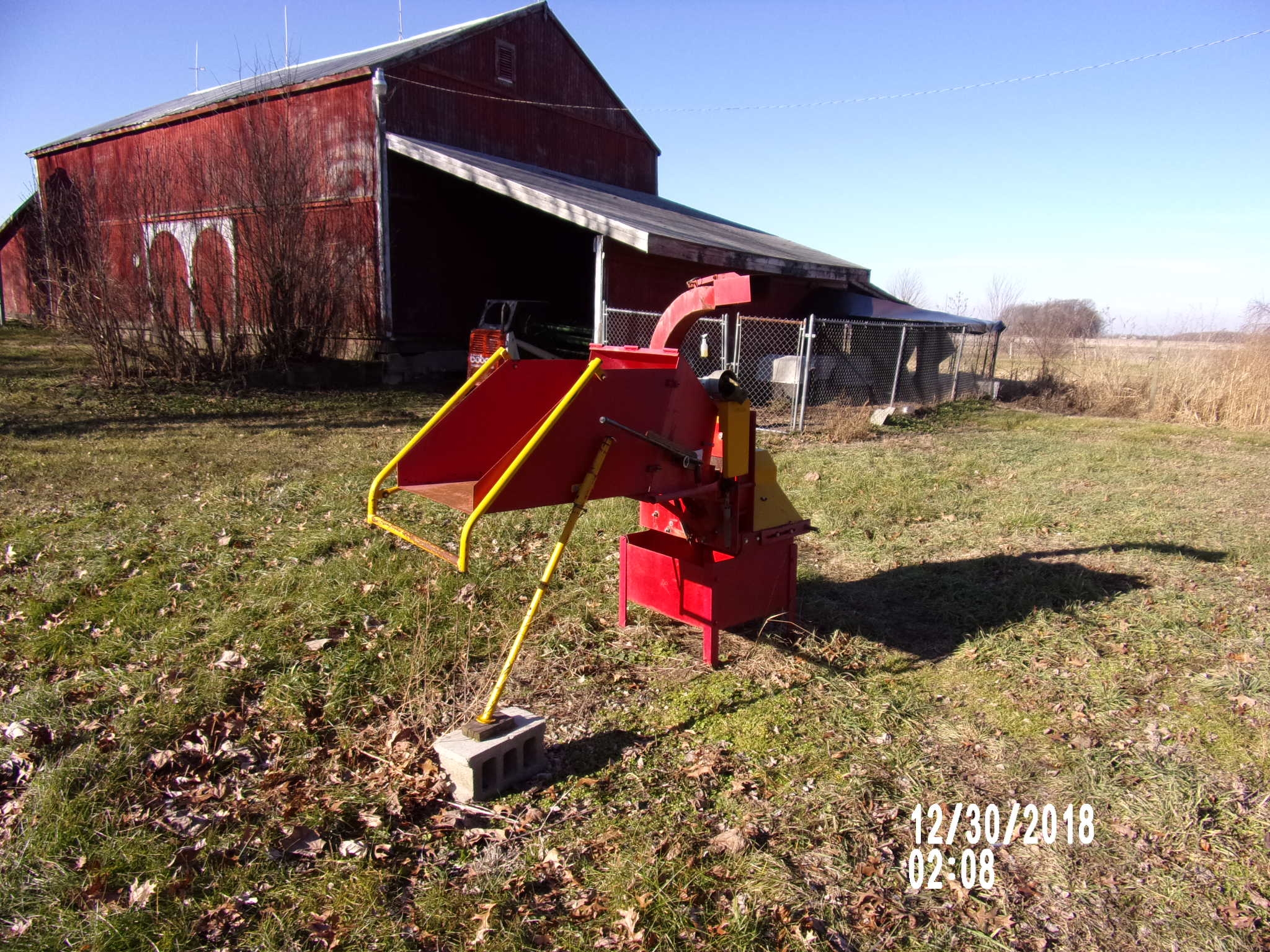

   / Tension roller on Woodland Mills WC88 #25
I had and sold a Chinese chipper some years ago and never had a belt issue with it but I kept them fiddle string tight at all times and kept the pillow blocks well greased. Sold it for what I paid for it in about 2 hours on FBMP and I ran it on the back of one of my 90 horse Kubota's, which is why the base is so high up so I could run the pto driveline reasonably straight.
