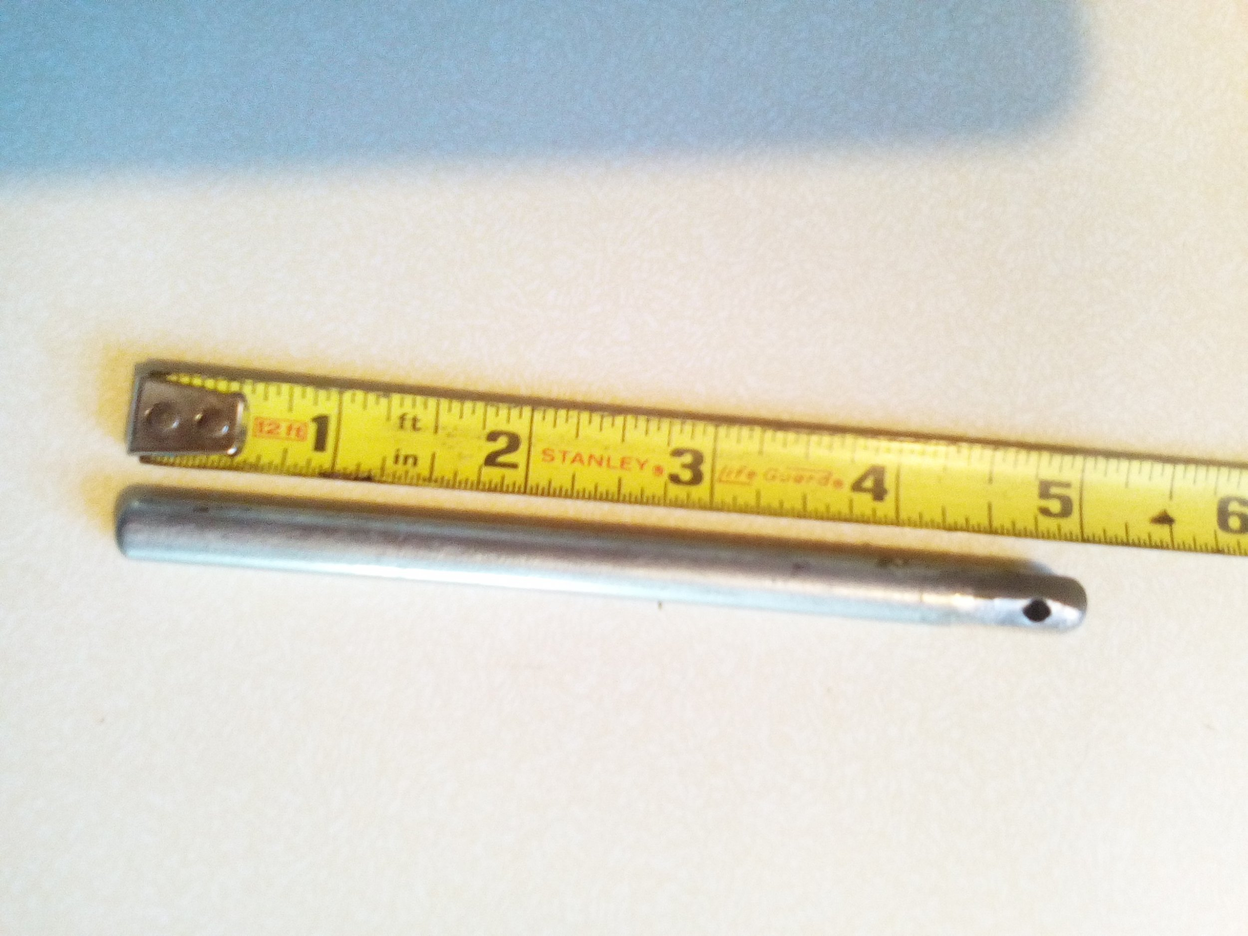

When I worked at the fence company we'd make gates for a vineyard that had us use their field fence wire for filler, that was some high tensile stuff. Rather than fighting it with pliers, we made up some twister tools from truss rod drop. That would wind a few turns, then trim and use the pliers to get the finger slicer laid flat.
   / Terminating wire woven fence options #15
I find wrapping the ends is quicker than crimping them. At least with the crimps I have I need a long stretch of unbent wire. Crimping also leaves ends that can jab if you don't deal with them.
For wrapping, I use this: Contact Us - Fence Pro T-Post Clip Tool . Of course, the website says they have halted production. It's just a piece of 1/4" rod with about a 1/8" hole in the end, about 8" long. I also have one bent into an L shape. Sometimes the end of the wire gets positioned just so and you need three different tools to get at it.
