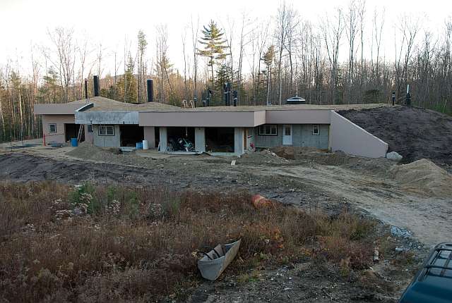

Things are moving slowly here in Maine. Our new "done" date is Jan 31 (yes, 2010).

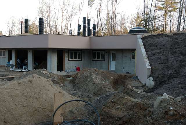

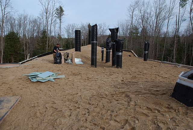

The roof shot (1433) shows the roof insulated and filled. Note that there was a fair bit of settling after we got 3" of rain overnight. We will probably be refining roof drainage next spring is my guess. The exterior shots show open trenches for the utilities; these did mostly get reburied before the snow hit this week. Plowing snow with open trenches would be way too much fun!

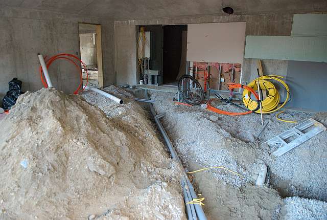

1451 shows the inside of the garage. The door on the left leads to the shop, then there is the main electrical panel, then a door into the laundry room (just an opening now). To the right of that, amongst several rolls of tubing is where there will be a small room with heat, phone, well pump, etc in it. We will be pouring the garage floor next week (finally). This is getting pretty important: I have a bunch of steel fixturing I want to cast in the shop floor concrete. Right now it is getting snowed on. I *really* don't want it to get frozen in. Next week it goes in the new house garage.

The second source of condensation are the tubes penetrating the roof. Same deal, the black plastic tubes have outside, cold air on the outside, warmish damp air on the inside, water dribbles. There are pipes running up some of the tubes. Sealing between the black outer tube and any stuff inside with foam seems to work fine (the foam seal is at the bottom of the tube=ceiling level). I didn't see, I think they used a combination of foam insulation board and some spray foam (canned stuff) to fill in the cracks.
