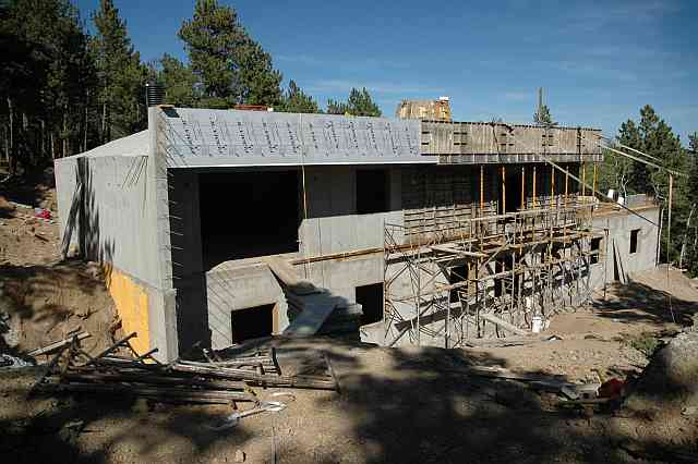

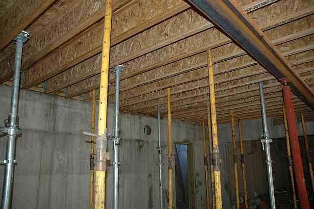

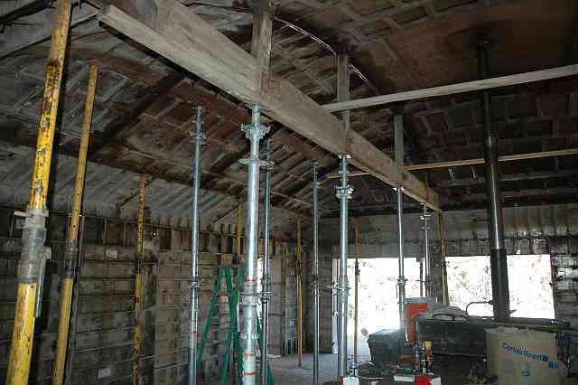

(this is Steve and the Maine house) Silly of me, I saw that you said you were in NE and I thought New England. I grew up in Nebraska, should have thought of that.
We have read about earth sheltered houses (use this term, not 'underground' when talking to banks, insurance, etc.) for years, but we have still been babes in the woods on this. We bought land before talking to a contractor; this is ok if you know what you're doing (we didn't). Our site dictated building the house on a sort of level spot instead of into a hill. The water table is so high that we built at and above grade, with more dirt over the top. Terra Dome did everything by email prior to sending the crew out to begin work. They came out in December and kept saying things like "does it always snow this much?" and "we saw a moose!".
Terra Dome has custom forms to cast the concrete domes, so with them you don't have the choice of getting a competing bid from another company. You'd have to do some house design both places and see what they cost.
Skylights and suntubes are nice, but you may not want them in your bedroom. Remember, in a stick frame house, the ceiling and walls aren't transparent either.
I happened to go to Colorado the week that Terra Dome was pouring a two story underground house in Ward, CO. A few pics attached. Not something that had occurred to me to do.
181 shows the forms for casting a dome
196 shows the second floor with temporary supports
Steve
ps: we were going to have more sun tubes, but ended up cannibalizing the pass throughs to the roof for ventilation instead, as we didn't have enough.
