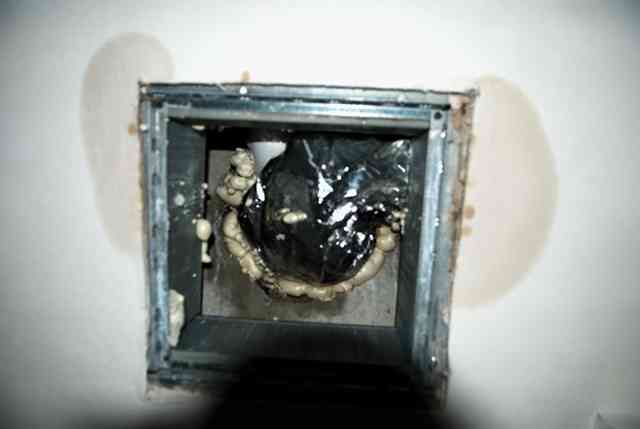

We're having leak problems at our TD house project in Maine. Water comes in around the holes in the roof. We don't have actual puddles, it is more like seepage (but enough to get the plaster wet). I should add that we had 4" of driving rain in three days (today it turned to about 12" of snow)--this is called a Noreaster where the storm sits on us. I will get my pictures out of the camera and post later.
I don't know what to say about how to fix it, since I haven't fixed ours yet (our soil is still frozen). Take a close look at your joints, maybe flash them twice.

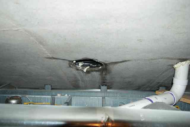

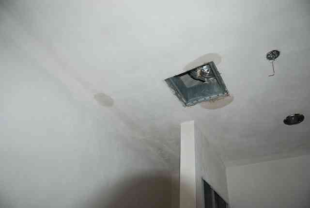

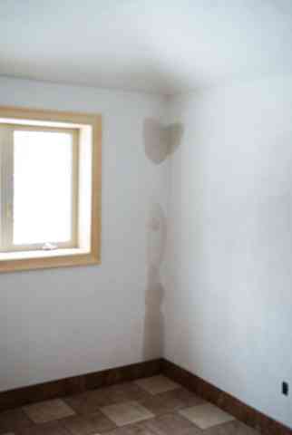

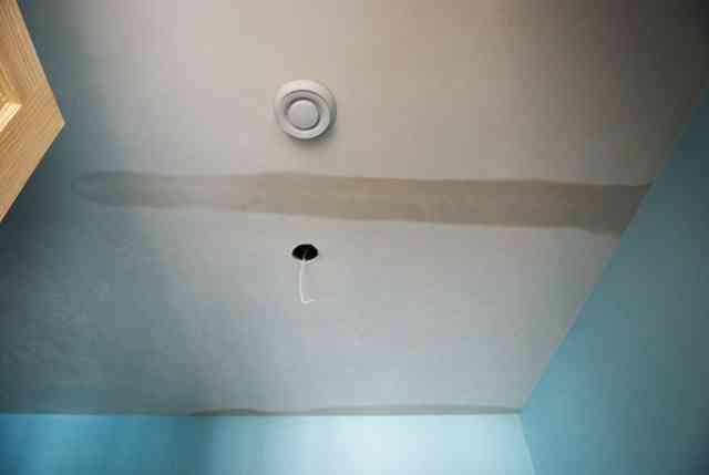

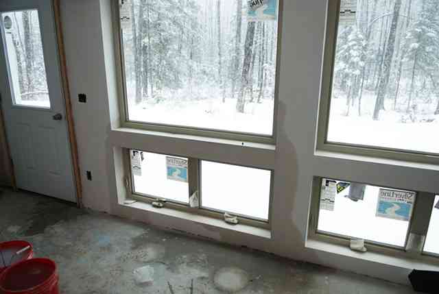

Some pics of the water leaks in our Terra Dome house in Maine.
The blue walls are in a bathroom--you can see the leak on the ceiling, following the framing. The next shot is above this ceiling, showing the curve of the concrete dome and the ~8" hole with a black tube inside it penetrating the roof. Water is coming in around the edges of the tube.
Same kind of deal in the master bath, pic of ceiling showing moisture and the access panel, then a closeup of the access panel and the roof penetration above. All of the roof penetrations look like they are leaking. My contractor supposedly followed TD's directions for flashing, we'll find out more when we dig things up.
The last two pics are other leaks. One bedroom has water in the corner; this is the corner of the module. The module butts up against the living room module, no leak in there. Last is the leak around the greenhouse windows. Only the one window was leaking, the other two were fine. Hopefully this one should be straightforward to fix once we find the problem.
That's where we're at leak-wise.

Sorry to hear you are having issues Steve. That has to be one of the biggest challenges for that construction method. Hopefully this Spring you will be able to scope it out and find a solution to sealing the penetrations. Giant hose clamps around gaskets or something?
The greenhouse window should be straight forward at least. Mostly likely just needs some caulk in the right places.

Steve, your leak problem is something I am dealing with as well and the waterproofing company has been little help. I am looking for solutions and will let you know what I find.

Some pics of the water leaks in our Terra Dome house in Maine. Steve
That sucks about the leaks Steve. Water is amazing stuff when it comes to finding a way into a structure. It turns out the clown who built our house is notorious for building houses with water leaks. I flat out told him one time that he should advertise his houses as coming with indoor swimming pools. Let us know how you do in finding and plugging the leaks.
