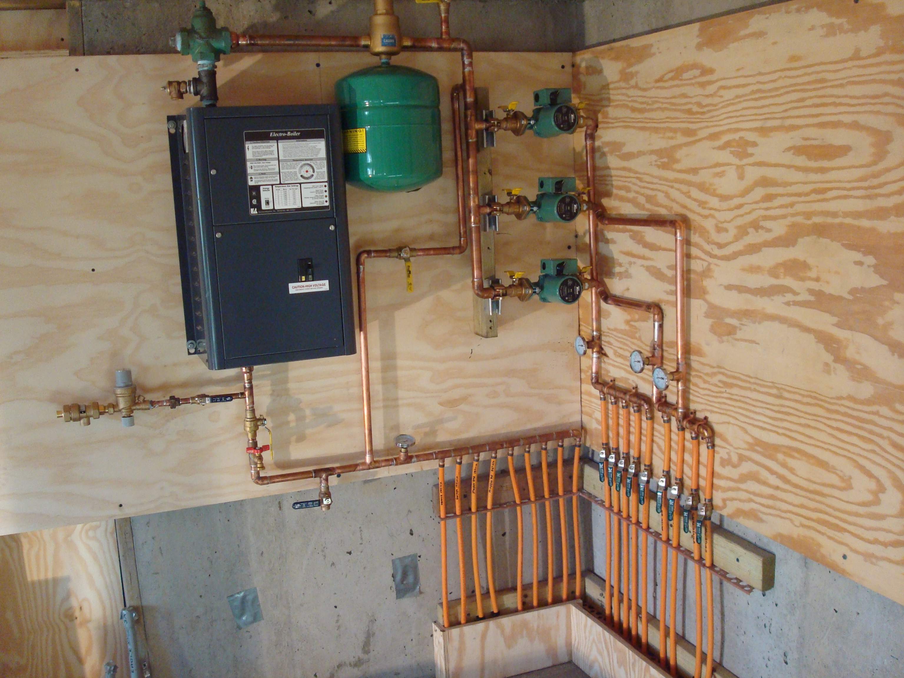

I contacted OD Trucking and they only service commercial customers. I got a quote from Fed EX of 962.50 for the 9 containers @ 360 lbs. This seems way too much... Any suggestions?
FYI..... We made up our own PEX manifolds for only a fraction of the cost. Also plan on making the PEX manifold for the water distribution as well.
