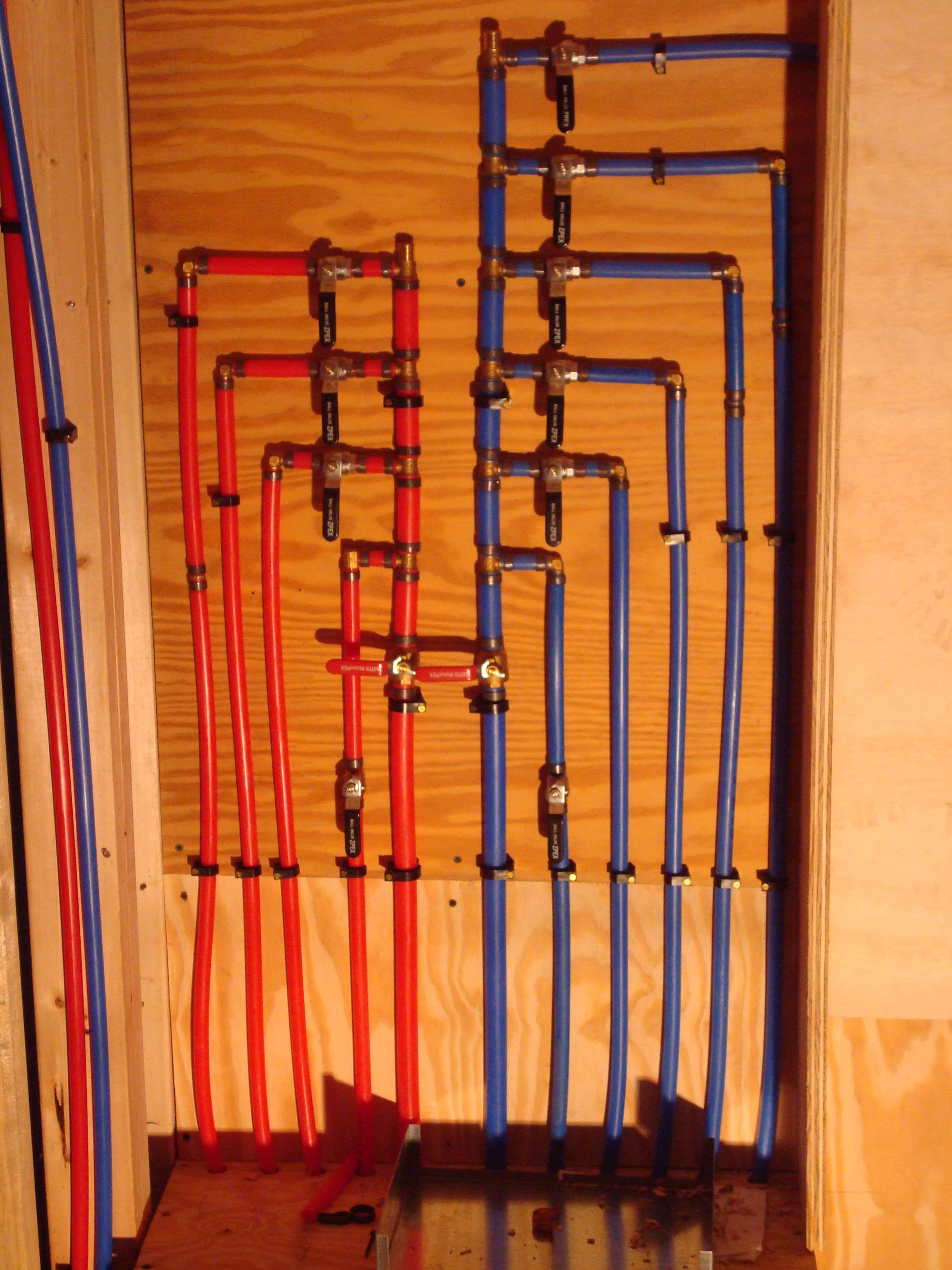

FYI..... We made up our own PEX manifolds for only a fraction of the cost. Also plan on making the PEX manifold for the water distribution as well.
Bob
Bob, can you explain the plumbing? Looks like a setup for Solar as well as water distro...
Bob
System plumbing is for radiant floor and shut offs for adding a future heating coil / zone.
Here's our poor mans pex water distribution manifold.
