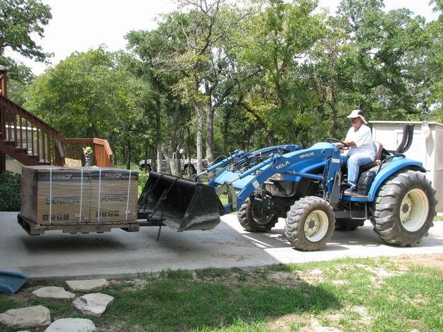

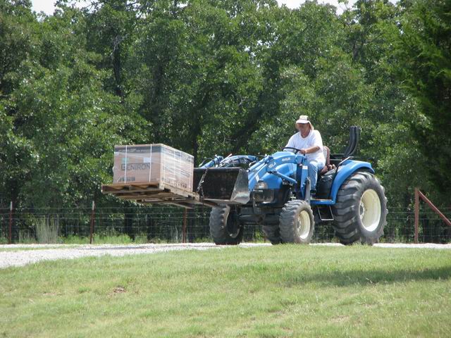

Sam, I hope you have the good luck with R+L that I did. My generators were delivered from CA with no damage whatsoever. I was really pleased.
