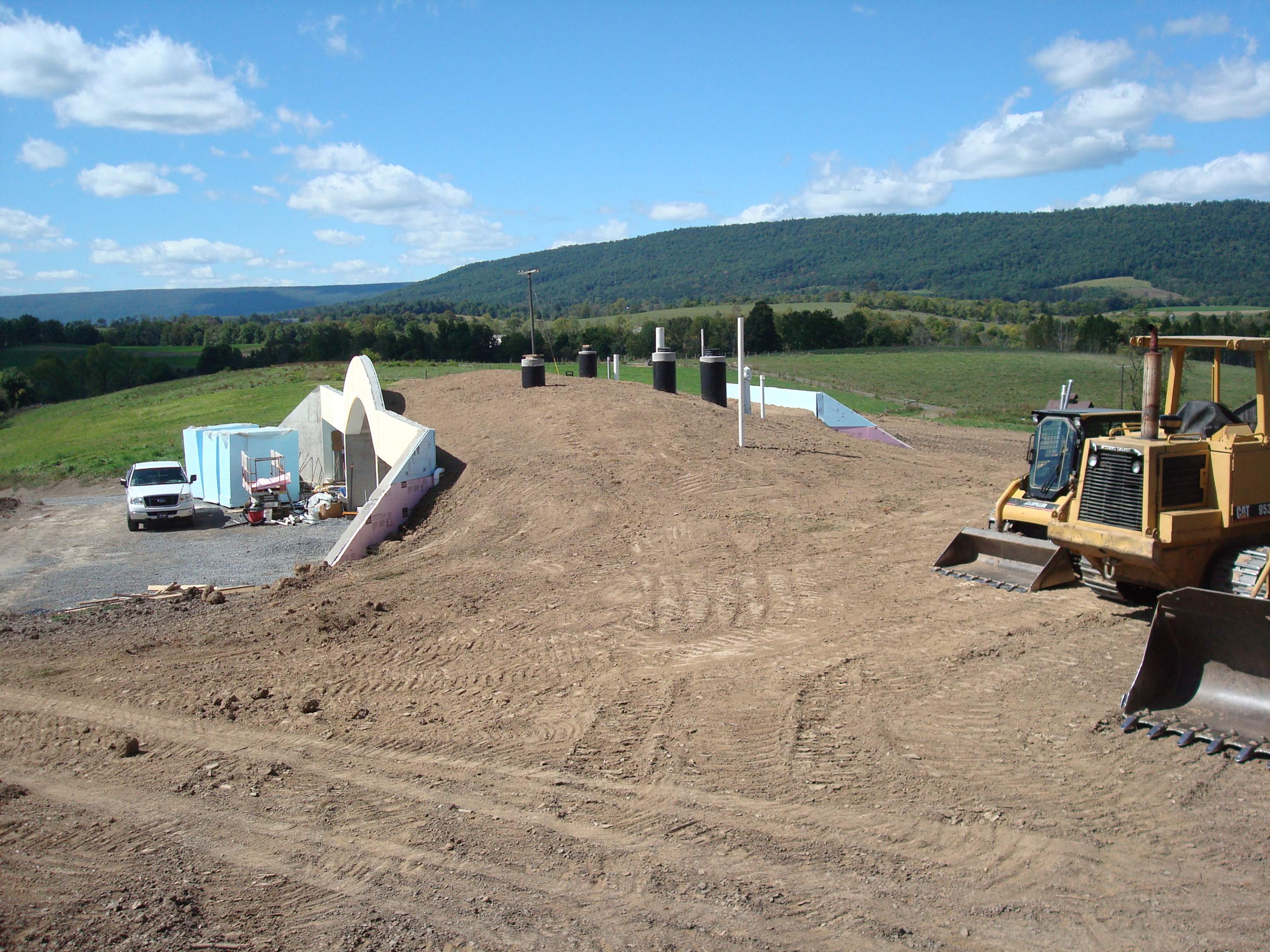

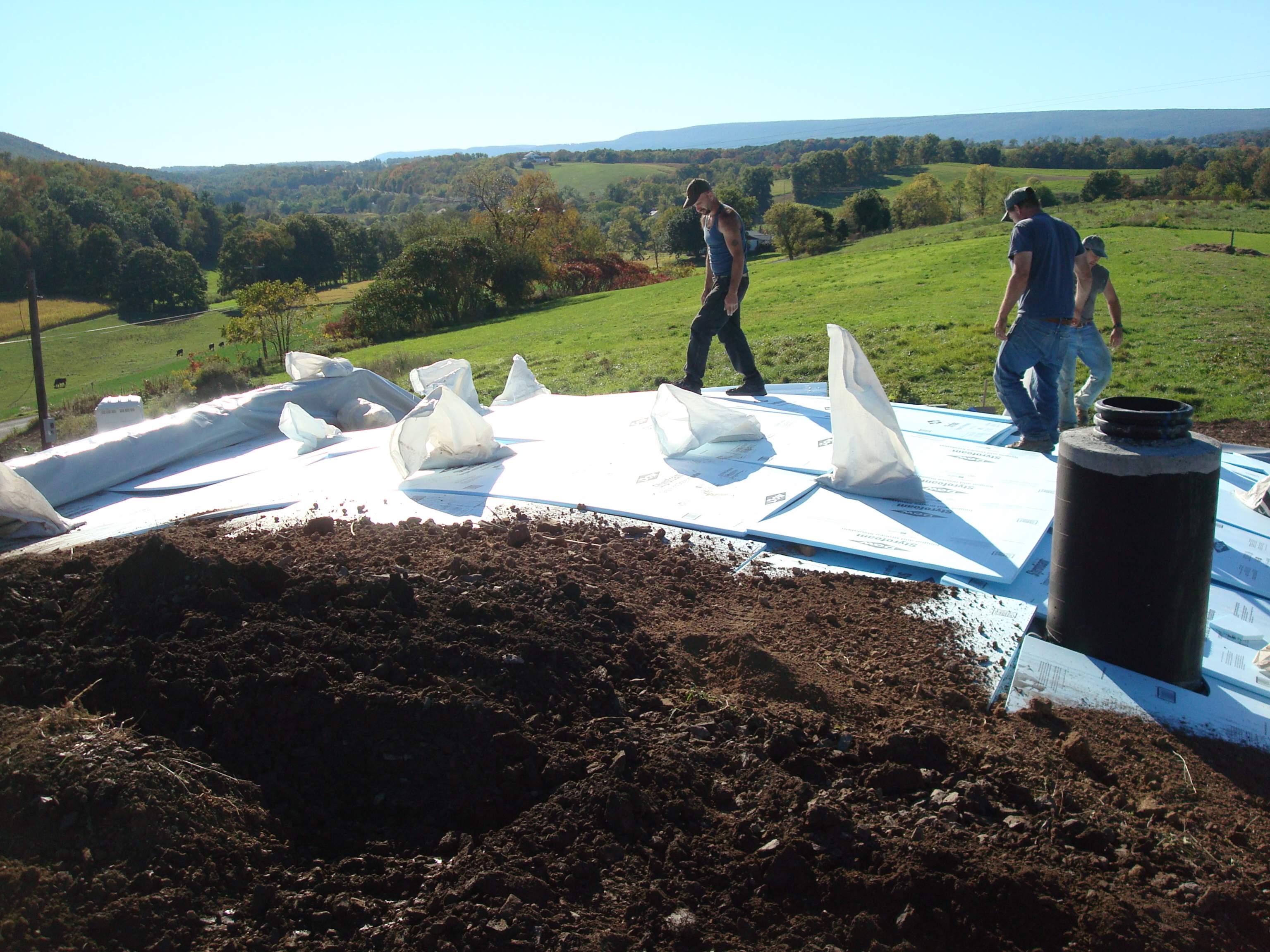

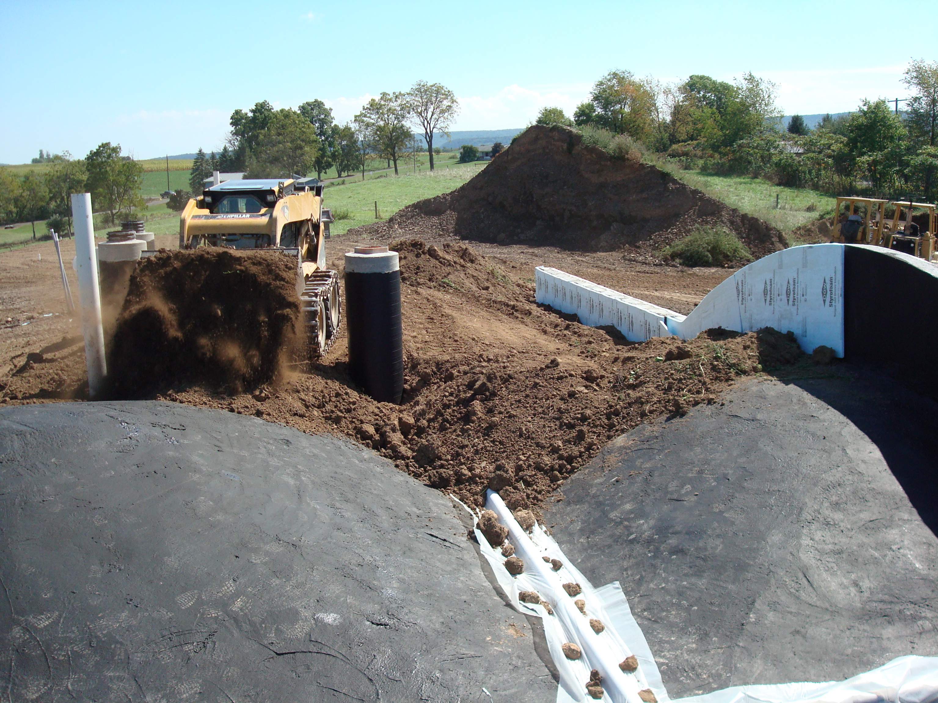

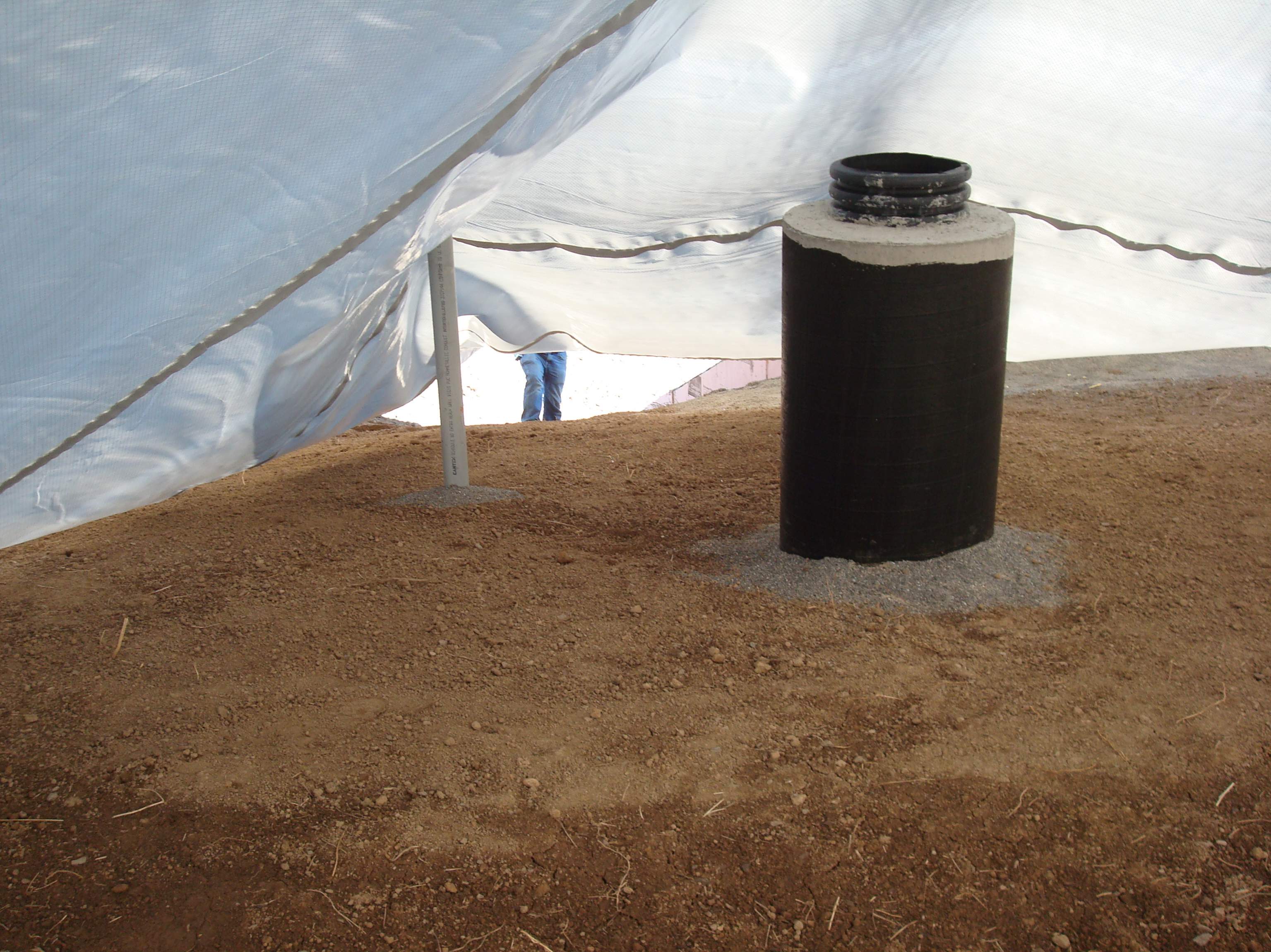

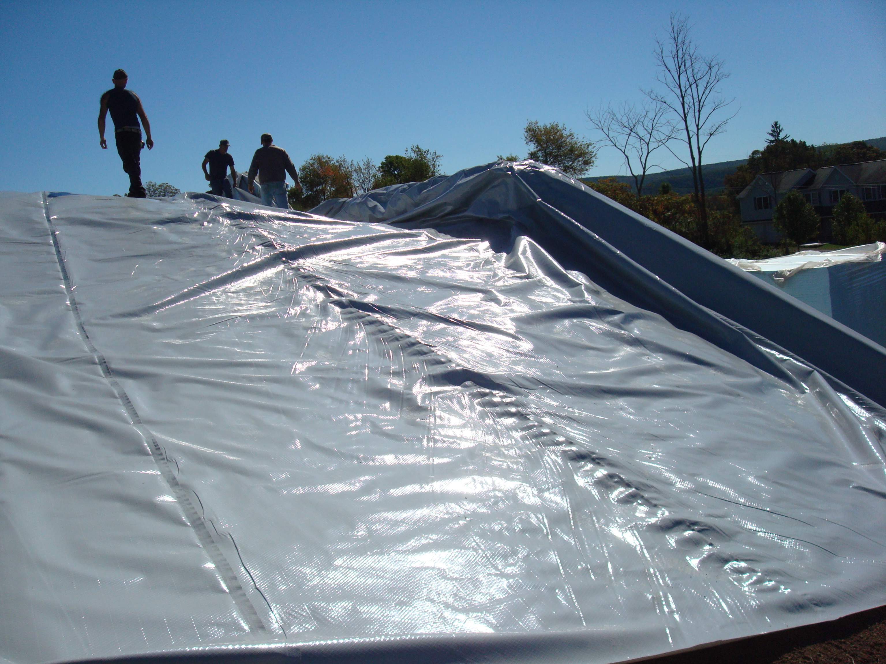

The 40 cfm per register works well for ventilation. I would increase the cfm for ac or heat mode. Here is my take on waterproofing. Use the Econoline for damproofing (vapor barrier) then granulated bentonite in valleys / cold joints and parapet overhangs. Cover with 6 mil poly strips. Back fill the valleys and cover every thing with an inexpensive pond liner of some sort. Extend the liner a few feet beyond the walls. This keeps the dirt over and around the house dry. Turn on the sprinklers for a day and check for leaks. Lay down some insulation as you back fill. It rained about every day the past 2 months and a lot last fall and we have not had any leaks.
   / Terra-Dome Earth Shelter Build
#754
Please elaborate with product links on the granulated bentonite, 6 mil poly strips and the pond liner.
Thanks
   / Terra-Dome Earth Shelter Build #755
The liner is a 12 mil dura-scrim from Raven Industries Standard Product Line. Jay can order it at your specified size at a discount and have it drop shipped from Raven. They also have kits for sealing around penetrations but you could make your own. The laminated poly/bentonite sheets are way too expensive so I just made my own. You can get the bentonite in sacks from local well drillers. I Just sprinkled it in the cold joint valleys and parapet overhangs.
Then covered it with 6 mil poly sheeting from Lowes cut in 3- 4' strips. We also laid drain pipe on top of the poly but I dont think it was necessary as water should not get to it. At this point we just filled the valleys and overhangs and used sprinklers for a leak test.

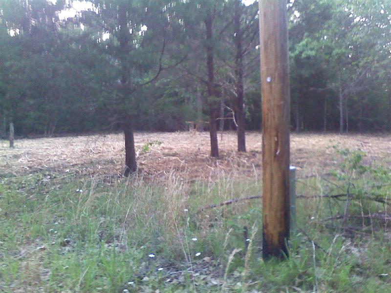

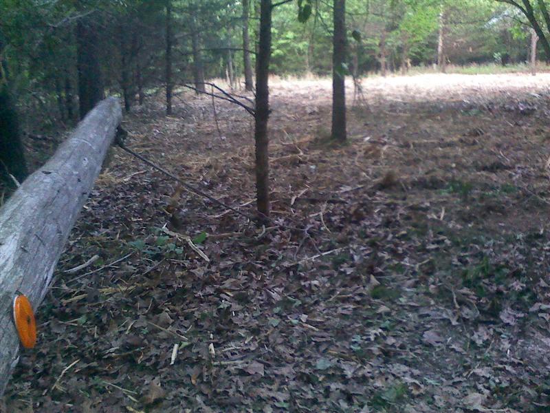

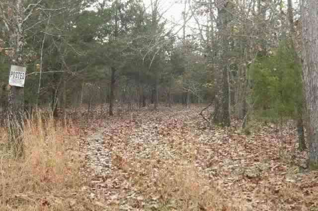

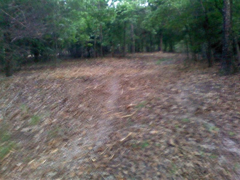

Hey Pat,
Glad to be of assistance. I have learned so much from this blog. You guys that are doing it, really impressed me. I have 5 acres over near Mountain Home, AR, and I just had an excavator guy with a forest mulcher attachment to a Bobcat skid steer clear the lane in and about an acre of it. The pictures came a little grainy but now I can see the trees from the forest. LOL :laughing:
I will be going up and spend the month of October there at a "resort" fishing cabin with my wife to see if we indeed want to move there. I will be looking into putting a arched steel building on a concrete slab as a vacation cabin and future guest house. I am restricked by a deed to "No manufactured or mobile homes" and "No hunting allowed". So what ever I have to "live" in must be stick built and I think this will be allowed. I can bolt stuff easier than being a carpenter. lol
I will be contacting that crystalline additive company "Krypton" about costs and that will be in the contract for my Terra Dome home when I can get that working. Got to wait for the real estate economy to pick up down here in Florida. It is still going down. I will try to attach a picture or two to this here blog for your information and edification. lol
John L
