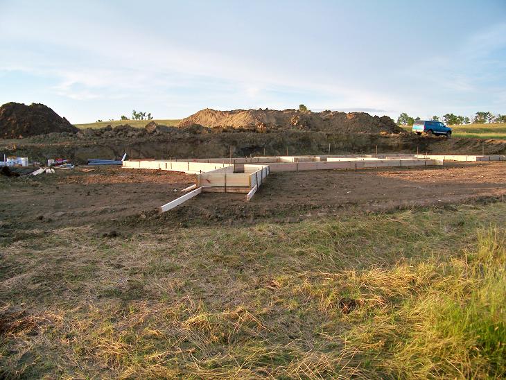

I've been preoccupied with getting the plans finished and contractors organized and didn't get to posting. It has been painstakingly slow getting the plans revised and back. We have definitely jumped on in! Half the footings are poured and we are to pour the first of the modules in another week. Ran into trouble already because a concrete truck was late and we had a downpour just as they arrived. Couldn't get the truck close enough to pour and it had to go back. Now we need more gravel and a different route because of all our rain. Usually dry as a bone here this time of year! Well we don't have your heat problem Sam. It is 49 at night and cools off nicely. Cameron is the TD guy on site right now. The forms are supposed to arrive Monday.

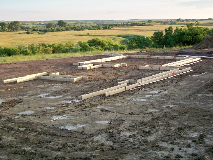

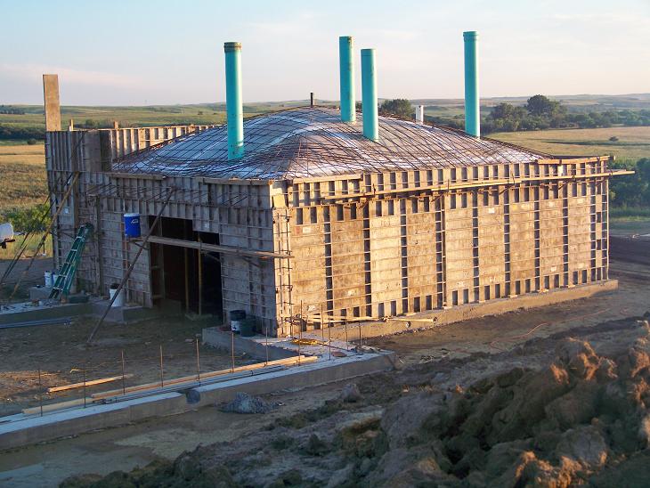

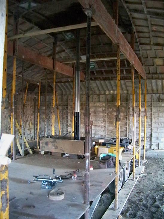

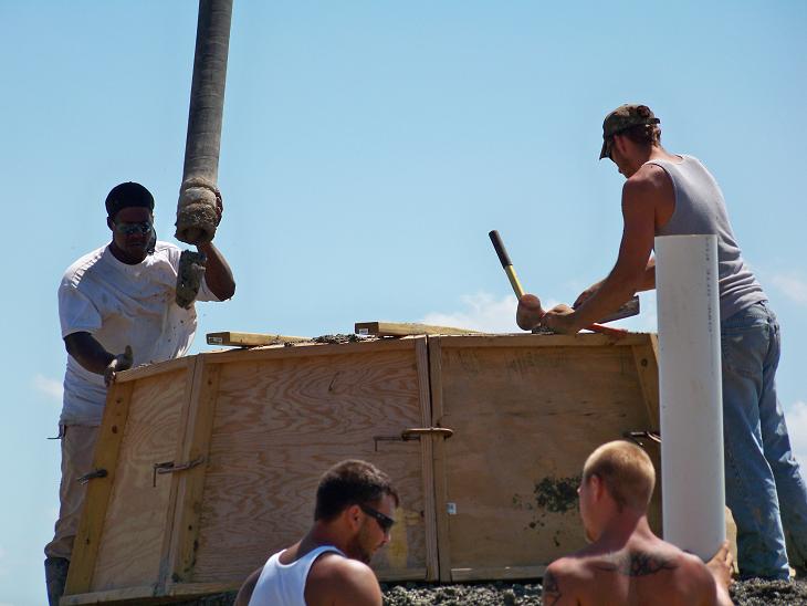

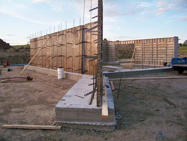

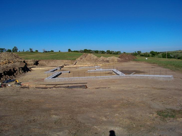

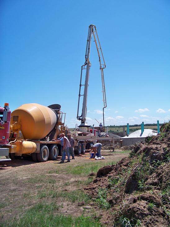

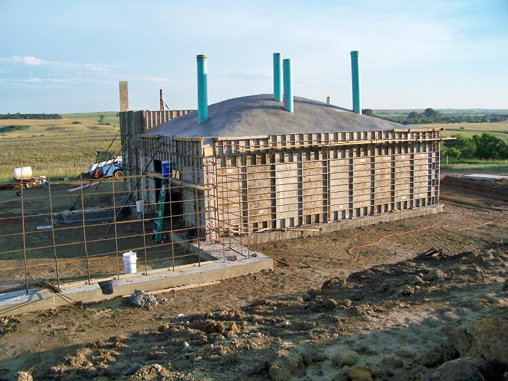

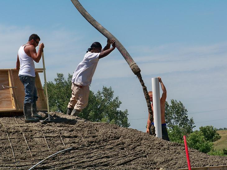

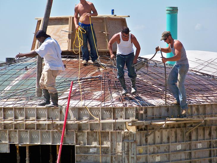

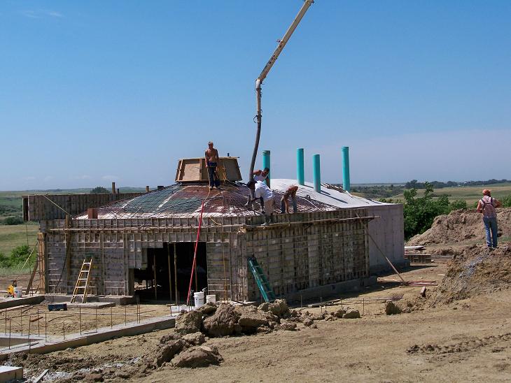

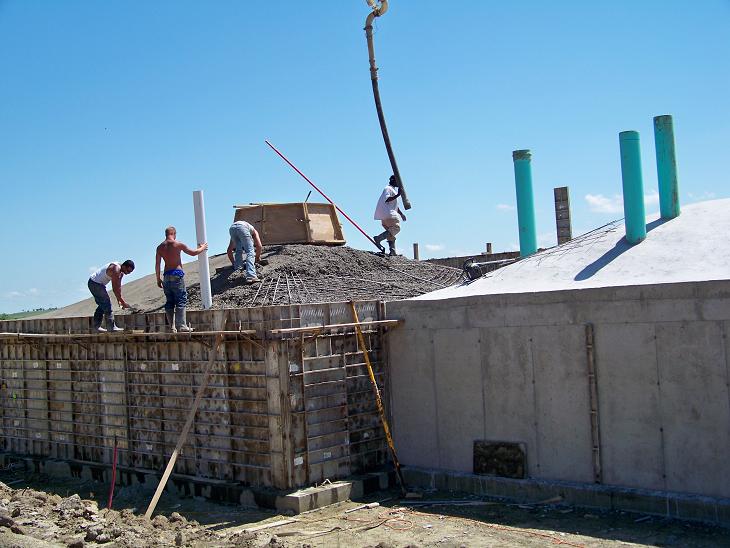

Our build is going well except for the thunderstorms every night that turn the site into a mud hole. This is a record breaking year for moisture in ND. We got two modules poured this week so thought I would let you see some pictures.
I am glad you aren't in the flooded zones and that your build is going well. I noticed you are using large water supply lines for roof penetrations, We used a 6" water supply line at three locations. Are you doing any of the work or are you subcontracting it out? Keep posting you progress and photos. Who's is running the show from Terra Dome? It looks like they may have two builds going at once because the sky window forms are now wood.
