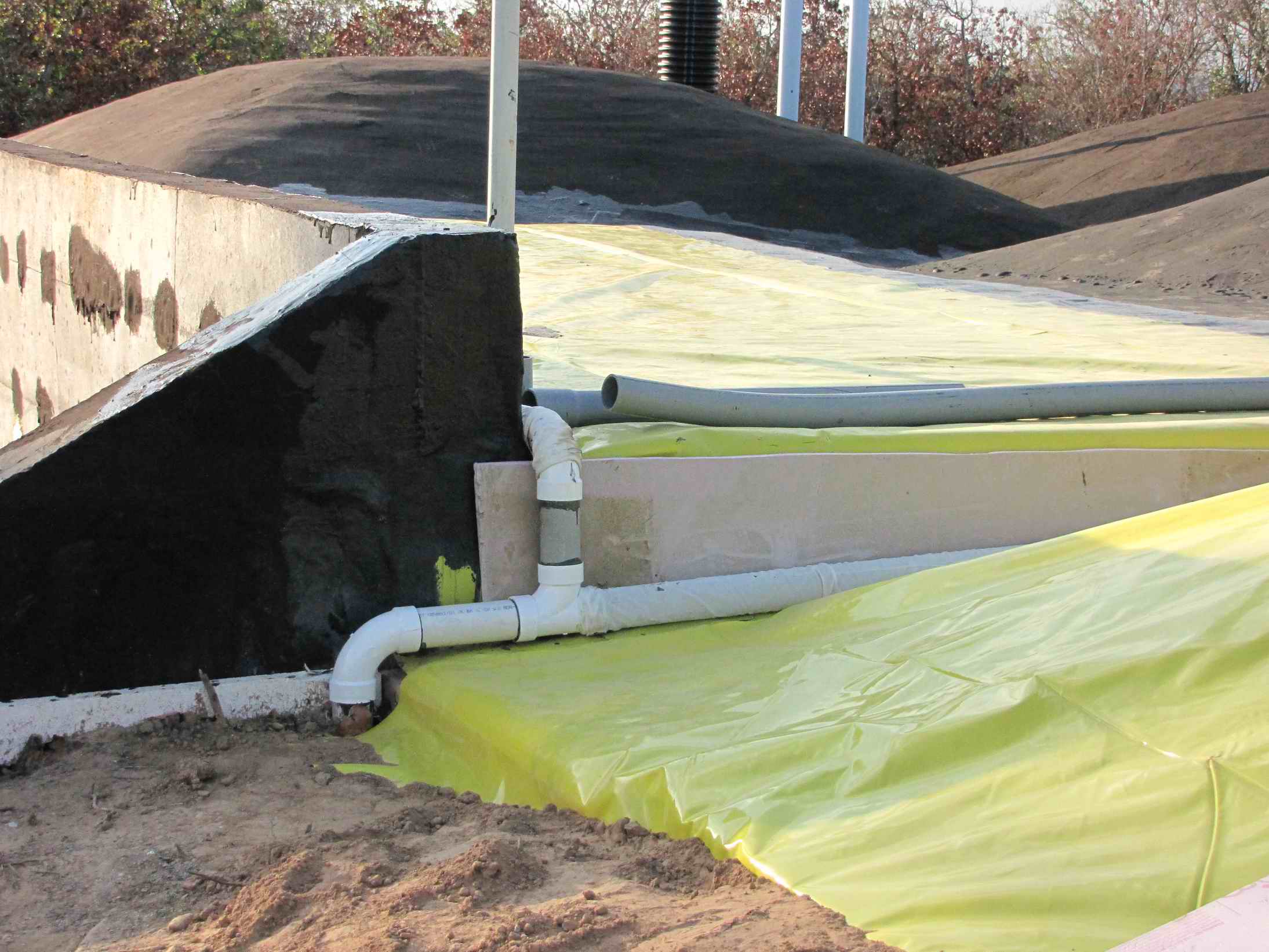

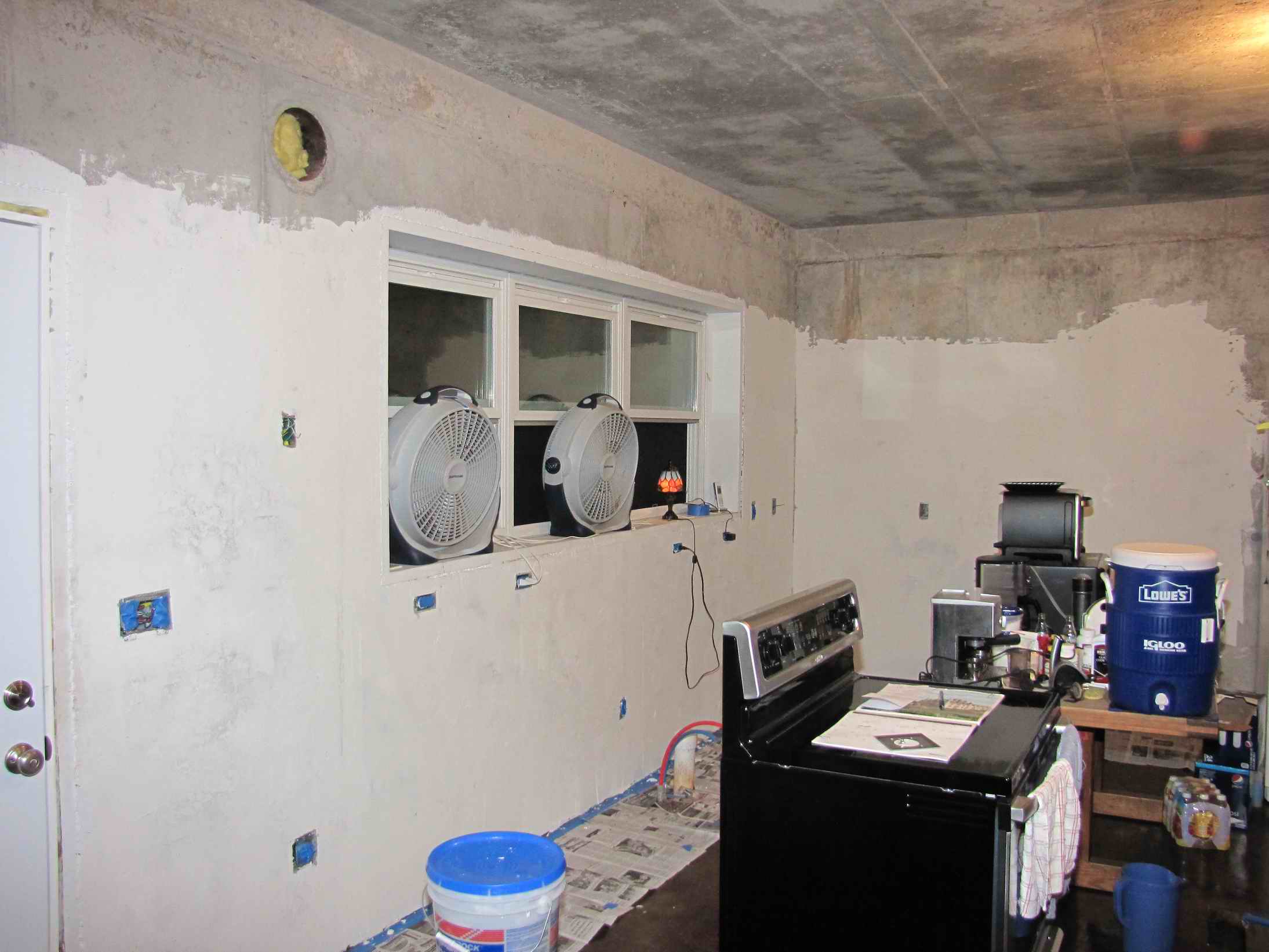

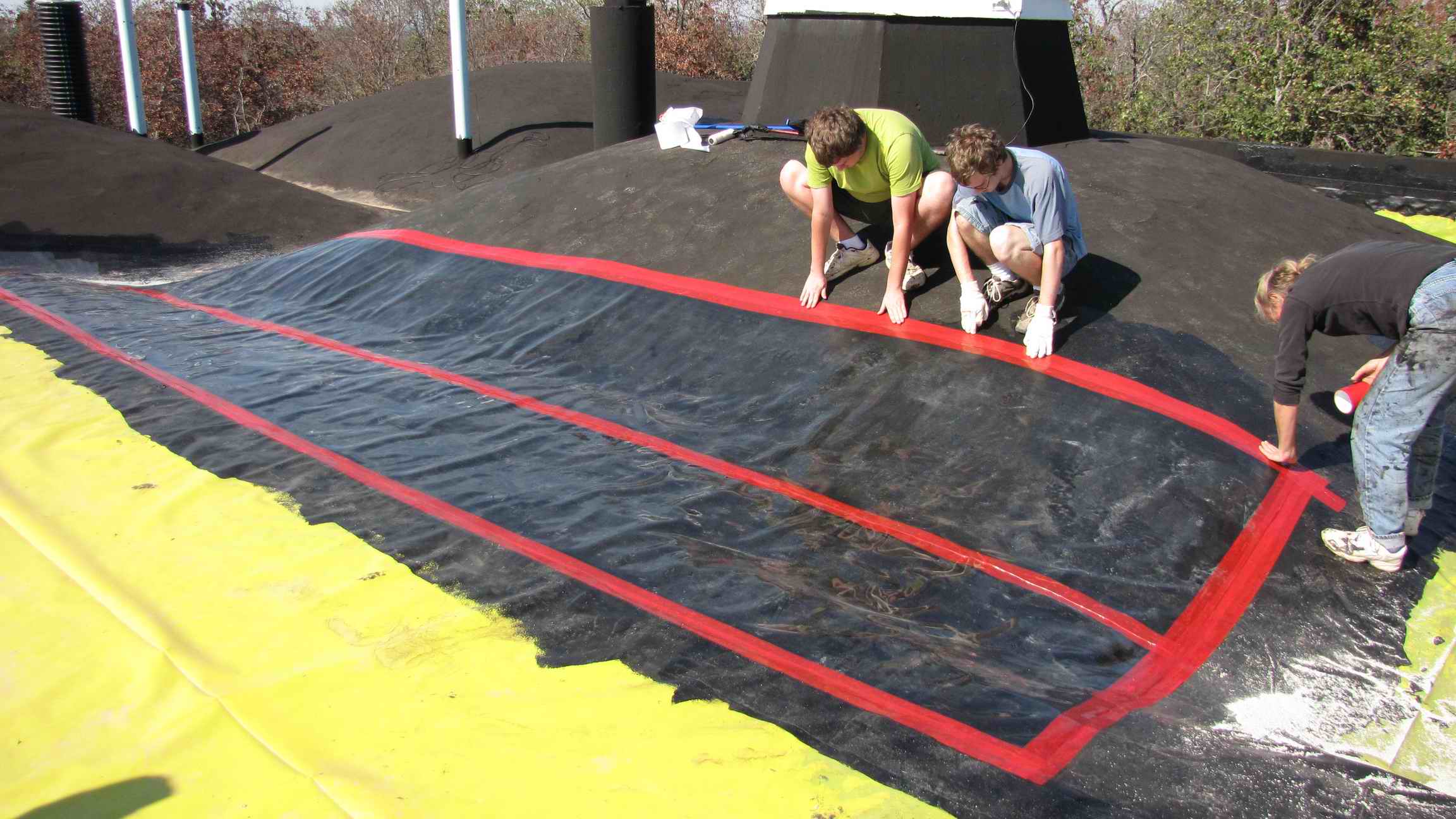

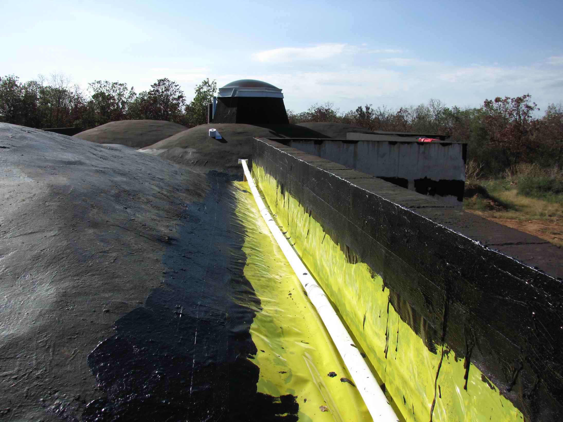

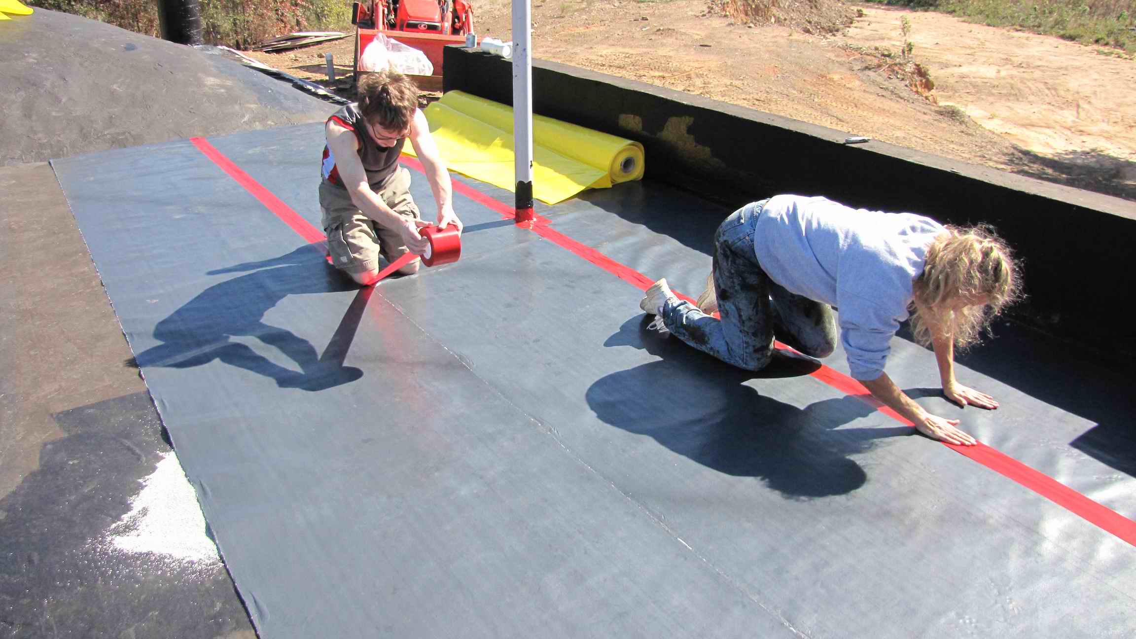

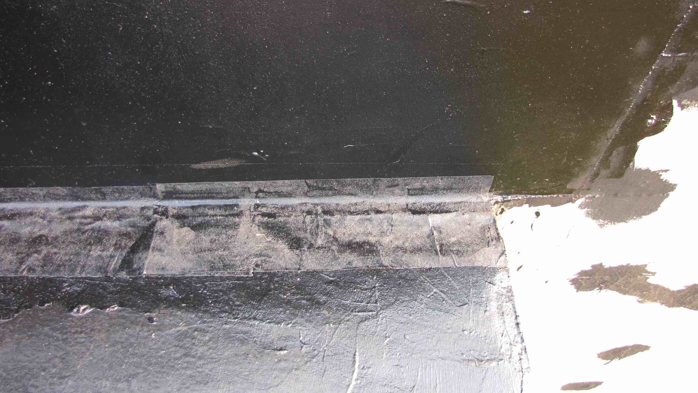

Sam , it`s nice to see you back.....I`v always appreciated your perspective, and enjoyed your work.....I personally live in a more `immediate` weather disruptive area S C coast, and each year try and get prepared for what ever `mother nature` throws our way....That keeps a person thinking.....I don`t worry so much about `gargantuan phenomena` but there really isn`t that much difference :)
Do you have your roof water tight? No leeks? Tony
We are leak free, Thanks

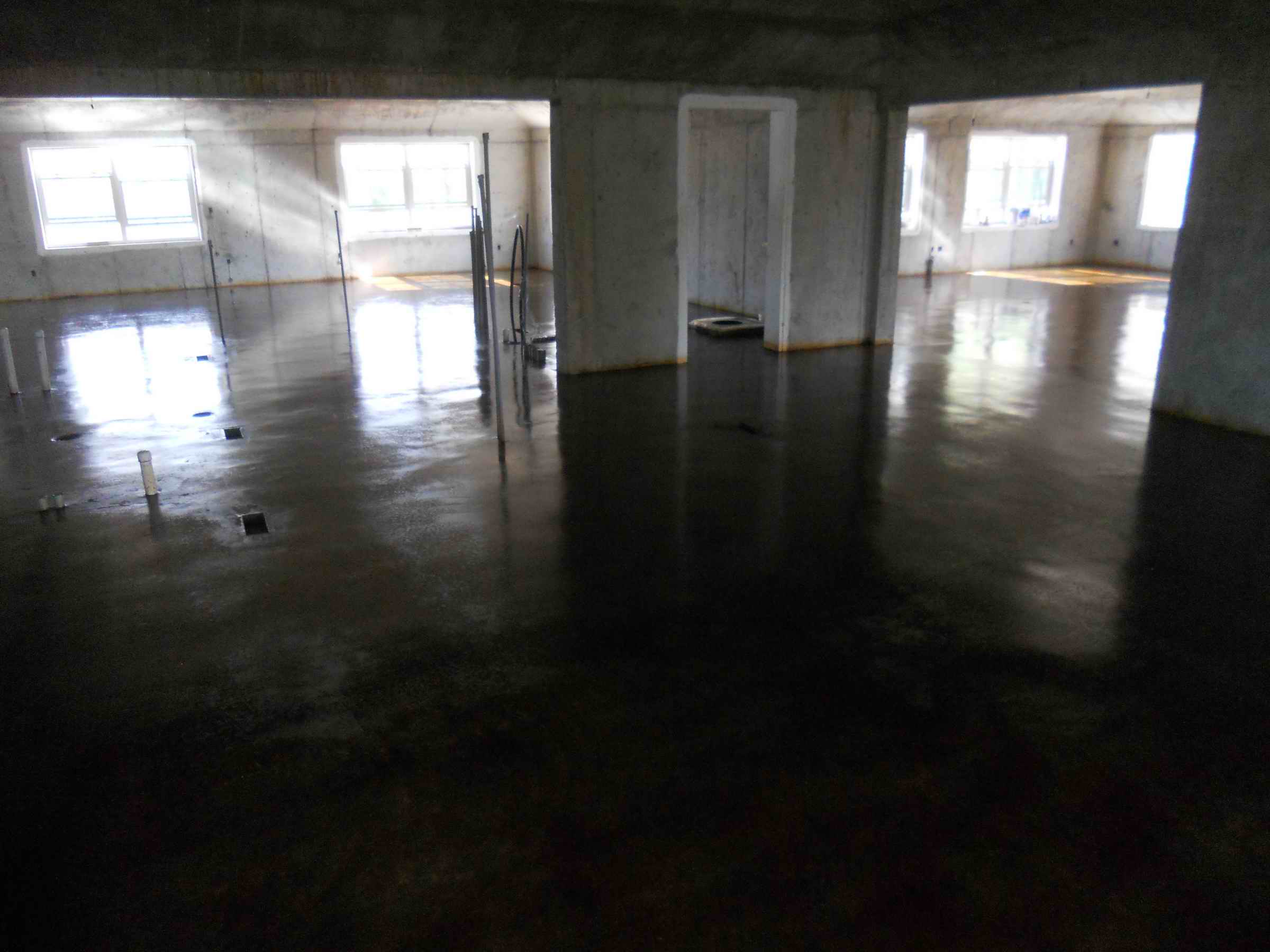

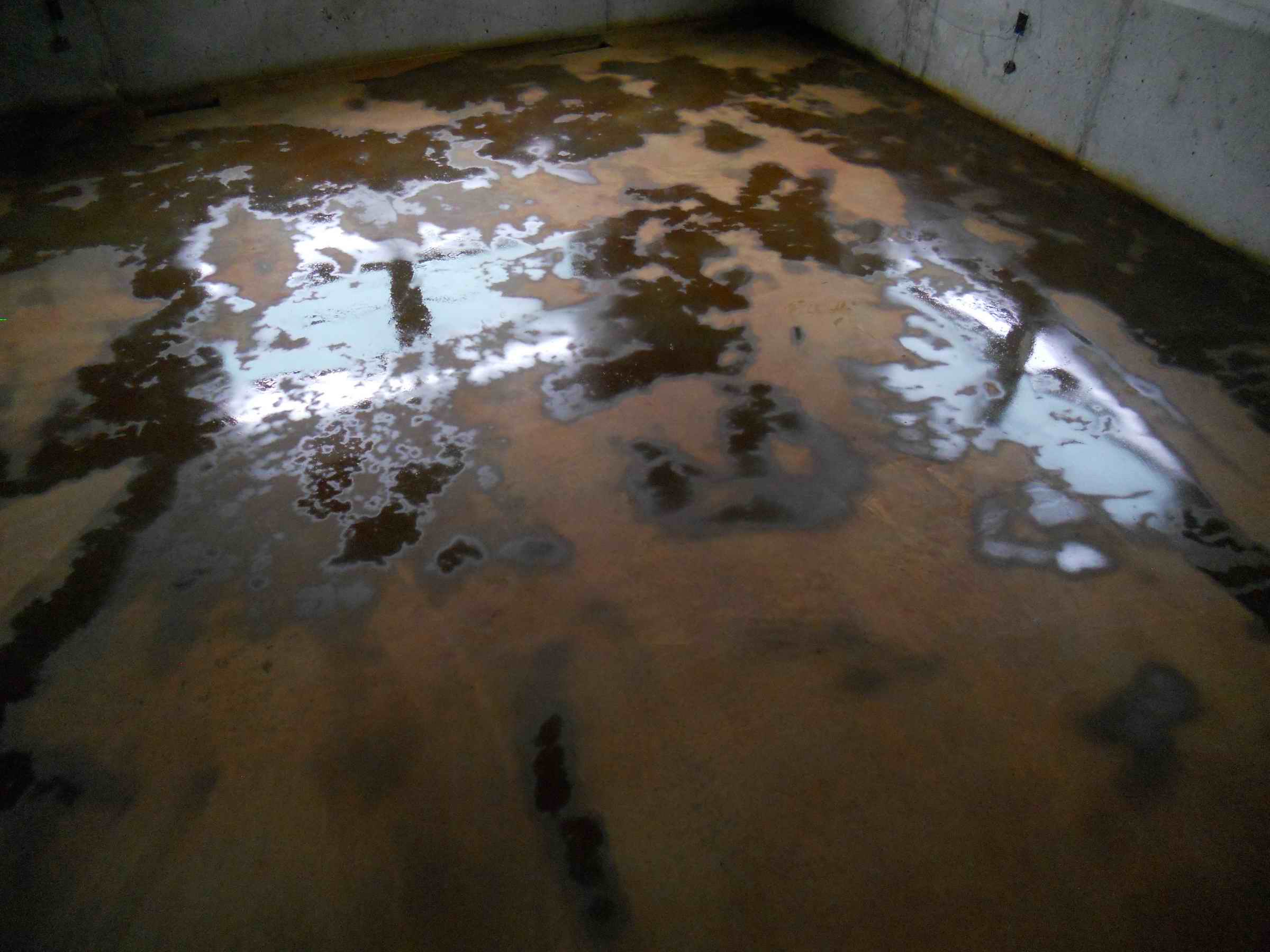

...and finally... Sam,glad to see you posting again. Don't let anyone bother you with any comments. You are doing fine and are to be congratulated for you good work. I hope everything goes smoothly for you in the final finishing efforts. I am personally relieved to hear you won out over the leaks. Leaks are some serious stuff.
I am glad to report that my walkout basement with similar issues to your earth sheltered design is also totally leak free and so dry that covering any part of any wall or floor for a week with Stego Wrap doesn't even turn the surface darker much less show visible condensation. I put down impermeable porcelain tile a few years back with no problems and that IS a moisture test.
A previous winter gave me a small water problem due to ice dams on the 12:12 roof. Just this one time with no repeats but where moisture was dripping THROUGH sheetrock a crack has opened up in the ceiling sheetrock. No big deal to patch and once in several years so I'm not too worried. It sort of contrasts concrete part of the house (master suite is ICF and basement is cast concrete) to the traditional stick built part. Nearly 1/3 of my floorspace is a red iron portion of the house and it too worked out OK.
You have every right to feel a great deal of pride in your accomplishment.

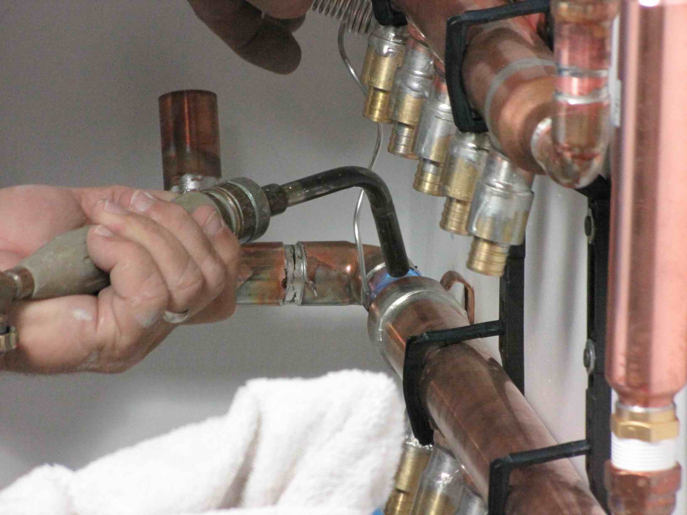

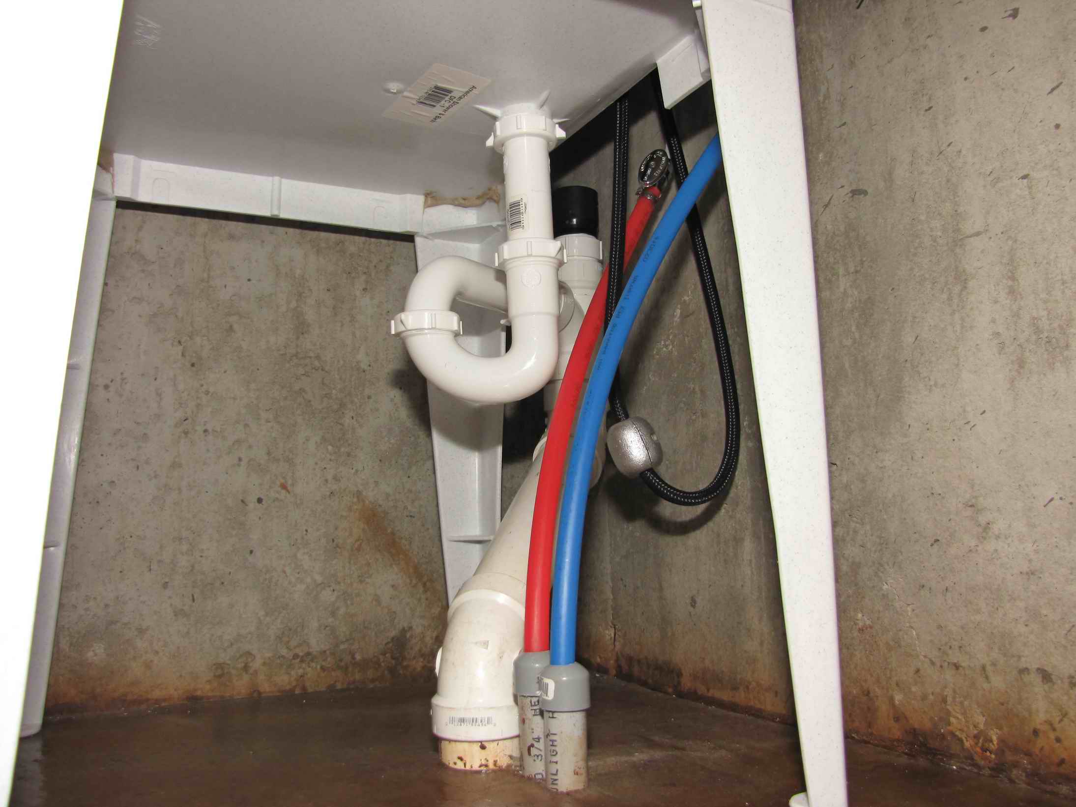

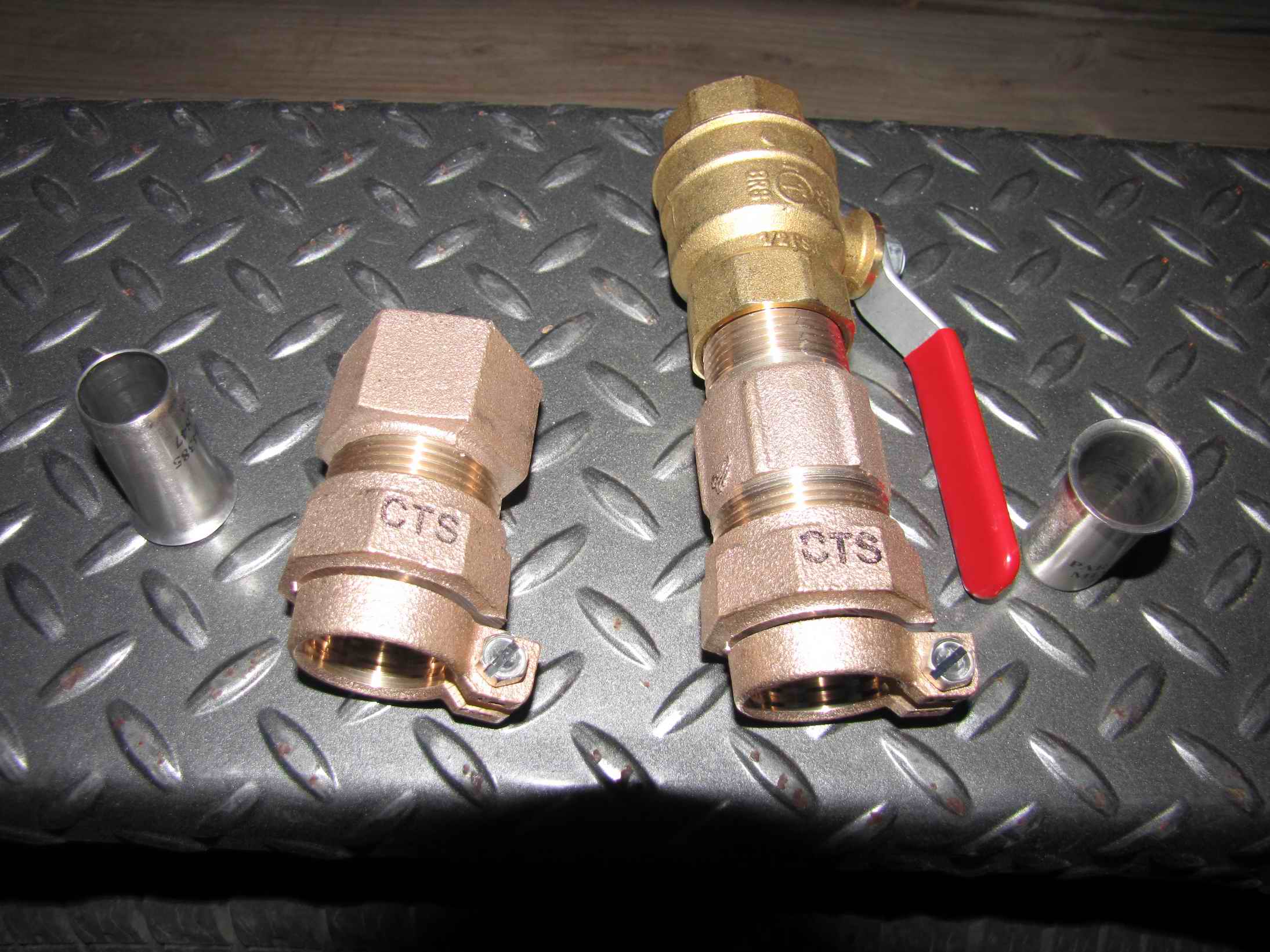

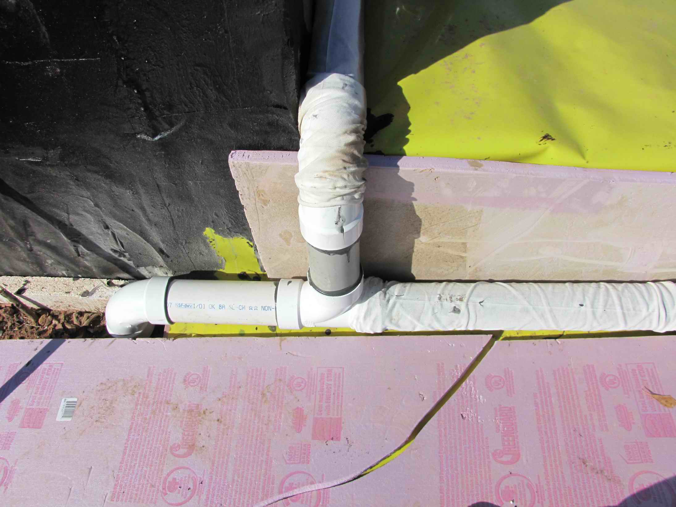

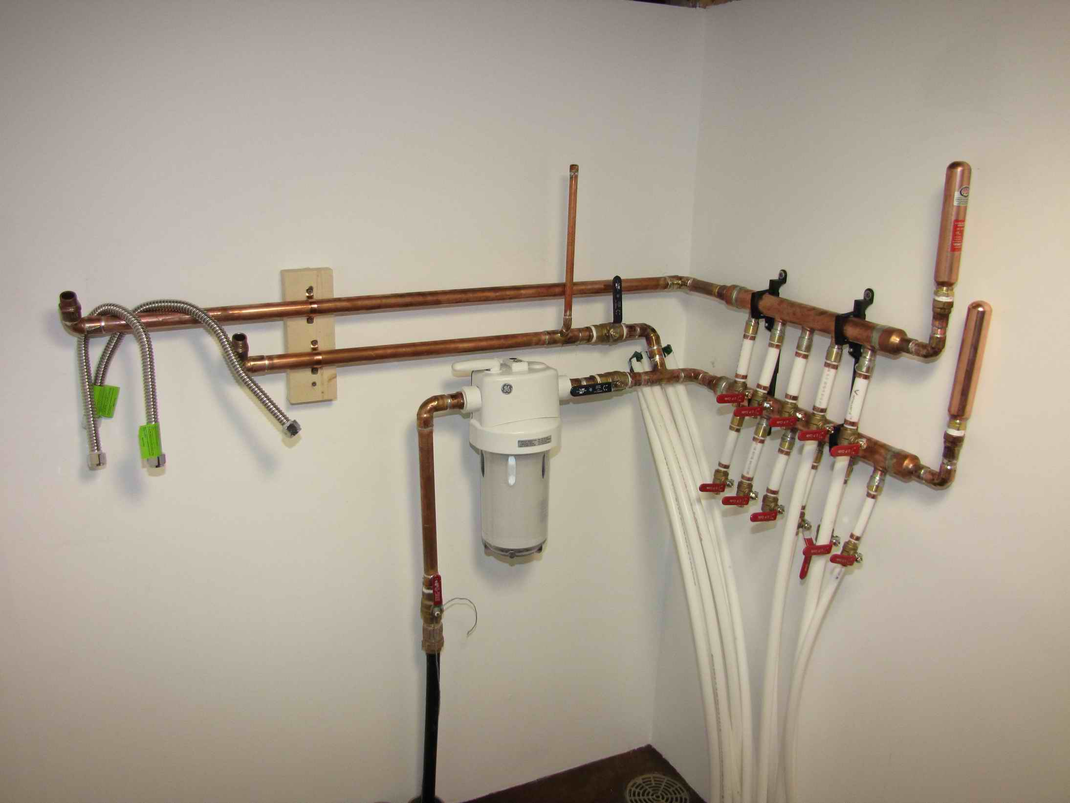

Okay Sam, a couple of questions.
I see a lot of sock material on places like elbows and such. Is this the covering for the drain pipes, or some sort of attempt for the pipe to slip against something?
Why not use more PEX? It would seem easier and cheaper to install (once you've made the pex commitment).
I have used the Shark connectors. Except for valves, they were the same as solder in connectors, but obviously faster. Any drawbacks?
It looks to me like you have applied a lot of your work experience with the CoE. Sounds fun. And nothing like teaching your kids skills, especially thinking and solutions skills. Keeps them thinking of the end point before the start point (sure saves a lot of points that way).
   / Terra-Dome Earth Shelter Build #929
I know Sam's project isn't a democracy but I vote for PEX (UV stabilized or oxygen inhibited where suited) as it lasts for a long long time. I've talked to plumbers about the leak situation of crimp fittings and the general opinion based on experience is that none of them has ever seen a PEX crimp fitting leak that you couldn't visually see it was obviously not installed correctly.
Take for example an elbow. After crimping you can rotate the joint a significant amount and get no leaks. The joint acts like it is O-ring sealed. I don't mean a few degrees of rotation, I mean several revolutions or the equivalent.
Still, this is Sam's project and he can do it however he prefers within his self imposed limits as regards cost, code, etc.
Pat
   / Terra-Dome Earth Shelter Build #930
I saw a PEX union fail once. It was installed wrong. Fortunately, it popped loose before the finish floor went on in my neighbor's new house.
