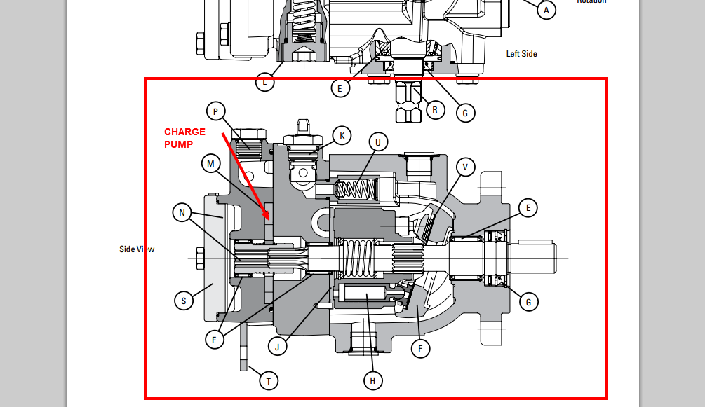

Mar 20, 2013 / terraman51 #1 T terraman51 New member Joined Mar 20, 2013 Messages 3 Location Auburn ,Maine Tractor Terramite T5C John Deere 455 Hello All, would like to know if there is a small auxiliary pump that would run the power steering of t5c terramite, 250 to 300 psi ?

Mar 20, 2013 / terraman51 #2 J_J Super Star Member Joined Sep 6, 2003 Messages 18,973 Location JACKSONVILLE, FL Tractor Power-Trac 1445, KUBOTA B-9200HST Are you sure the pressure is 250 to 300 psi? My Power-Trac uses a pump like this to power the steering and the lift. .75 to 1.0 GPM @3000 psi 250-056 GC GEAR PUMP 0.097 CID DUAL Gear Pumps | Gear Pumps GC Series | Bolt 1/2'' Dia Straight Keyed Shaft x 1 1/2'' Long, Dual Rotation

Mar 21, 2013 / terraman51 Thread Starter #3 OP T terraman51 New member Joined Mar 20, 2013 Messages 3 Location Auburn ,Maine Tractor Terramite T5C John Deere 455 well the main pump "eaton" puts out that kind of pressure, but the section of it that runs the power steering is only 300 psi max.

Mar 21, 2013 / terraman51 #4 J_J Super Star Member Joined Sep 6, 2003 Messages 18,973 Location JACKSONVILLE, FL Tractor Power-Trac 1445, KUBOTA B-9200HST Does your hyd steering use the charge pump pressure? I use an Eaton VSP pump in my Power-Trac, and the charge pump puts out about 350 psi. Last edited: Mar 21, 2013

Mar 21, 2013 / terraman51 Thread Starter #5 OP T terraman51 New member Joined Mar 20, 2013 Messages 3 Location Auburn ,Maine Tractor Terramite T5C John Deere 455 sorry,I do not know what that is.
Mar 21, 2013 / terraman51 #6 J_J Super Star Member Joined Sep 6, 2003 Messages 18,973 Location JACKSONVILLE, FL Tractor Power-Trac 1445, KUBOTA B-9200HST If you have a variable speed pump, you probably have a charge pump. The charge pump is the only low pressure element associated with a variable speed pump that I know of. The charge pump could be internal or external. Here is a pic of my charge pump. M or red arrow Attachments EATON vsp pump.png 135.5 KB · Views: 122
