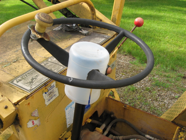

I think I will have to work with the "bubba" alternative.....but I believe the oil is leaking from under the steering wheel....not overflowing where the nut is... I appreciate all the detail and will print this for my son to check out. I will keep an eye on the level of oil but it seems to be a small amount. My cables are hard to pull and the throttle knob is broken. Otherwise, the machine is working fine. The Honda engine had some work done on it by the guy that sold it to me and I had a new starter put on last week.

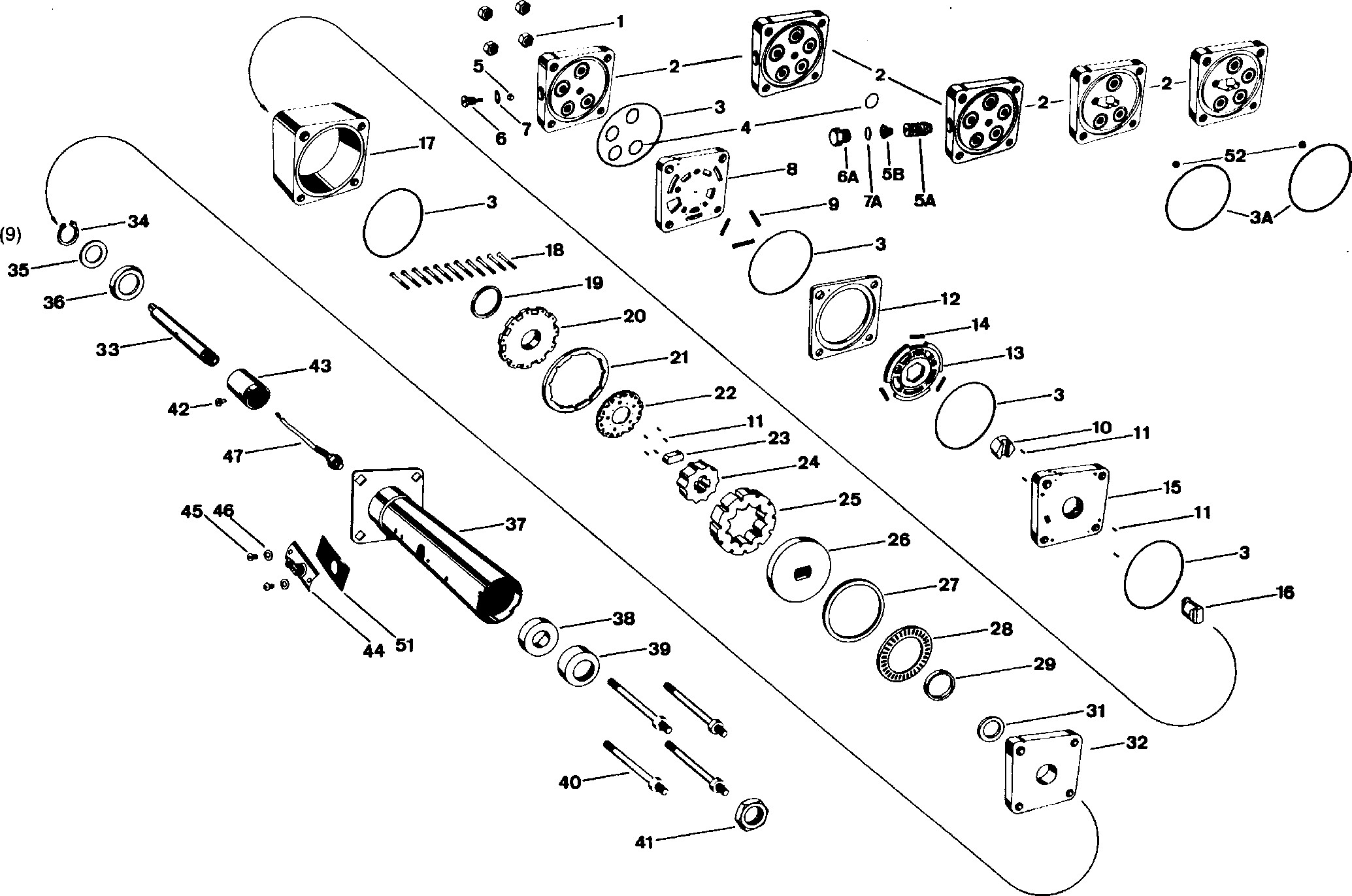

Jannige, IF you have the offset column, see if the shaft has some play in it. It shouldn't. #38 is the bushing that fails if #39 (seal) doesn't protect it. A rusty shaft will hog out the bushing & the top seal will go after that. There should be no oil in the column. #29 is the 'face seal' that leaks & allows the outer tube to fill with oil and leak out the top. I only have the issue during long sessions with a lot of steering to position, or a long drive to a job in the nabe.
Here is what water can do if it leaks past the top seal & freezes. (the bulge)
Here is the 'bubba' column shield that keeps water out of the column & hopefully from making things worse.
