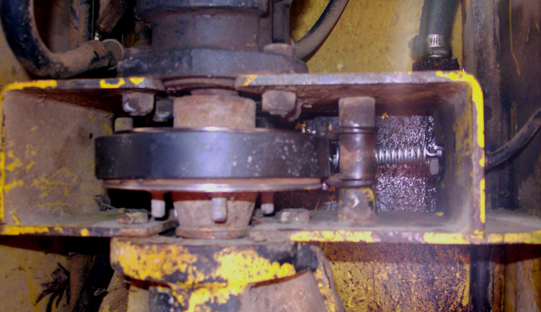

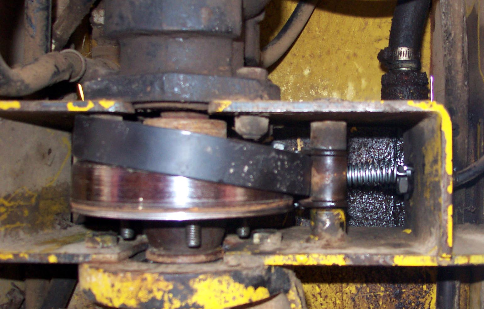

Wow, this thread spans a lot of time, but if you Terramite guys are still around I still have a problem with my 96 T5Cs brakes. I bought new parts from Terramite and sent them this email back in 2007:
"I've spent two days trying to install the new brake band I purchased from you and am a bit frustrated by the experience. I used the updated spring and spring bracket (a real PITA to get in place) and thought all would be well once I finally got everything tightened in place, but the drum is offset to the rear from the pivot mount for the band and the brake band simply slides forward off the rounded edge of the drum. Inspecting the old band I suspect it did the same thing, perhaps from new, and it eventually wore off the cable attachment end.
I was going to try removing 1/4" from the face of the permanent part of the band lower pivot so I could move the band back to better align with the drum, but it was too hard for a saw blade and the area too cramped to get a grinder in. Then I thought I might shift the drum forward by removing the four bolts and placing spacers between the drum and the flange, but I could not get the drum to move even with the bolts removed. It also appears the drum may be the driving member between the hydraulic motor and the differential flange; is it?
This looks like a day one deviation with the drum offset from the band mounting resulting in the band slipping forward off the drum, and there does not seem to be any method to adjust either to get the band aligned with the drum. I called the parts department yesterday to ask if the drum was originally rounded like that or if it might have worn that way, and the fellow said it was originally rounded and has now been superseded by a welded drum.
I really want to have the safety factor of a brake in case of power loss and for parking, but I've had to remove the band again since it just won't stay in place. Please advise what I can do to get this brake to work, I've exhausted my ideas. Below are pictures of the band as installed and as it is tightened and slips off the drum."
I never heard back from this 2007 email or from a followup I sent in 2010. Any suggestions on how to get working brakes on this machine?
