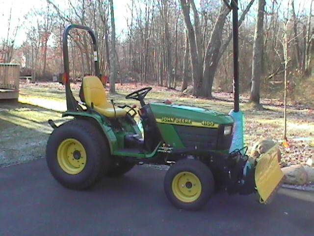

Bob, you may have something there. I will check my tires and see where they are, but boy are they bouncy. I rolled over a flat rock sticking out about 3 - 4 inches and it seemed that the tractor bounced up into the air a little and I was only going no more than 4 - 5 miles/hour. Kinda surprised me. Here is a picture of my unit from today.

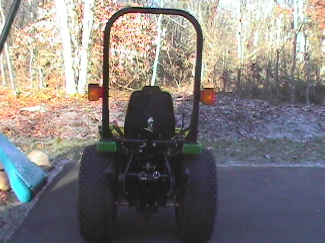

Pic 2 of my unit

Since you have some slopes to deal with I would recommend the mid-mount mower. John Deere mower decks are designed to be operated suspended from the tractor with the wheels barely contacting the grass. The wheels and rollers on the mower do not carry substantial weight unless the mower is on uneven terrain. The net effect is that the suspended deck lowers the total system center of gravity and also adds weight to all of the tractor wheels thus enhancing stabiltiy and traction on side slopes. With a rear-mount deck you do not get these important effects. These decks work well if you have relatively level terrain and a lot of open space to mow. It is also easier to trim around trees, bushes, and along buildings with a mid-mount deck. Installation and removal of a JD mid-mount deck is very easy and fast. It helps to do this on a paved surface.
As to the tire inflation pressures, it is typical for tractors of all sizes to be shipped with around 30-35 psi in the tires. This makes them very stiff and is done so that when the tractor is tied down on a truck or trailer for transport, it will not bounce thus keeping the chains or straps tight. The dealer is supposed to reduce the 30 psi to whatever pressure is required for normal operations. In many cases, they neglect to do this. Refer to your 4100 operators manual for specifics, but I would expect the front turf tires need about 12 psi and the rears about 10 psi for mowing and the blade you show in the photos. If you attach a loader and ballast, the pressures would need to be higher.
