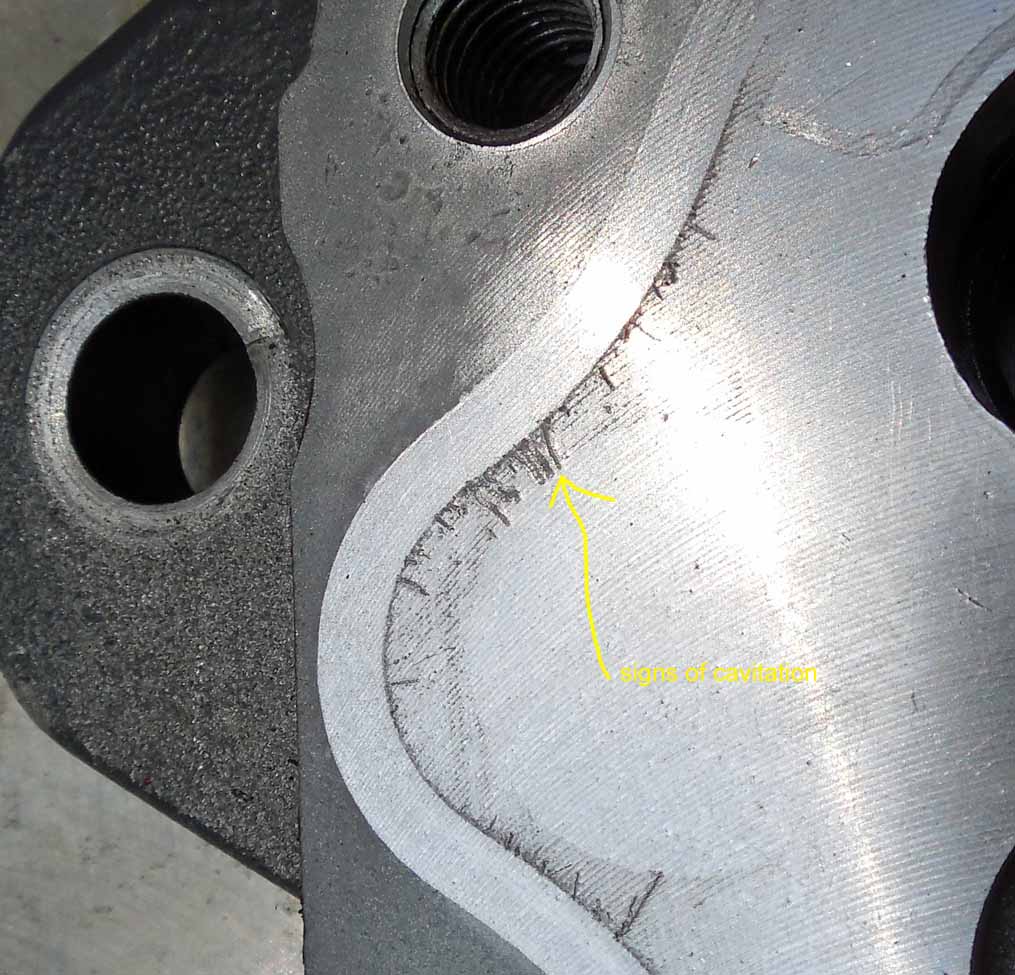

I got the used pump today and it's a little dirty on the outside (expected), no biggie. Can I completely open the pump and inspect it, or will I need to buy new seals once I crack it? I would like to look inside of it before installing it.
I would open it up to see if it is clean inside. Used pumps may not have been protected from
dirt getting into the open ports. You can see if it is damaged inside by dirty fluid: look for
scoring. Furthermore, cavitation damage and bad seals may be visible (photo).
I tend not to trust used hyd pumps, motors, valves.

What caused the marks in your provided pic? I want to open it but the only thing I need to know is will I need to new seals that I might not be able to replace, then I would still need another pump.
After talking to a couple facilities here about getting my pump tested they will all open the pump and visually inspect the condition of the pump and to verify there is nothing in the pump that could damage their equipment.
I personally would like to open it and take measurements, see how it works, and stuff like that. I was the kid that took about the drill to see how it worked.
My theory on the failure was the user was operating tractor on relief for an extended period
and overheated the fluid.
