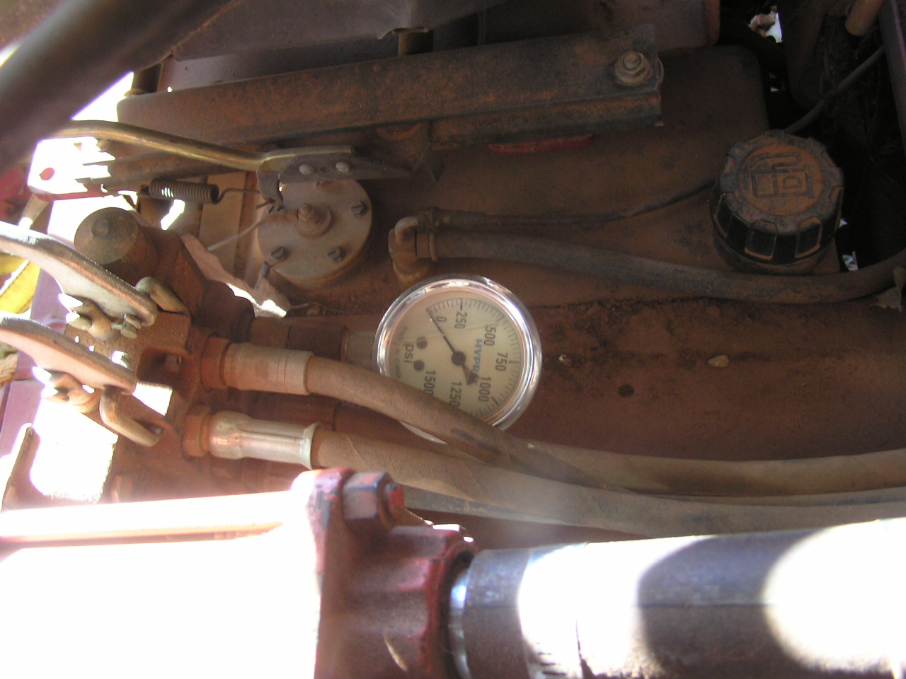

On the TORO+Loader, I put a gauge on the control valve. It is in the the pressure in port from the pump.
Shows the pressure in lift or curl when in use.
Visible from the seat.
