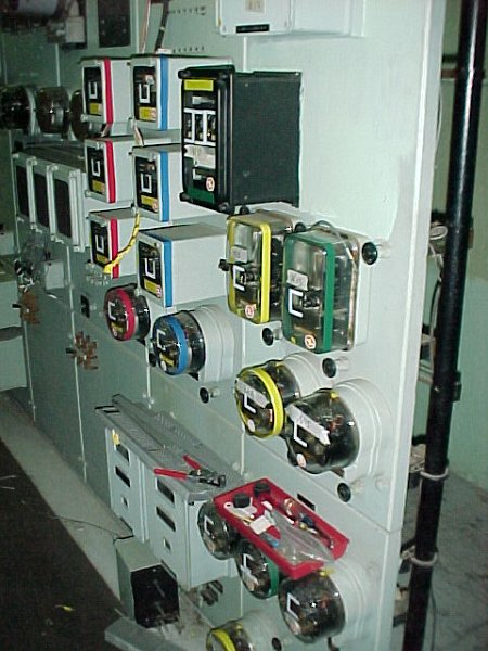

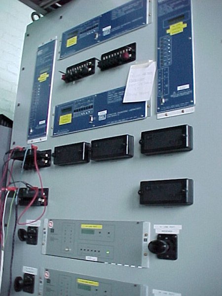

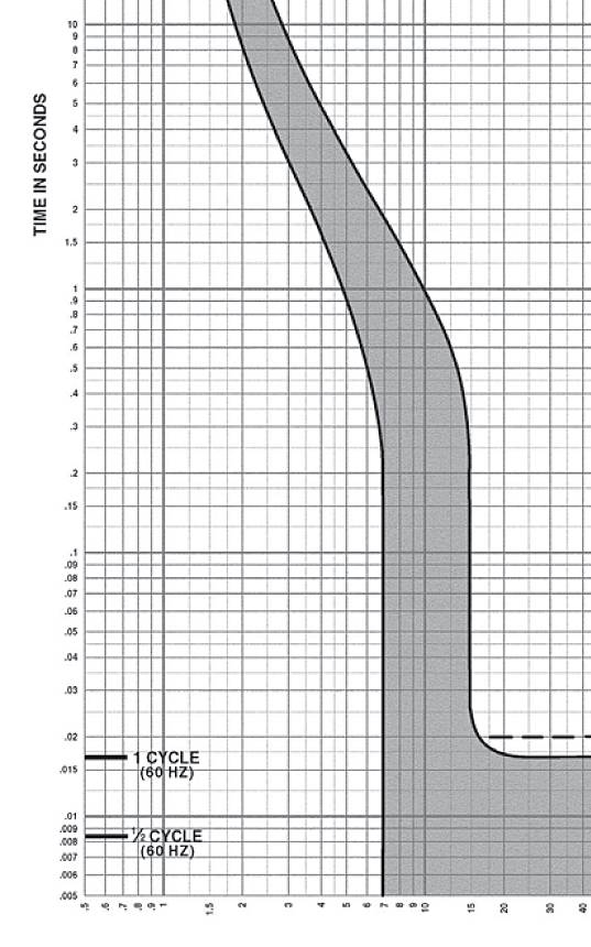

Post a chart with the response curve of a typical consumer grade breaker. The P fuse and even a D fuse will be gone long before the breaker responds. I used to setup protective relays and test breakers for a living.
   / Testing elec breaker to verify trip #18
I believe we have similar backgrounds :) Time curve for Square D QO 15 amp breaker attached.

   / Testing elec breaker to verify trip #20
It's a thermal-magnetic breaker. Two distinct protective functions.
Testing the thermal trip aspects of the breaker by applying an overload condition (hair dryer, etc..) does nothing to test the (magnetic) short-circuit overcurrent protection function of the breaker. It is this function that failed. Not the thermal function.
