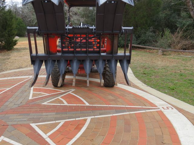

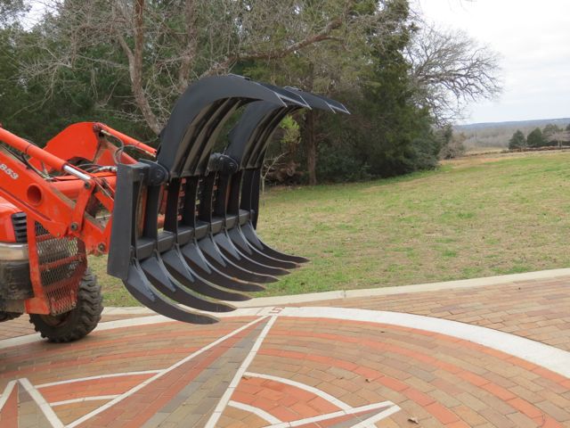

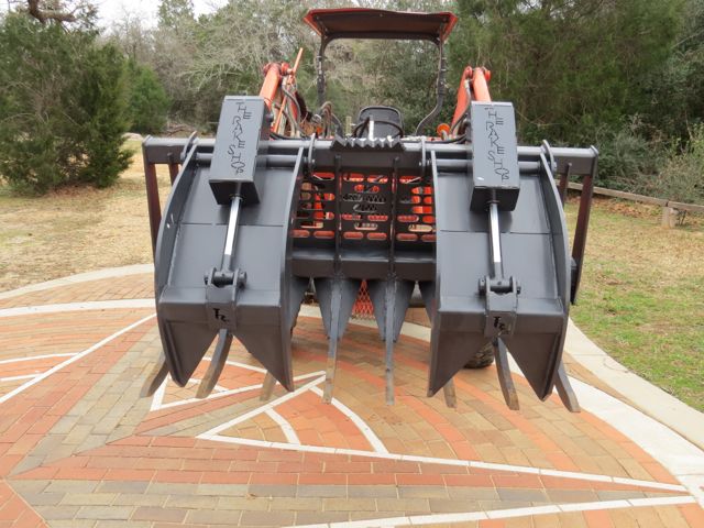

Got Grapple!
It's from TheRakeShop.com
Light class grapple (plus)
60"
bottom teeth 1" thick with 6.5" spacing
Open 41.5"
Shipping weight 700#

Grapple pictures.

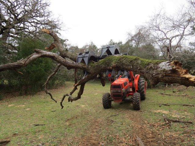

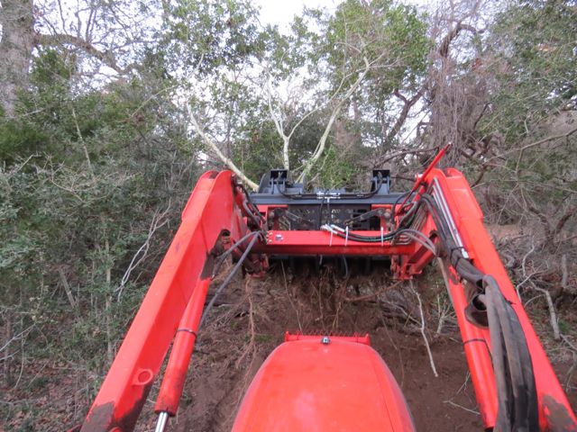

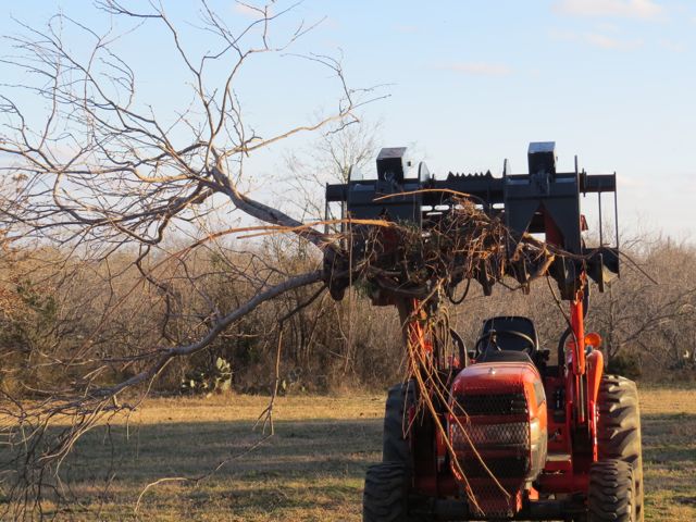

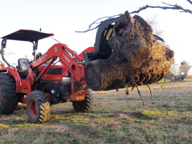

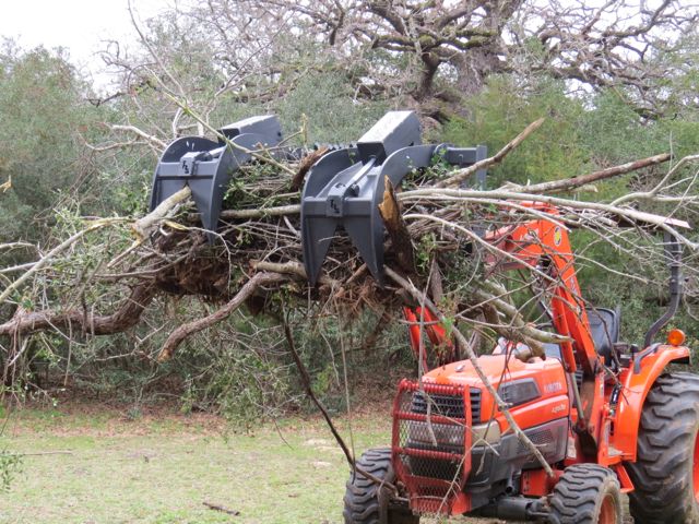

Action Pictures.
The grapple does everything I bought it for.
The Grapple comes with 9" spacing but I had them put in an extra tooth in to get the 6.5" spacing.
The lack of a cross bar and the curved bottom teeth are an advantage for me to get deep and lever out small trees and Youpon bushes
One thing I did not buy it for is mesquite, but as you can see in the third picture it pulls them up by the roots.
