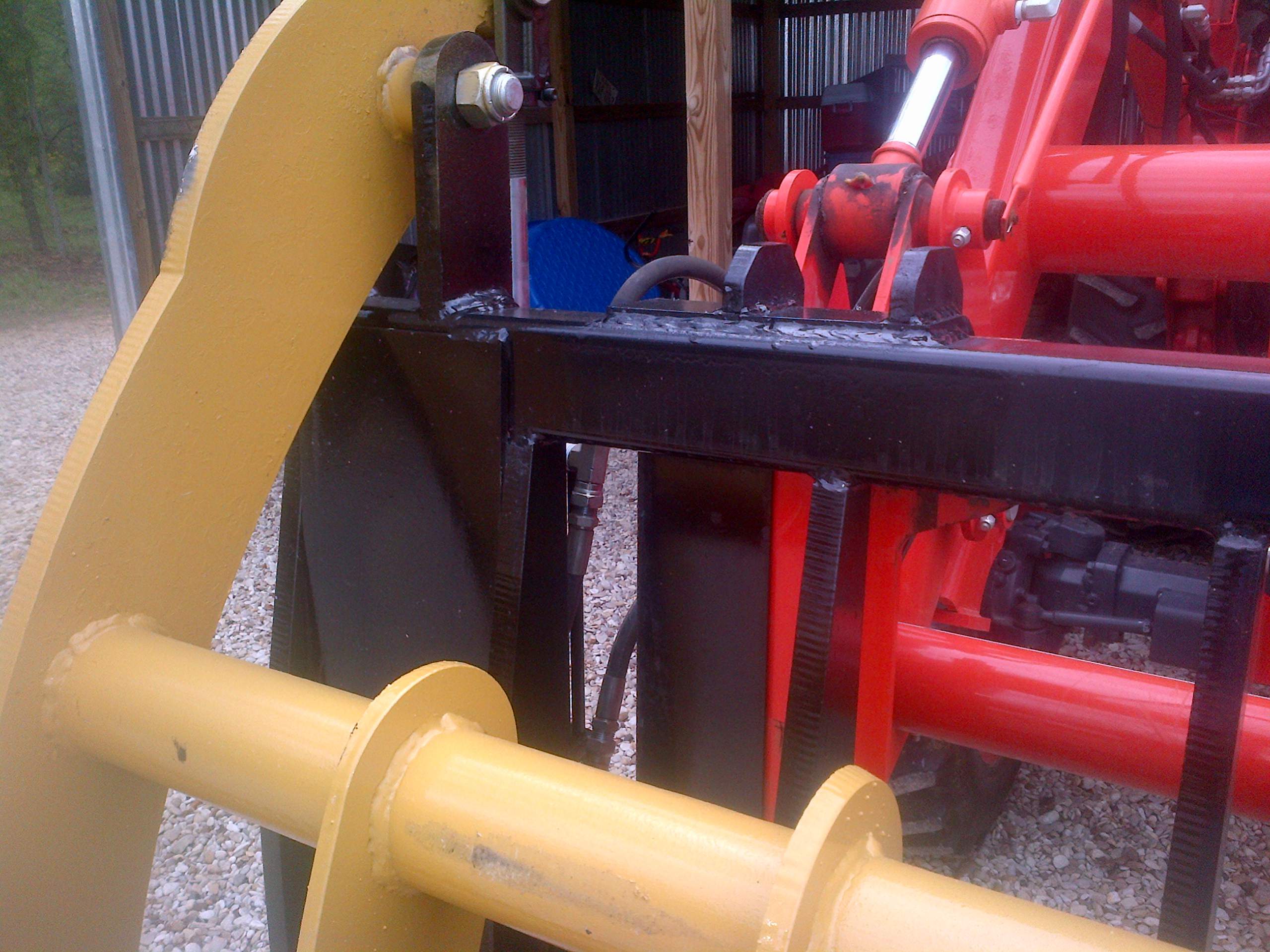

They did not respond right away to my e-mails also, which made me a little worried about them but they came through. They do answer the phone (90% of the time) and after I talked with them they sent some e-mails of their current models, the ones with the slotted backs to protect the tractor. Once we got the specifics finalized they only took about a week and a half build it and ship it. The total cost with the extra tooth and 1" solid teeth was $2500. Shipping from Florida to my front gate in Texas was $200.
I was comparing it to the Faver which would have been about $800 more total and 8 weeks later and bottom teeth further apart. Faver does not do custom work.
Skid Steer Grapple | Faver
One benefit I found was the way the back of the teeth supports form a "V" to really help grab those stubborn trees and bushes. I was initially concerned that limbs and trees would get stuck there but so far everything has fallen out of the "V"s easily when I dump it.

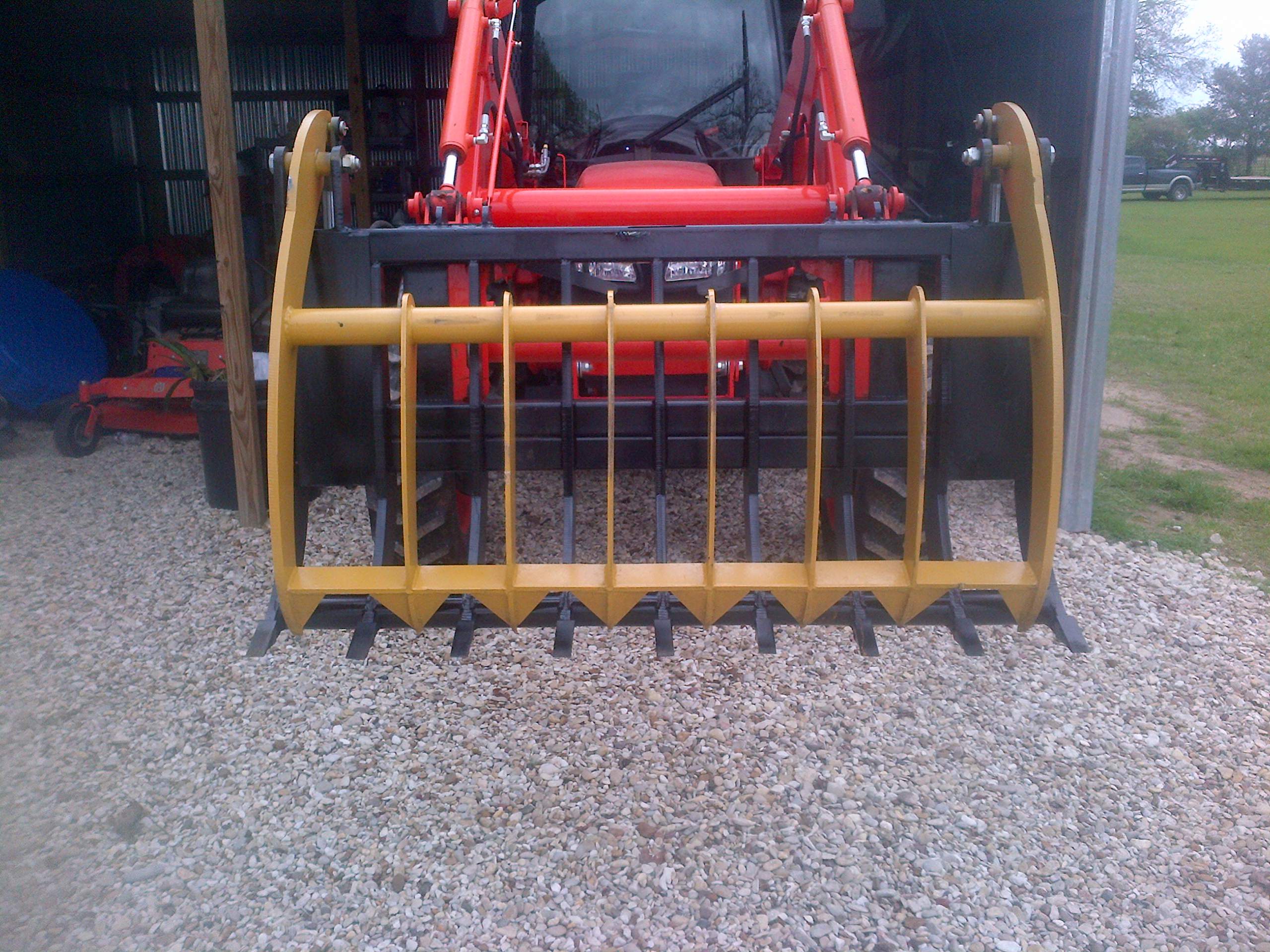

Got Grapple!
It's from TheRakeShop.com
Light class grapple (plus)
60"
bottom teeth 1" thick with 6.5" spacing
Open 41.5"
Shipping weight 700#
Looks great! And if this is what they call "light" duty, I'd like to see their heavy duty ones.

Mark02tj, The bucket on my tractor is 72" but I wanted something that would just about cover the front tires (63") and the 60" seems to feel about right on this size tractor. If you go with something smaller a single lid would be OK. I have mixed feeling on a single or double lid. I did notice that on some loads one lid would close down lower securing the load tighter. When pulling the brush out it was about 50/50 if the bush was in the middle or toward one end on the first swipe but subsequent sweeps to widen the path the side jaws were better. I think with a 35hp tractor - unless changed - he will use 3/4" bottom teeth to reduce the weight.
For dead limbs and trees any grapple will be good. I especially wanted this particular one to do that and be able to easily dig deep to pop up roots. The curved teeth without the crossbar sink into the ground just as I imagined they would. I drive forward and tilt the grapple back slowly to take advantage of the curl.
The live brush/small trees are taken out in one of three ways with this grapple: 1. The teeth pop the roots out. 2. The jaws clampdown and I pull the bush/small tree out. 3. The "V" at the back of the teeth traps the stems and I push them out.
