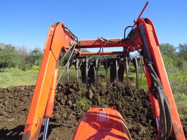

Today I used my Grapple rake to rake. It worked perfect in breaking up some hard black gumbo. My bucket could not get through this stuff but the grapple sliced it up like butter.
Rake Shop grapple? Looks like it works perfectly.

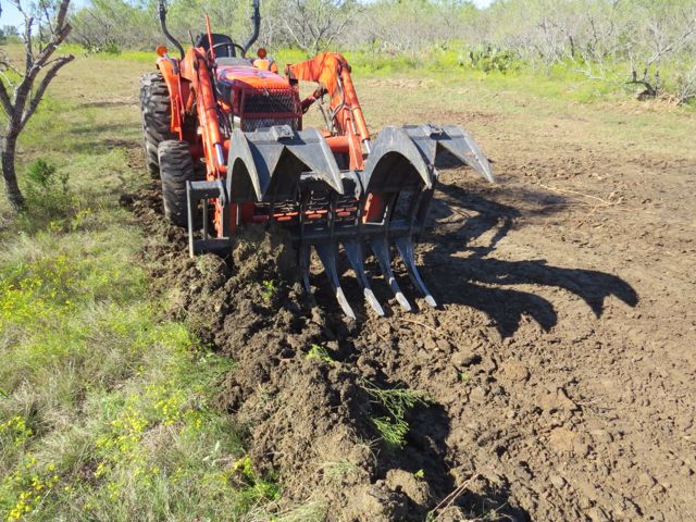

Yes this is The Rake Shop grapple.
It is 50" wide at the teeth and the back is 61".
My Kubota 50hp front tires are also at 61" so it's all good.
I also like the fact that it is not as wide as my 72" bucket especially when I'm removing cedar trees in the woods, like this trail I just finished.
