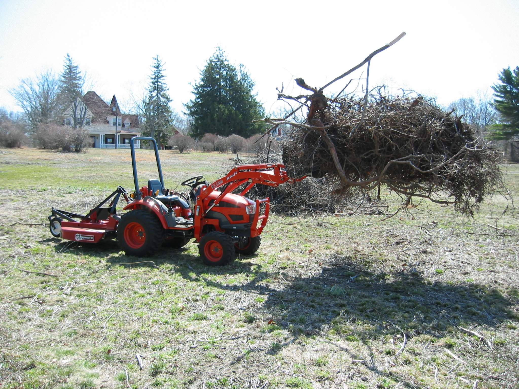

Comparing a tractor loader mounted grapple to an excavator with a grapple is not a good comparison. They are too different, they work differently.
With a narrow grapple if you are pushing brush into a pile the brush is going to come around the grapple and in to the tractor. It has even happened a couple times with my 72'' grapple. How many times have you been trying to dig out a root and hit another root with the grapple? Probably not very many. The extra force you are able to exert with a 48'' in most situations is not going to be much different than a larger grapple. I would have saved a 84lbs by going with a small grapple. That is not going to make or break me with a tractor the size of the 4240.
You still have not answered my original question and now your have gone further with it. You had your grapple on a Ck20 and now it is on the DK40 but some people have used it on a M59 (which is a beast of a tractor). It looks like to me it would have been too much grapple for the CK20 or not enough for the DK40 or M59. You are covering a really wide range of tractors don't your think? The Kubtoa L4240 and larger weighs more than a DK40 as does the Mahindra 4035 and 5035. The JD 4520 and Mahindra 5035 lift more on paper. There was recently a guy that had a 4520 and got a Kubota L5740 and said it would lift a pallet of lime and the Deere wouldn't. "You cannot break a grapple if you use it properly. Don't twist it. That is how to break any grapple with any size tractor." If you can twist the grapple it is too light duty for your machine.

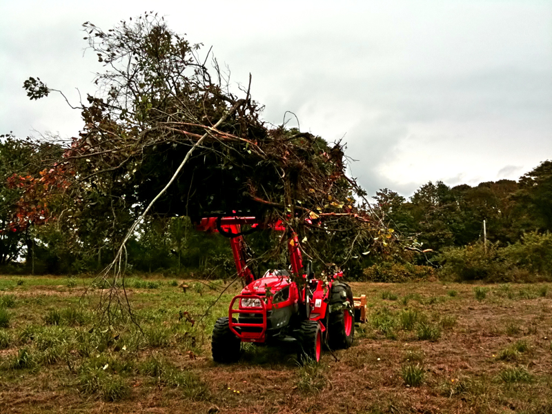

Not only is the number of tines on the grapple important but the width of the tine and the design of the tine is important. The tines on my grapple are probably narrower than the tines on your grapple. They are also sharp. My grapple is a EA wicked grapple.
1) Excavators use narrow grapples and do a perfectly fine job of moving large trees and rocks etc. I certainly agree we don't compare excavators to CUTs but the point is that a narrow grapple can grasp just about anything and certainly can grasp anything that a wider grapple can clamp on to.
2) In a perfect world where brush was exactly a certain density and uniform, it is certainly conceivable that a wider grapple could be more efficient at plowing through the brush and then clamping on a load. In the real world, there are often bigger sized bushes that require either working around or focusing on to uproot and a wider grapple is more of a disadvantage in that setting. Much is said about how a grapple as wide as the tractor will prevent brush from scraping along the tractor. I find with a 48" grapple and a roughly 68" wide tractor, that the ten inches on either side are almost never touched by brush. The reason is that the grapple sort of plows a "bow wave" ahead of the tractor and pulls out a lot of brush from either side. I have moved acres and acres of brush (in my case mostly brambles and wild blueberries or similar sized (6-8ft tall and wide and closely spaced) brush without issue. My technique is generally simply to open the grapple, put the tines an inch or two in the ground and drive forward in 4wd low until I lose traction. I then clamp and back out. Sometimes I will open and repeat the cycle with another bush before dumping the load just by compressing more into the grapple. In my neck of the woods, with a wider grapple I would be hitting those bushes off center and that is not good for the grapple or FEL. I can easily load enough into the grapple that I cannot see around it but the load is secure. Our brush is dense enough that I am almost never driving the full length of the tractor into the brush before filling the grapple. The combination of the "bow wave" and driving only ten or twelve feet forward each time means that no brush really touches the tractor even with a narrow grapple. If I were only clearing blackberries, which are easy to uproot, it is possible that I'd find a wider grapple more efficient but my brush is generally bigger so the narrower grapple works very well.
3) Agree that spacing between tines is important. I really like the idea of the removable intermediate tines on the EA small grapple. You really only need narrow spacing when dealing with rocks or firewood, otherwise wider (9-10") spacing is preferred IMO.
4) 85lbs extra isn't much but that 85lbs is far forward on the tractor so does cut your lift capacity at pivot pins by more than that. It also negates some of your rear ballast for traction purposes. Again, 85lbs isn't much but many guys are buying 72" grapples that weigh 200+lbs more than a light duty 48" grapple like mine. That has got to have an impact on performance.
5) The only way to really damage a grapple and FEL doing this sort of work is by A) shock loads from "bulldozing" or B) asymmetric loads. A wider grapple increases the odds of an asymmetric push against an unseen stump or rock and magnifies the torque such an event has on the FEL. I appreciate that grapples are pretty tough but there is no denying the physics and wider grapples are simply more vulnerable to damaging impacts.
6) I have yet to see anyone on TBN who bought a 48" grapple complain that they wished they'd bought a wider, heavier or more expensive grapple. A 48-50" size made in 3/8 mild steel with 1/4" frame tubing seems to stand up well even to the forces an M59 can exert so I think it is an optimal size for most purposes. Again, if I was cleaning up construction debris, I'd want wider but for brush/tree removal and transport is seems perfect.

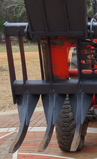

Another thing to consider when buying a raking long tine grapple is wether the outside tines are supported on both sides at the rear. These are the tines most likely to bend if not supported equally like the rest of the tines. This does not apply to the grapples with tines that have a crossmember towards the front for support and that limits depth.

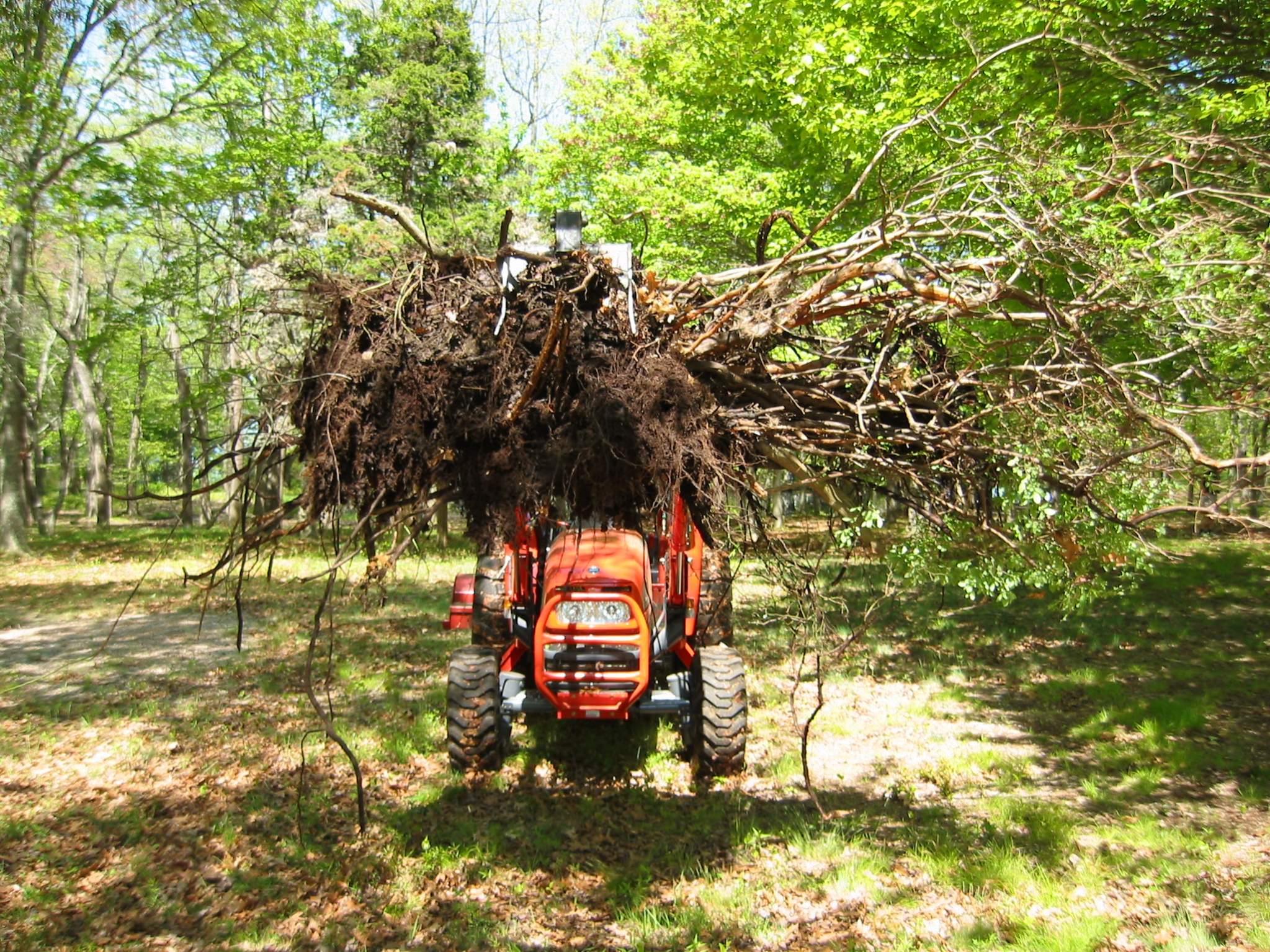

The smaller front grapple is perfect for digging cedar trees or other shallow root trees. You can push them forward, pop them out of the ground, grab and haul away. It is the easiest and I could not be as fast with my loader (with teeth) OR MY BACKHOE. For a Larger tree (cedar larger than 8-10") the backhoe gets the job.
When I was considering which grapple and which size to buy, I was thinking of what I expected it to accomplish and I hit my goal on this grapple. My first grapple was a 72" bobcat bucket grapple and the tines were not long enough and it picked up too much sand for the jobs I needed it to do.
I'm doing the same thing with my stump grapple on my 50hp tractor and the backhoe on my BX23. For the cedars that are too big to push over with the bigger tractor, I just dig up some of the lateral roots with the backhoe and can then push the tree over with the bigger tractor and haul it away with the stump grapple.
