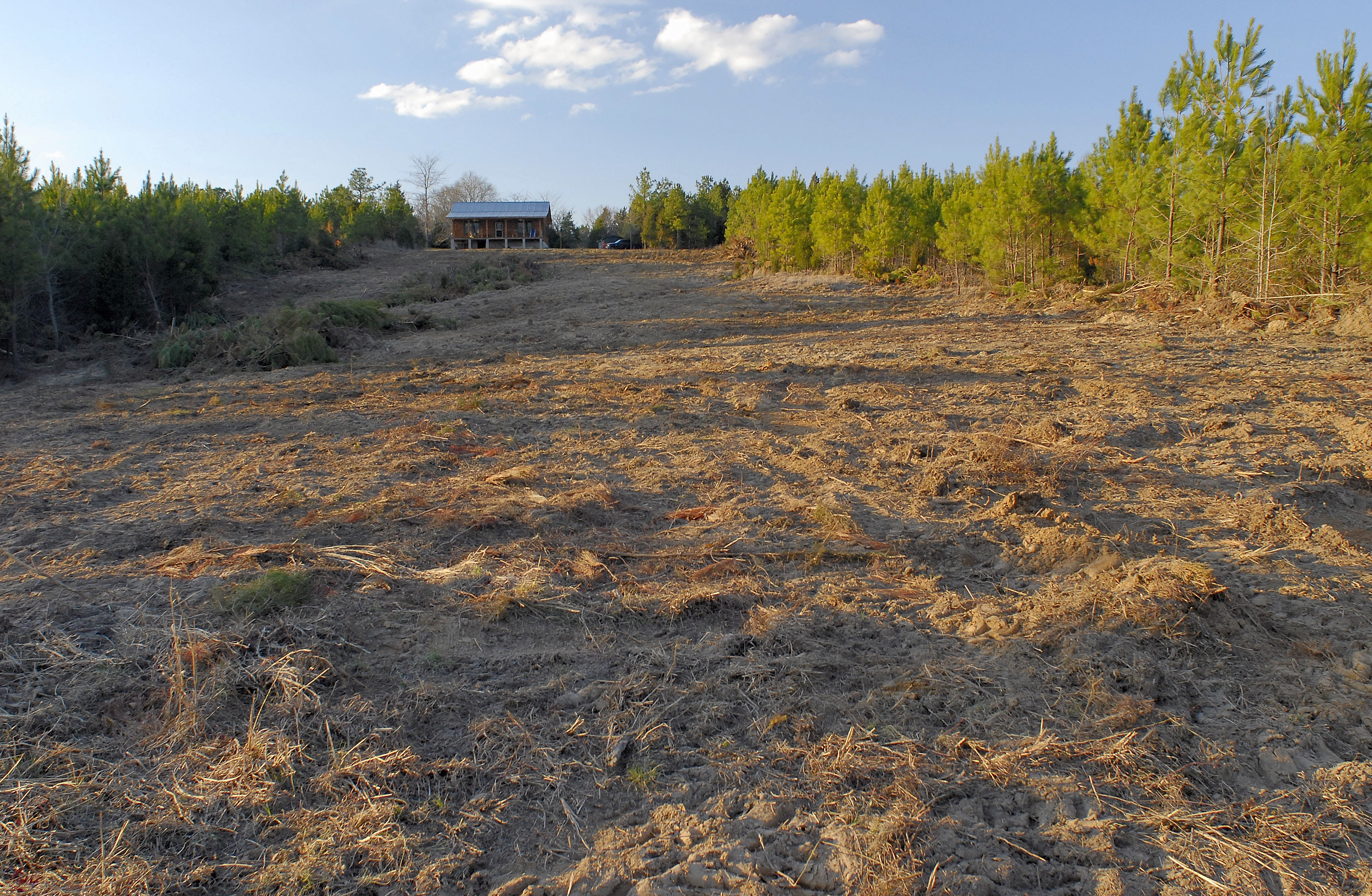

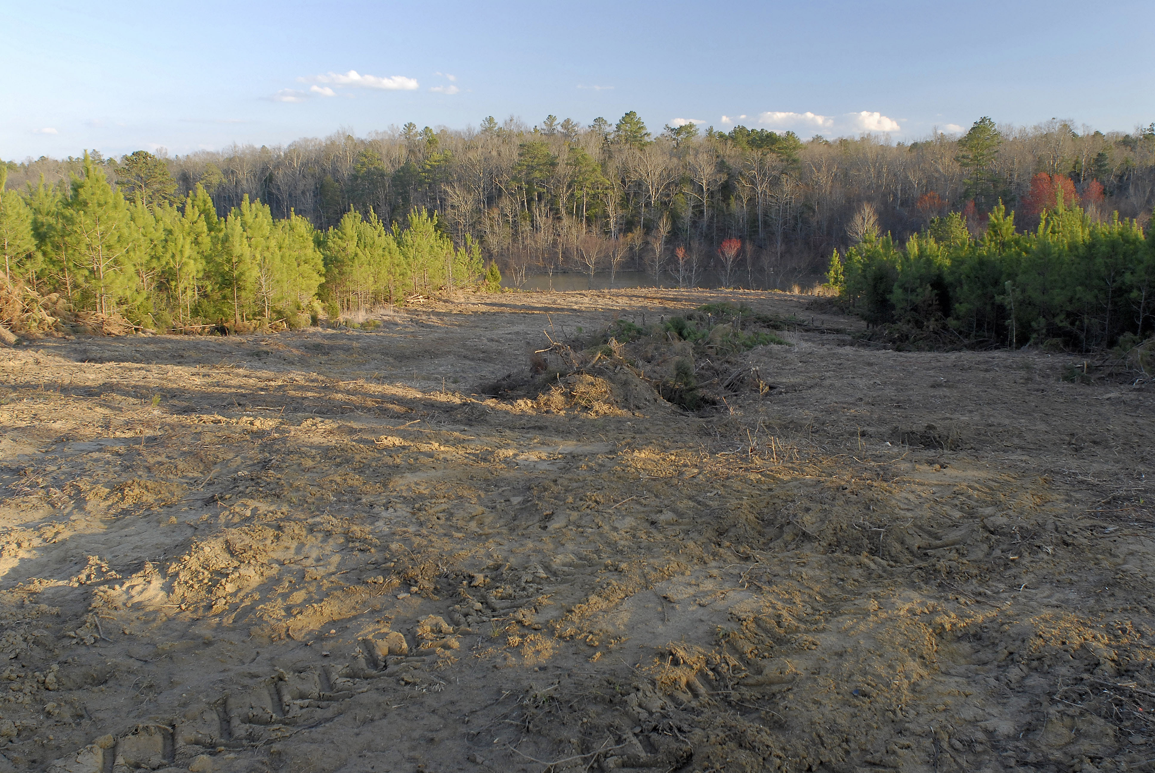

I found some pictures of part of the clearing job I did with just my FEL and a box blade. You can see what it looked like on either side of the cleared area. Most 4-6 inch trees at the base. A few 8-10.

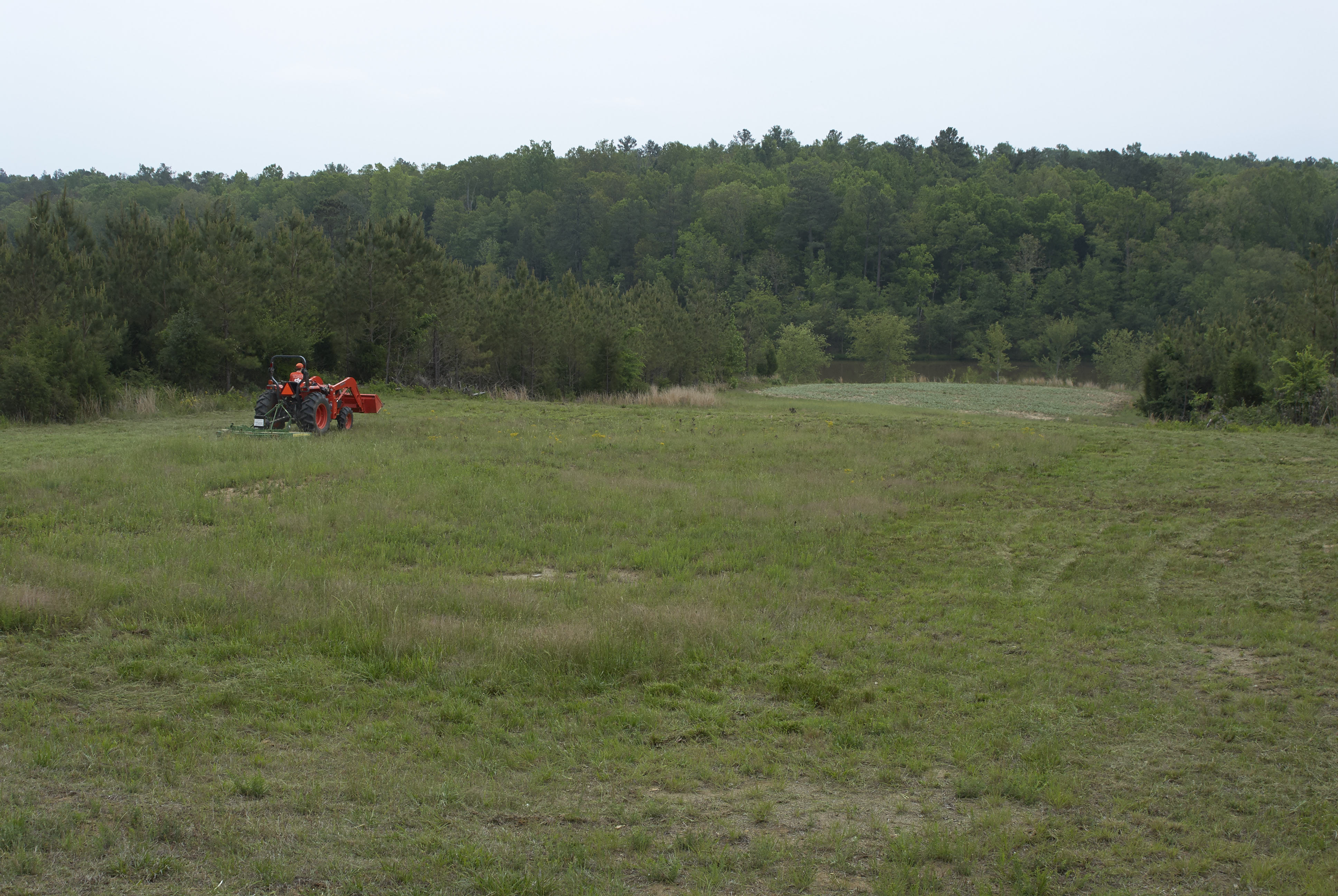

This is what it looked like a few years ago. Now the upper part just looks like lawn.

N80, that looks great. It's amazing what one can do with a little tractor like ours.
