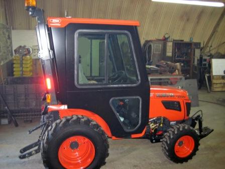

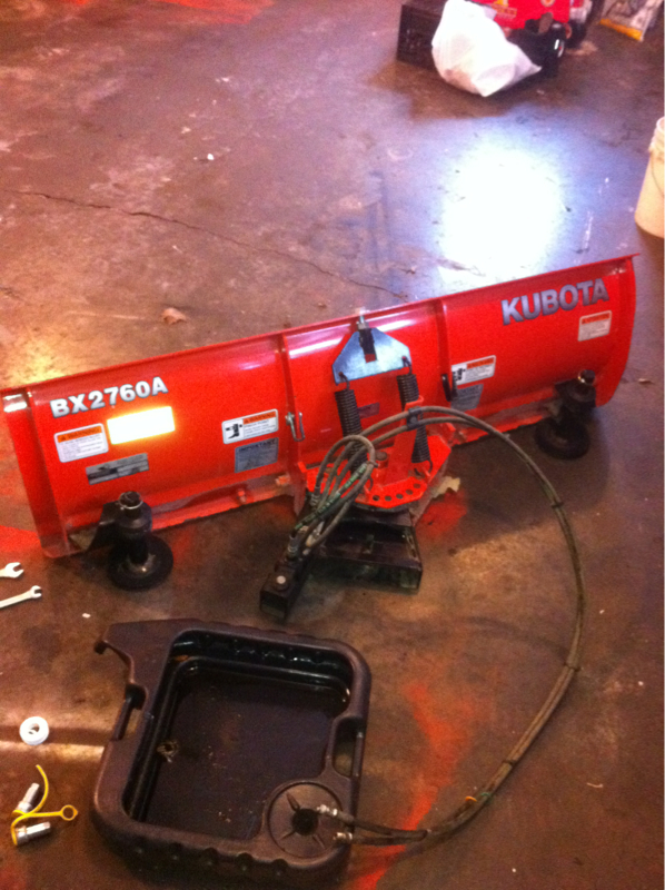

Cool blade, have any pics of it and how it is hooked up? Looks useful, i always seem to be levelling with the fel and a front blade would be much easier.
Here are a few
First one of the b2920 with SIMS cab and quick attach/front PTO hook up
Second of the rear of the bx2760 blade where the male end of the tractor's quick hitch fits in.
Locked in place with 1 lever and spring pin

Thanks. Pretty interesting setup. I love the cab!
