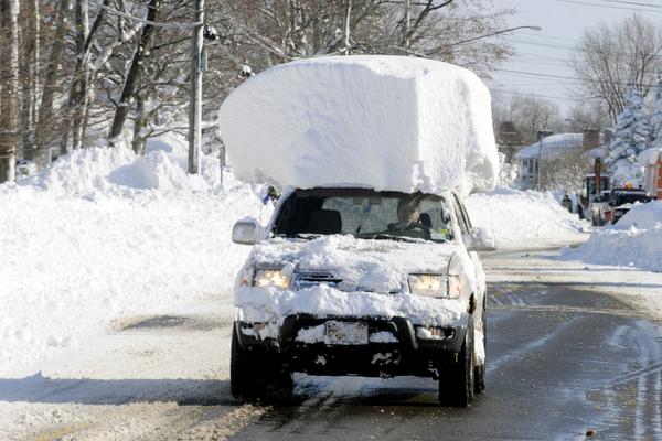

Would taking the extra 5 minutes to clean the car kill ya? :confused:
