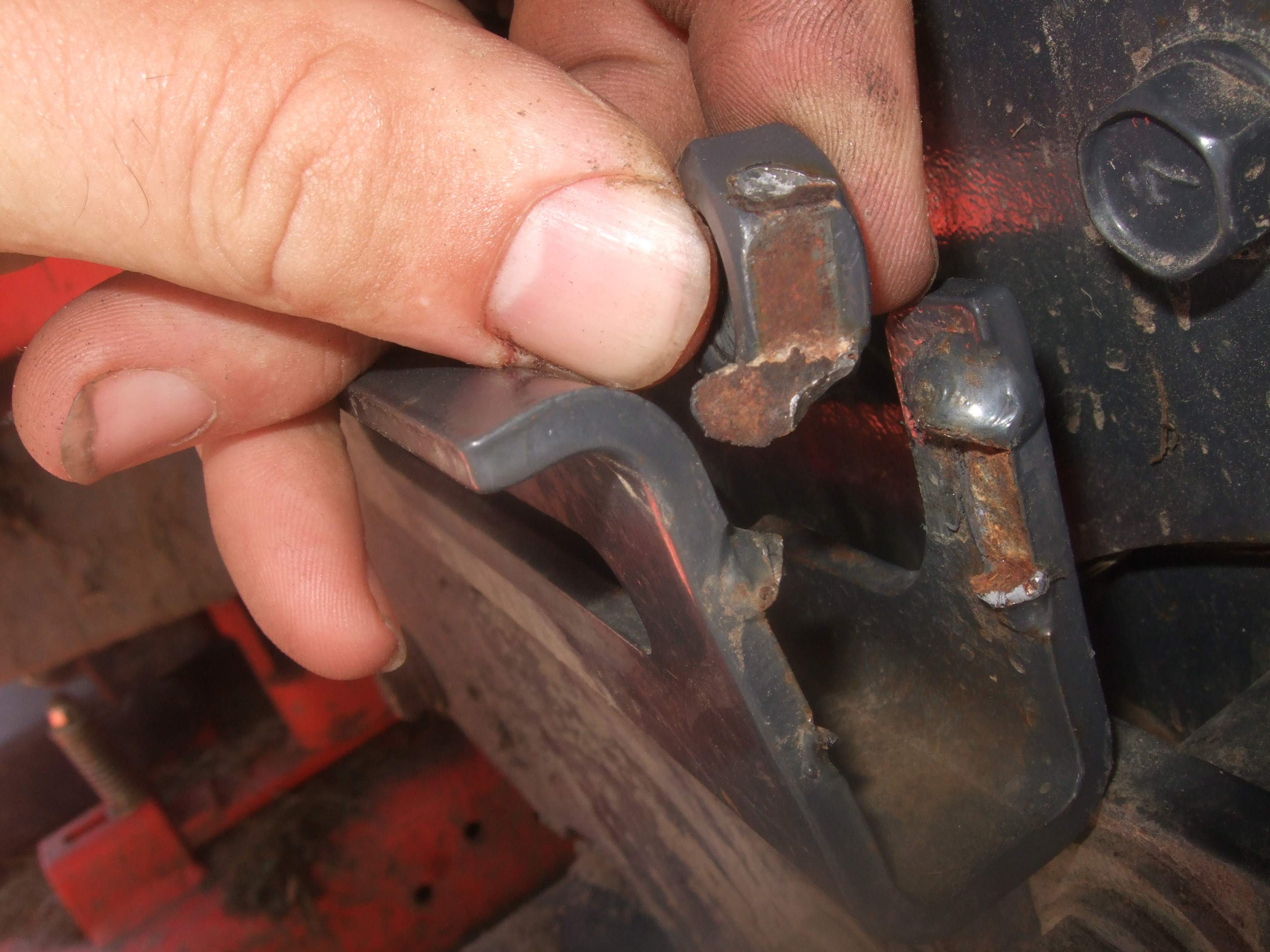

rust on welds.jpghieght knob doesnt turn counterclockwise. Always lift deck all the way first before moving knob. If you find you have to adjust again.. I think you have a broken nut on the adjustment bolt. My was broken off after few years of use.

View attachment 367684hieght knob doesnt turn counterclockwise. Always lift deck all the way first before moving knob. If you find you have to adjust again.. I think you have a broken nut on the adjustment bolt. My was broken off after few years of use.

It's the same bolt you adjusted before under the fender. There is sometimes some confusion about this. Ray's tractor is a bit earlier series, and the adjustment is different for those.
That's a good point about different tractor generations. To be honest, I had forgotten about that rod (the BX2230 has it on the driver's right side). When I read the OP's description, it sounded to me like the 2 lift arms that actually connect to the mower were possibly too short so that the mower hit the frame before it got high enough to turn the height control cam into the TOP position. However the other line of thought is just as valid (and from the sounds of it, more likely). The 3ph hits its top position before the mower linkage comes up high enough to all the cam to be turned to TOP. If adjusting the 2 lift arms care would need to be taken to maintain level. The pull rod under the fender is not going to mess up the level adjustment.
