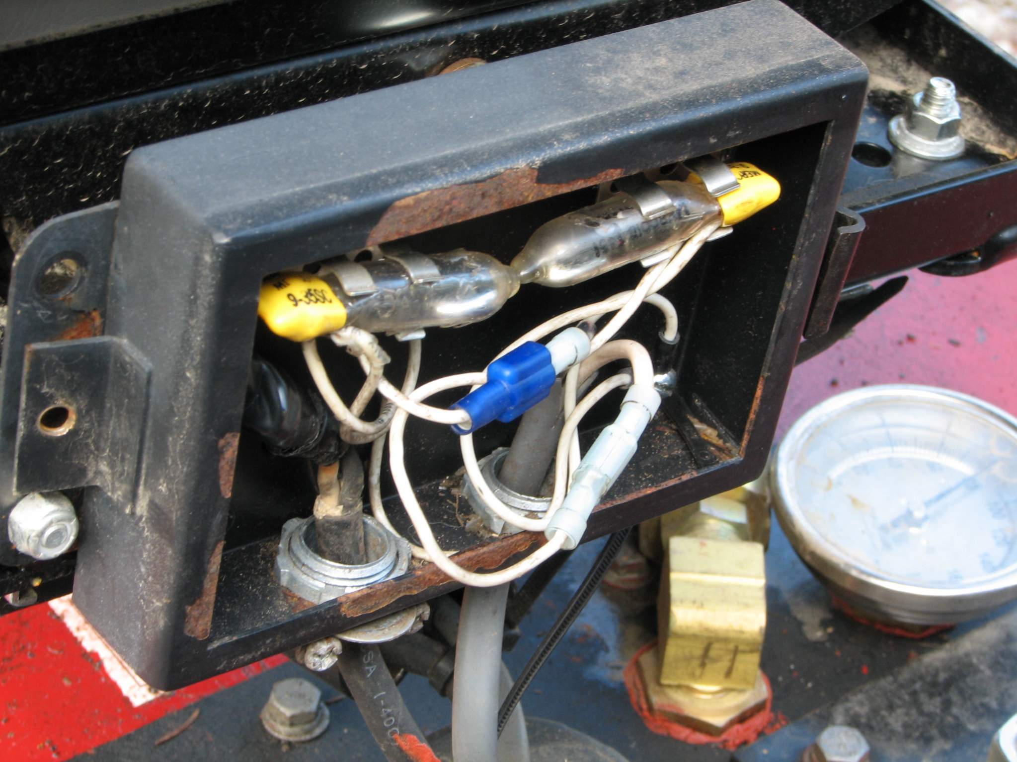

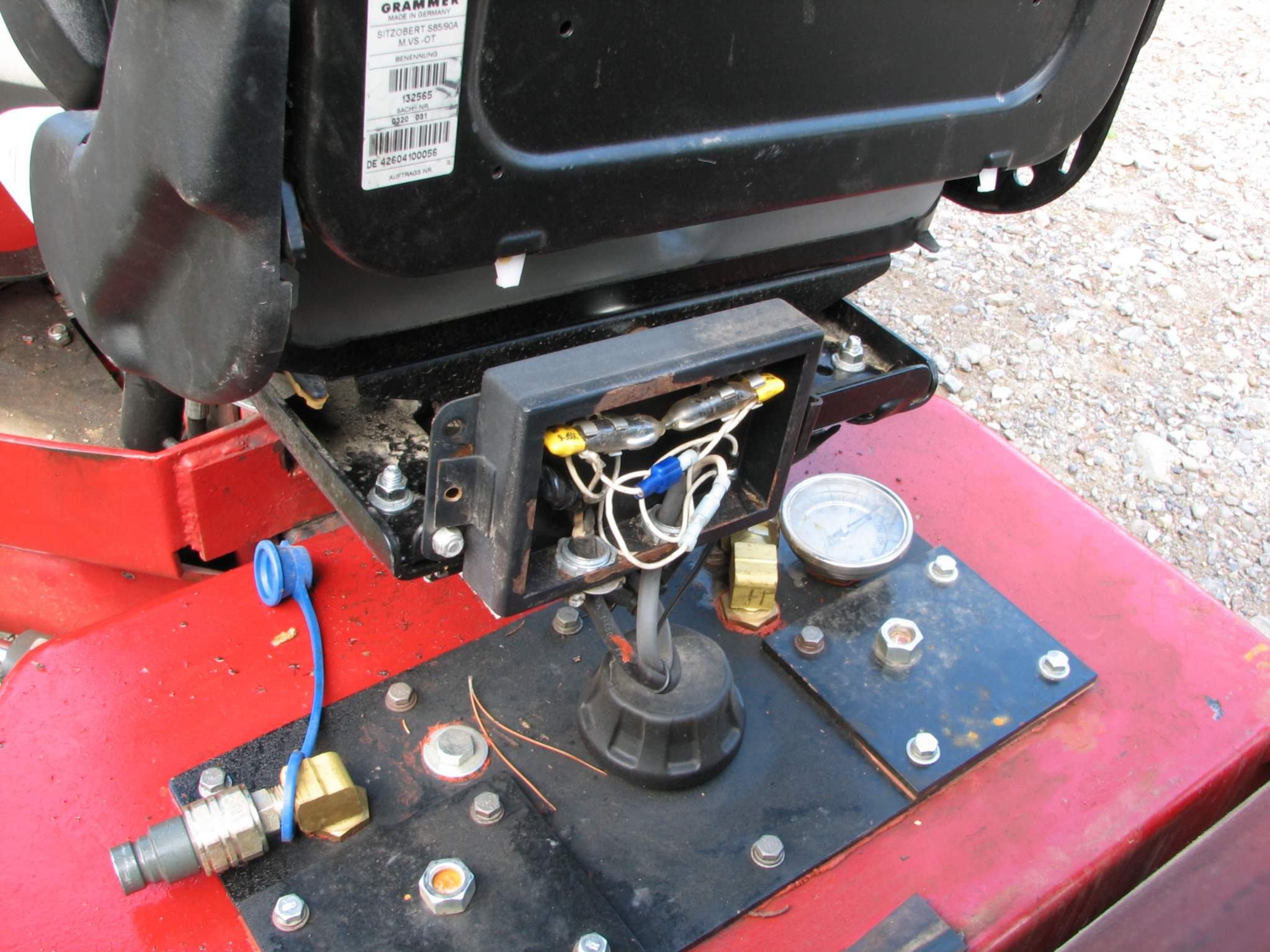

The mercury switches are angled and are basically limit switches. When tilted, they make or break contact which then control the hydraulic solenoids which control the supply of hydraulic fluid to the tilt cylinder.
I used to have problems with it suddenly tilting but it works pretty well now. I do not notice any jerking but then the whole tractor is also bouncing round. It is very nice to have on side slopes.

OK. So the switches are normally open. If the tractor tilts too far to one side, the mercury completes the switch on that side, activating a hydraulic solenoid that pushes or pulls the seat ram in the proper direction. Correct?
Is there and on and off switch for that tilting seat circuit to disable it when you want to? Oops, I see it was mentioned that there is a shutoff switch that was bypassed by the previous owner.
I also see mention of someone rebuilding their steering cylinders and then the seat worked better?
Hmmm.... as my PT425 is plumbed, hydraulic pump pressure to steering valve, power beyond port of steering valve to FEL valve, then back to tank. Is the red units with tilt seat plumbed the same way to provide pressure to the seat hydraulics after the steering valve?
As for an alternate seat circuit.... K.I.S.S. (keep it simple, stupid) comes to mind, and that's what the mercury switch circuit seems to be... very simple. It could get overly complicated to design a new circuit. And expensive.
I'm surprised no one has any complaints about bounce in the tilting seat on uneven terrain. It would seem the mercury would slosh around more, and without a delay in the switches, they would activate in a choppy fashion on rough terrain.
   / The downside of a tilting seat #16
I am not sure if Carl was referring to the kill switch in the seat being bypassed or the Tilt On/Off switch on the dash. My guess is that they work when bouncing around because both switches would be getting jostled and you do not notice minor adjustments. The solenoids/hydraulics add their own time delay to things. From my experience, if anything it is slow to respond.

Ken - Yeah, so the on off switch for the seat on the dash never worked. Digging into it I found it all bypassed, the seat hot whenever key is on. I have not minded this, but I do detest the slow and inacurate response of the circuit.
To all, it is a single cylinder with a dual acting hydraulic control valve. There appears some sort of adjustment nob at the top of the valve so as the manual is so thorough I am going to have to call Terry. There are two merc switches on the back of the seat in a control box. I have to take it apart but the issue is in the merc switch and the cable being pulled too tight when I turn and twist just the right way.
