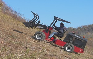

   / The downside of a tilting seat #30
Yup, I like the tilt seat as well. Here's a picture of a typical slope here at the farm -- a fixed seat would be a problem...
