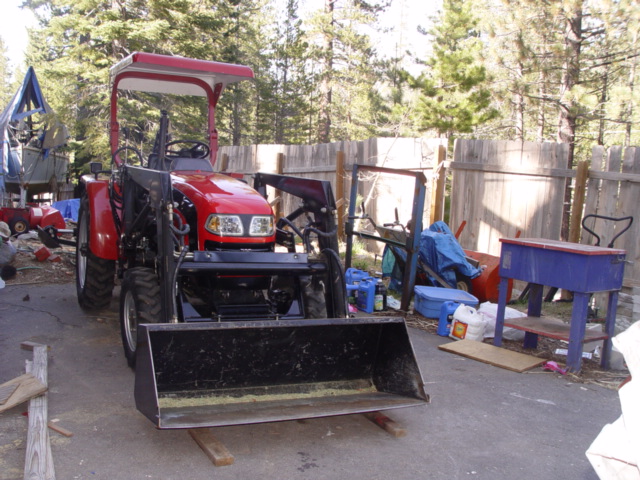

   / The Foton has Landed: FT254 in Sweden #39
SensibleNick, I would love to have the bonnet mod photos. The bonnet cannot be opened at all with the FEL down.
On this one the fuel tank can be filled with the bonnet down. Thanks Richard
Ohh.. we have interestingly different FEL setups..
I'll post the bonnet photos as soon as I get time: The parts catalogue has some rather descriptive pics too... I'll snap them while I'm at it. :thumbsup:
