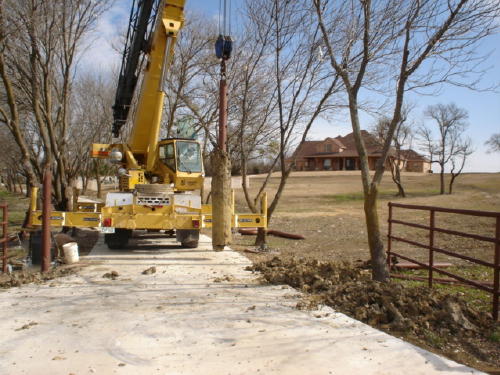

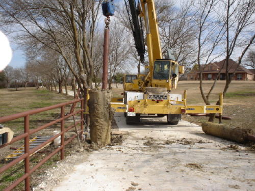

The first good thing was the crane showed up on time.

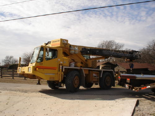

#232

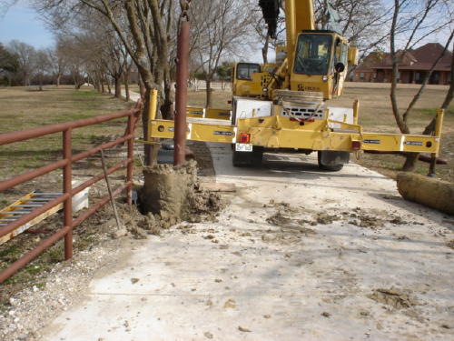

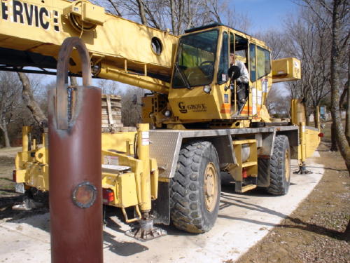

This is twenty two ton AT. It not only can lift. It can do it with flair. Four wheel steer, four wheel drive, it can be operated from either the crane cab or truck cab. It was just too kewel.
I welded on lifting eyes because I wanted to be sure and try to lift the posts straight up. Using a sling in this circumstance can put things in a bind during the lift.

#233

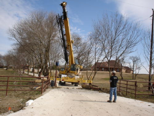

The crane didn't even grunt on the latch post. It came straight up easy.

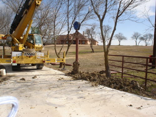

   / The gate
#234

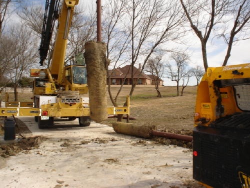

It was almost embarrassing. I thought I had put the post in a good footing.

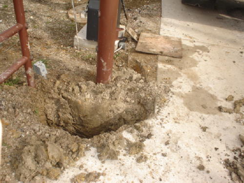

I need to mention a little fly in the ointment. There is power out and above the lift. So every move on the crane's part was very deliberate and precise.
We started with twenty eight thousand pounds of static pressure on the hinge post. This was after I'd dug out a semi-circle ten feet deep to allow us some shaking-loose-breaking-out-room.

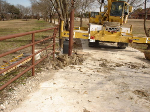

He shook, pushed, tugged, all the while pulling up.
It took awhile.
But then I noticed a little movement where it counted.

#240
According to the crane operator's equipment this puppy weighed a big dawg seven thousand pounds.
