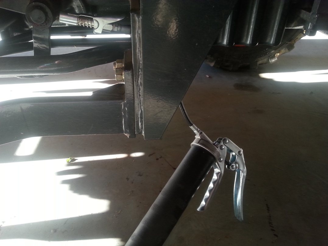

Were you able to get the pedal linkages fittings with the LnL?.. I tried a couple of times and could not seem to get it lined up.. So I built the right angle adapter to get those two. It works great.. Of course those are just every 50 hours.. so no big deal. The LnL works great for every other fitting on the tractor and loader.. Perhaps I just didn't try hard enough on the those pedal linkage fittings. I will re visit that if you tell me you had success. I have a pistol grip gun with a 18 inch whip hose.
Here is a photo of the most difficult fitting, James:
The loader mount blocks the fitting but the flexible hose and LnL make it fairly easy.

Aha, you came in the back door! I tried to come in the side. My adapter makes it quick though for those two. Why didn't they just put right angle zerks on in the first place?
Those are the only two on the whole tractor that are difficult.
