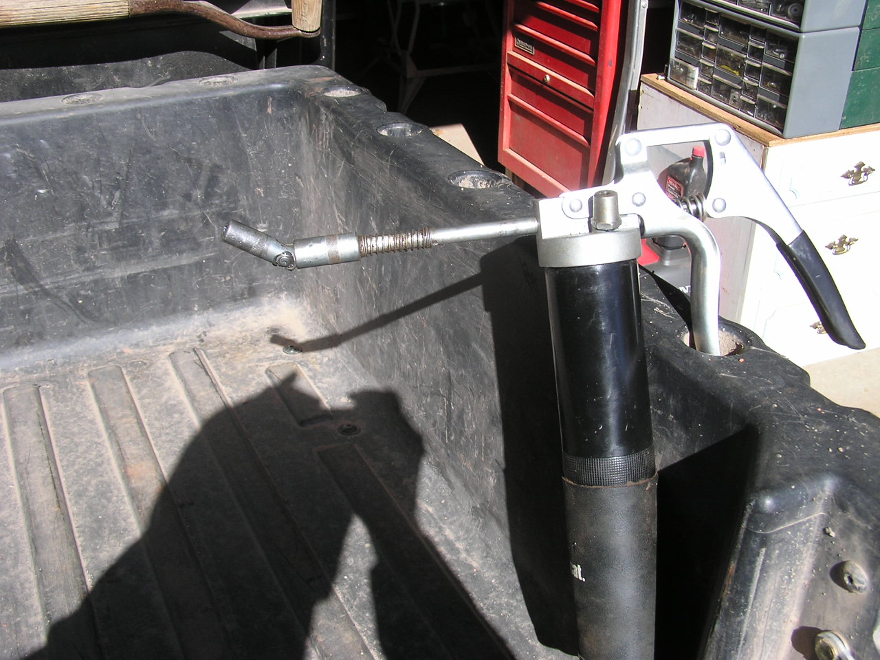

After several cases of grease using all three types, here's my opinion.
The standard coupler is the most versatile. For complete success it requires a pistol grip or powered gun. Some zerks it simply won't lock onto and hold without a hand. If using a lever gun it's very cumbersome. If using a pistol grip gun or powered gun it's definitely the most versatile and useable with the least hassles.
The LockNLube works well in open situations where the zerk is easily accessible. It generally stays locked on the zerk. It is very bulky and I found several zerks that I simply could not use it on. I'm not impressed with the mechanism involved and see it as short lifed. It leaks more than I think it should. I do not find it "clean" to use and always end up with grease on the device and thus on my hands, the grease gun and my clothes. I find it helpful with a zerk that is frozen and doesn't want to take grease. If using a lever gun it would be an improvement over a standard coupler. If using a pistol grip or powered gun it's less of an advantage, but still has it's place.
The Univer-Co coupler well in most situations. It's only drawback is on a zerk that is in a "well". It's possible to get it locked onto a zerk and not be able to reach the collar to release it. It generally stays locked on. The mechanism if very durable and I would expect a long useable life. It leaks some on worn zerks as all couplers do. It's "cleaner" to use than the LnL but not as clean to use as a standard coupler. It is very very effective on a frozen zerk and will almost always make them take grease. It too is an advantage if using a lever gun. On a pistol grip or powered gun it's less of an advantage, but I prefer it over the LnL. This is because of it's durable and simpler design.
I've owned the LnL for over a year. I've owned the Univer-Co for over six months. During Summer months I use over a case of grease a month.
The LnL and Univer-Co couplers have a space in a drawer of my tool box. The standard coupler is on all of my guns, powered or pistol grip. I have no use for a Lever Gun.

Your experience seems to be the opposite of mine.
My lock & lube has been much cleaner, with much less leakage than any standard coupler I have ever used.
   / The Great Grease Gun Coupler Showdown
#66
I replace my standard couplers as soon as they continue to leak after being properly adjusted. Standard couplers are bought tightened. Before installing on the gun I break them loose so I can adjust them by hand. Then as I use them I occasionally adjust them if they start to leak. But I'm sure you already know that.
I only have leaks on worn zerks such as on a ground engaging piece of equipment where the zerks wear.

Thanks for the update.
Since your LockNLube leaks, call them and request a seal kit I read somewhere that they are sending a extra seal kit now with new orders: LocknLube® grease gun coupler ends greasing frustration.
I removed the pipe and coupler from my lever gun and replaced them with a hose and LockNLube coupler.
It rarely leaks, but if it does I use a toothbrush on the zerk and check the LNL coupler for something that shouldn't be in it.
I use the lever gun the most, because it has the highest pressure and I can get a better feel for how much grease is going in. It also uses less grease than the Lincoln, because it doesn't over run when you release the trigger.
