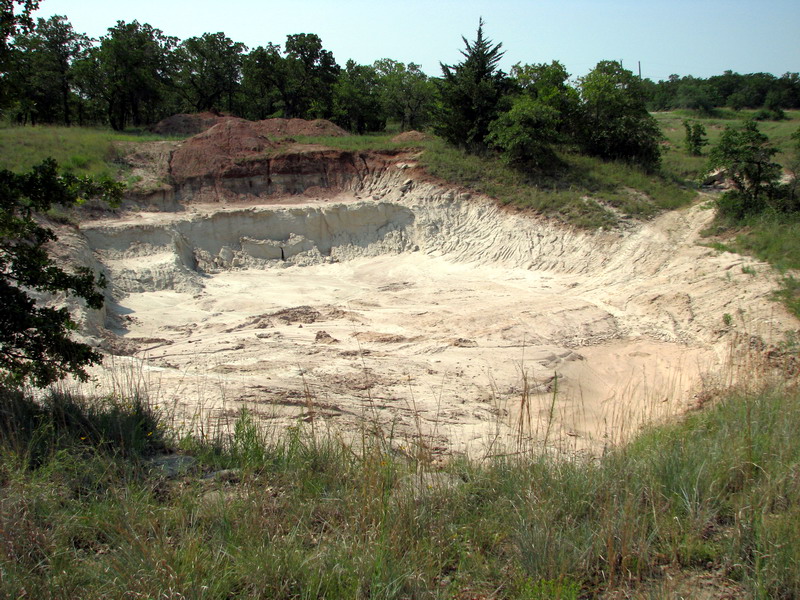

I apologize for not updating this thread for a long time. I've made a lot of progress, but mostly I've hauled load after load of spoils to level a gully and start building terraces. I've also set this project aside while I had some repairs done to my house and a room added. Now, I'm back to doing pond building in my spare time.:thumbsup:
When people are building large buildings, they have a topping-out ceremony when the last floor is built. Perhaps I should have a bottoming-out ceremony because I finally reached the finished depth on the pond.:D The three pictures below show the main basin for the lowest level pond. The final picture shows how water will flow through two culverts and down into the pond from the higher pond. Of course I still have some shaping to do here, and I will build a cascade of large rocks for the water as it falls down the bank. Controlling erosion in this area will be something I will rip-rap, rocks and even concrete as needed. The green area to the left is the location of the dam with the red line showing that I will have a driveway across the top of the dam.
The final picture is just a tiny sample of the rocks I've collected. The rock on top of the pile probably weighs over a ton because my New Holland TC45D could not even move it uphill when I got it into my rock bucket. I'm sure messing with that rock is what blew out my hydraulic pump's seals. The NH LB75B had no problem moving it at all. If I had used it first, I could have saved myself about a $250 repair job.:confused2:
