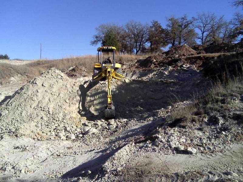

Thanks Cary. I've let this thread lapse a little while I've tried to make great progress on the knobby hill with the hard caliche. I have piles of clay and I have my low spot almost completely filled in. Before this weekend is gone, I hope to have some real progress that is easy to see in the photos.
As far as the drop from the road to the big lake on the back side of my property, I think the drop is 30 to 35 feet. The first 15-20 feet of drop occurs pretty rapidly as you move across my property away from the road, but slows down as the lake is approached. The level of my ponds near the lake is about 10' above the normal lake level. The highest pond I am working on now is about 12' below the road level and the deeper/larger pond is about 20' or the level of a two-story house below the road.
I've attached a picture of the caliche outcrop I'm working on now. The clay is in piles at the top of the hillside and the loose sand layer has been removed. The final 8' of digging is tough and breaks up in chunks up to 2'x2' sheets.

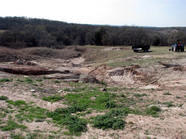

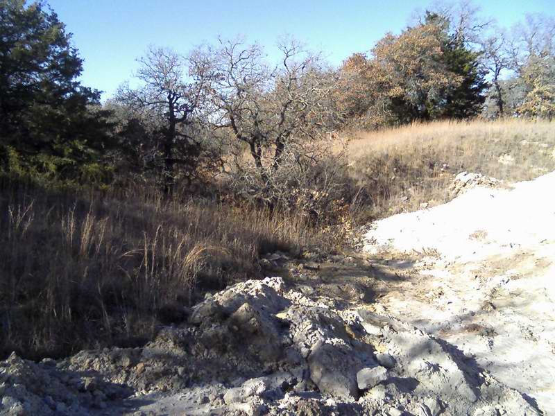

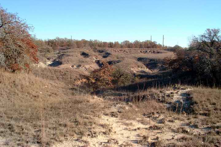

Cary, I haven't done much on dam construction because the dam for the smaller pond is right in the way of the path I travel to haul my spoils up to fill in the high gully. I can tell you that I've stockpiled a lot of clay and started digging a bit on my key trench for that dam. I plan to have a trench about 12' thick and extending below the level of the pond by 3' to 4'. It will rise to above the normal water level and then I'll fill in on the front and back sides so that it is about 40' wide at the bottom up to a flat top about 15' wide. Since I plan to have a gravel drive on top of this dam, it will be substantial and wide enough that people driving over it don't feel insecure. The dam for the larger pond will be even wider than that, but it will be in an existing gully and supported mostly by native soil. Considering that the gully is V-shaped, the higher pressure at the bottom will be in the narrowest part with a thick key trench approximately 16' thick and well below the base of the pond. Yesterday, I took the picture below that shows the only narrow gully I need to dam across for the pond. It really is a job just "begging" to be done because of the way Mother Nature has sculpted this land. I'll have to take out the trees as a final step before starting to build the dam in this area.
The second picture kind of relates to the question you asked yesterday about how my property slopes away from the county road. It's a ground level shot across the main area of erosion gullies toward the road where the poles are located. I will tackle this after building these current two ponds. This area will eventually become a large lake with water filled fingers where gullies are now. I'm thinking of calling it Fishy Fingers Lake.:D

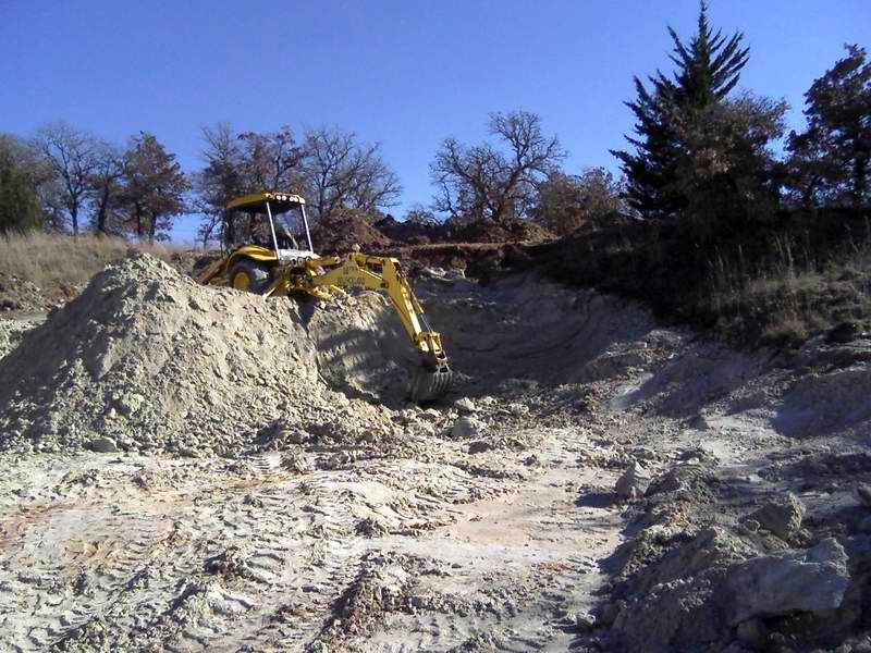

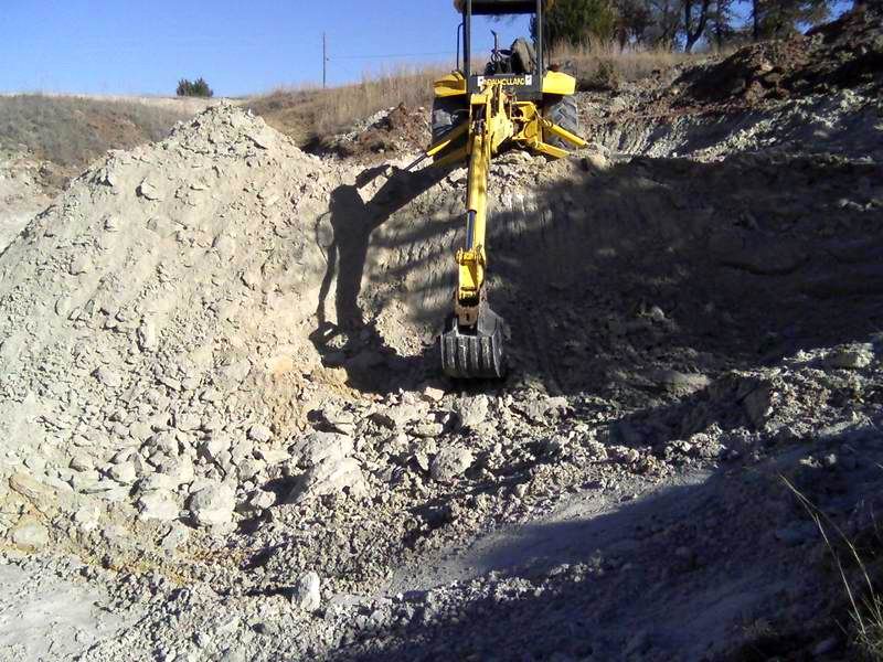

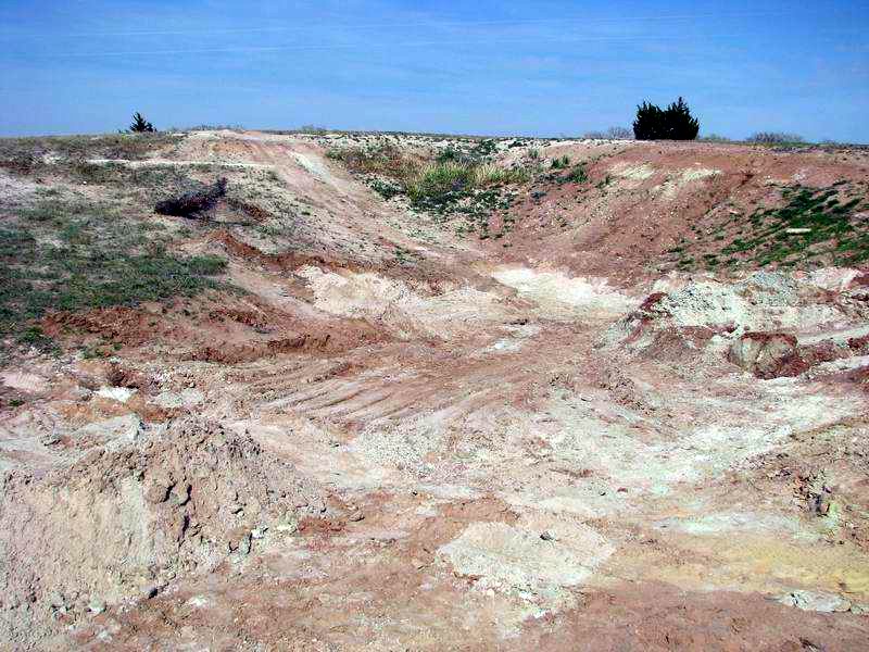

It seems I've been doing mostly everything except working on my excavation lately.:rolleyes: However, it is the Thanksgiving to Christmas holiday season, so I guess I'm allowed to take it slow if needed. I just wish it weren't so dry. A little more rain would sure make my work less dusty. Compared to last year, this Oct/Nov have been really dry. Last year, I had tiny bluebonnets up and growing by this time, but this year I have very few. It may be a bad year for wildflowers next spring if we don't get some rain to help them germinate and prepare for the spring eruption of color.
I did some work yesterday and here are a few pictures of digging in the caliche outcrop I have to mostly remove. I'm going to leave a bit of this level so I can put some steps down to it and may put a cover in for a shaded veranda above the pond to sit and fish. I probably have 75-100 more yards to remove. It seems the caliche doubles in size when I dig it out and it crumbles to sand.
The first three pictures are slightly different views of my excavation in the caliche. The closeup one shows just how the caliche breaks up into chunks as I dig. The fourth picture shows the whole area with my house in the background. Notice over the tractor canopy that you can see the area I've been filling in. It is really filling up nicely. I'm posting two final photos that show just how deep this area was when I started. Last year, I was taking out sand in this area and this year I'm filling it in.:rolleyes:
